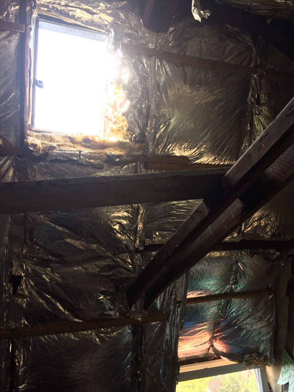

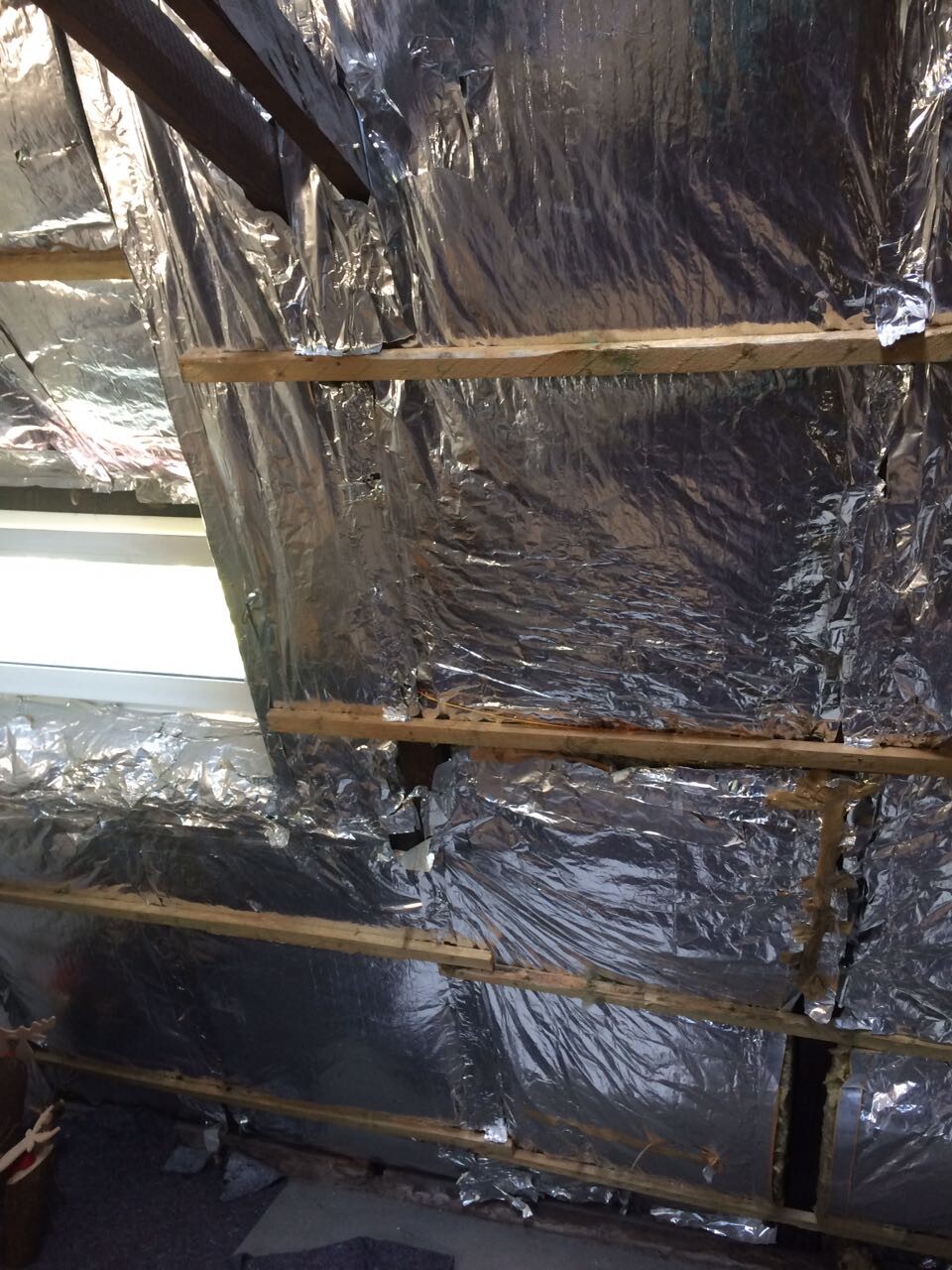

Hello, I am planning to convert our attic into a living space. It is insulated, as you can see in the photos. What should I do next? Is this insulation sufficient?

So, I believe that, in theory, the energy saving regulation requires a certain U-value for renovations. This is not met by this.
What exactly are you trying to achieve?
For a living space, I would personally use twice the thickness.
