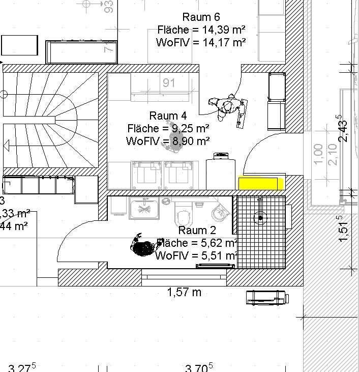

I am currently planning the multi-utility house entry in our utility room. I would like to install it in a space-saving and unobtrusive way. The furniture and doors are not finalized yet. However, the room will not be adjacent to any exterior wall. There will be a separate side door leading to the garage. Behind this door, I would like to place the multi-utility house entry. At the same time, I would hang the electrical panel above it.
Does anyone have a similar setup? Is this easily feasible? How much space should be left approximately?
We are building without a basement. Connections for electricity, water, telecom, and reserve.

For us, it was a requirement that NOTHING is placed below the electrical panel. I had planned a water connection and the washing machine there, but then the inspection would have been refused.
Placing it behind the door should not be a problem, but you should clarify whether the electrical panel can be above it!
blackm8831 Jul 2019 21:26
1.60 m (5 feet 3 inches) in front of the meter cabinet and nothing underneath. The service entry below the water distribution is acceptable. The main connection box for electricity and telecom also needs to be installed somewhere.

And the water meter also needs to fit. It all seems a bit too tight to me.
