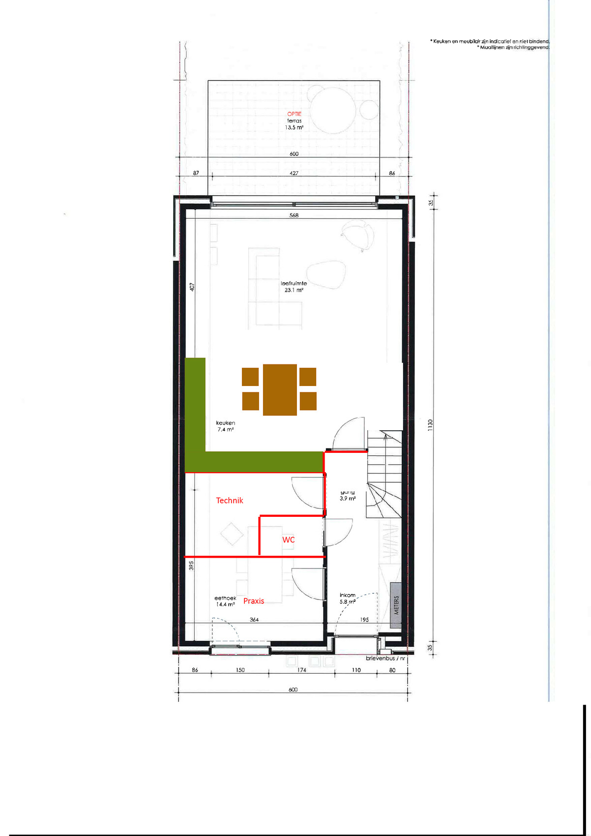

So if the utility room and restroom can be relocated, here is another suggestion:
Floor plan of a living/practice area with kitchen, dining area, utility room, restroom, and entrance.
...although I still don’t believe that. Redoing the entire piping and wiring plans – wow!
