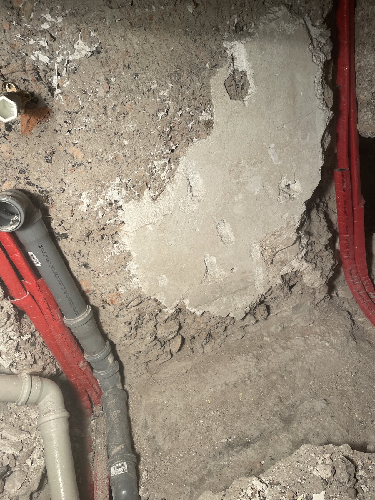

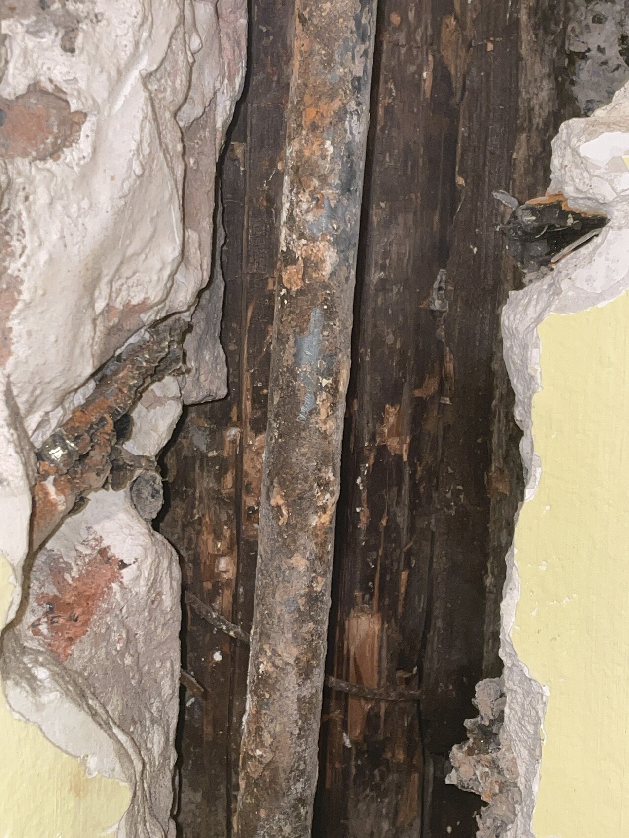

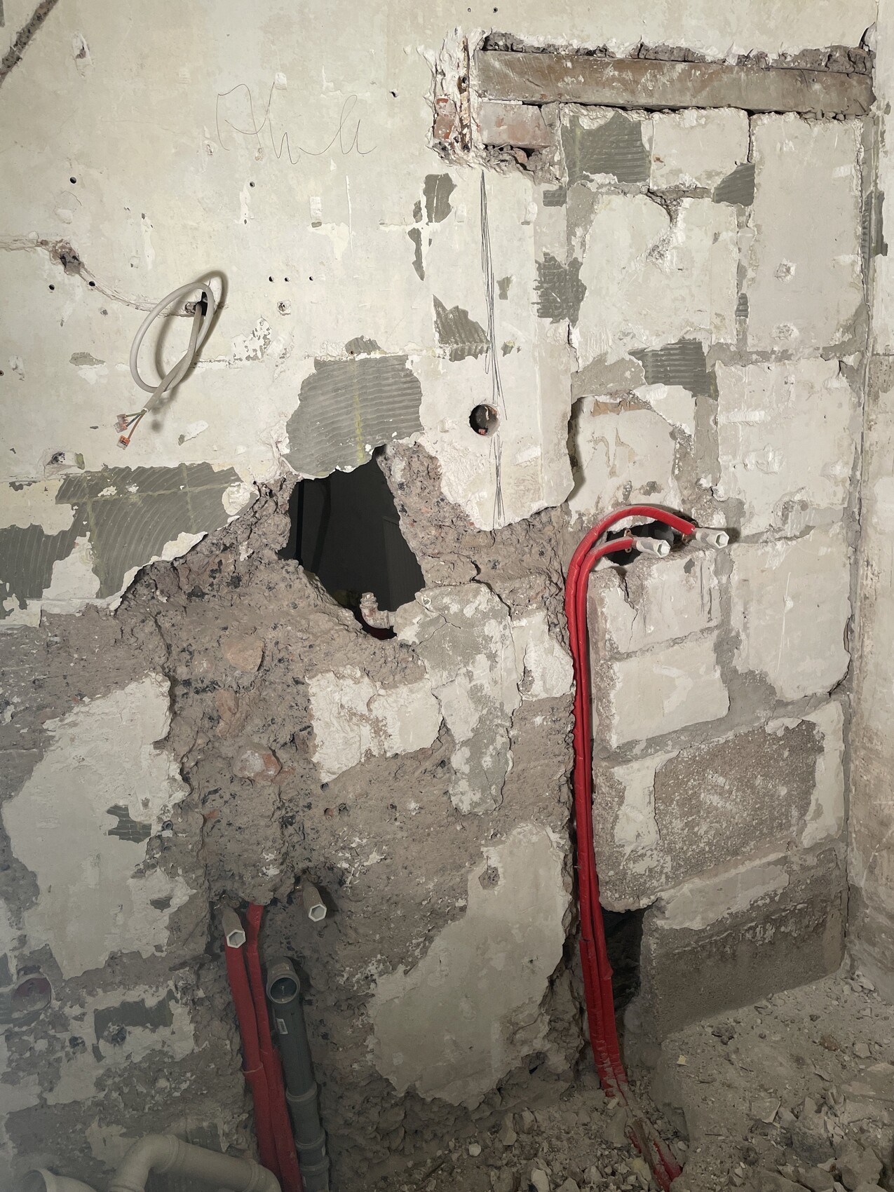

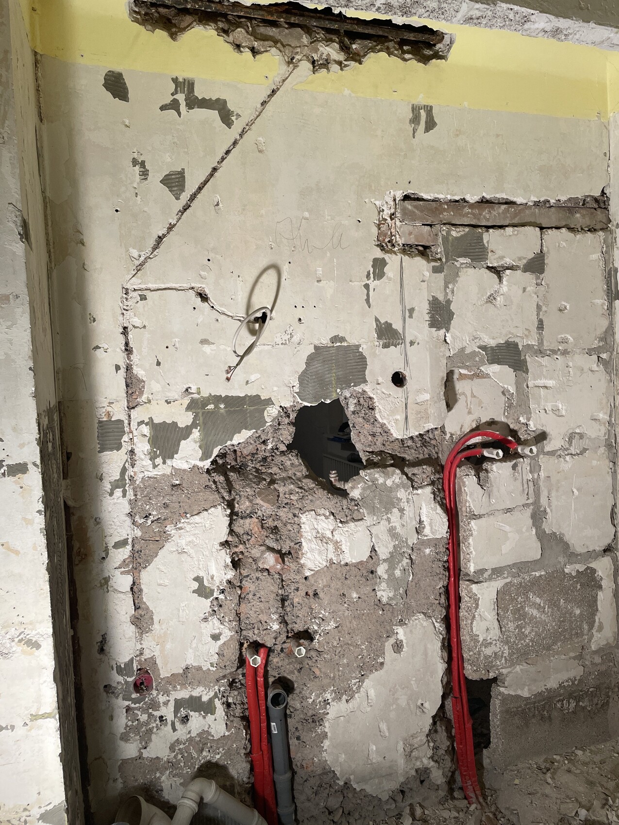

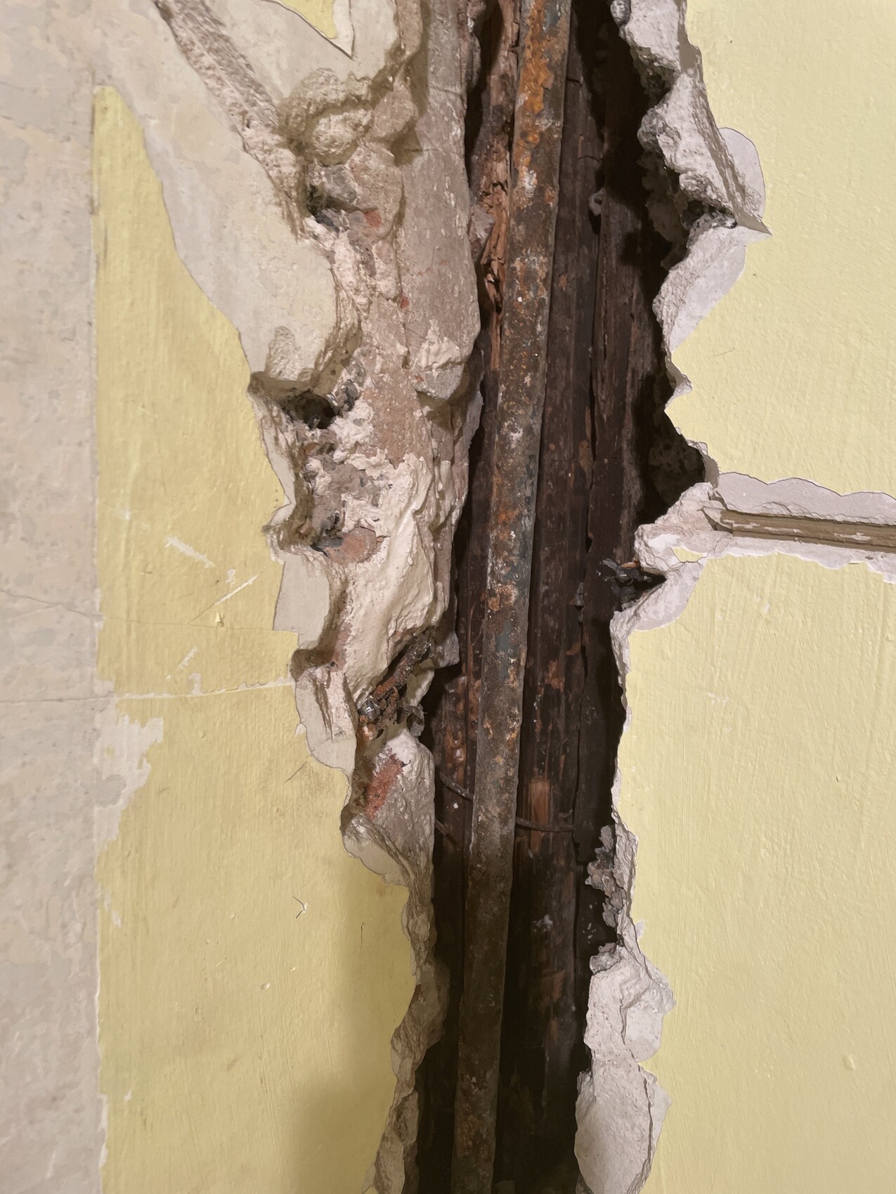

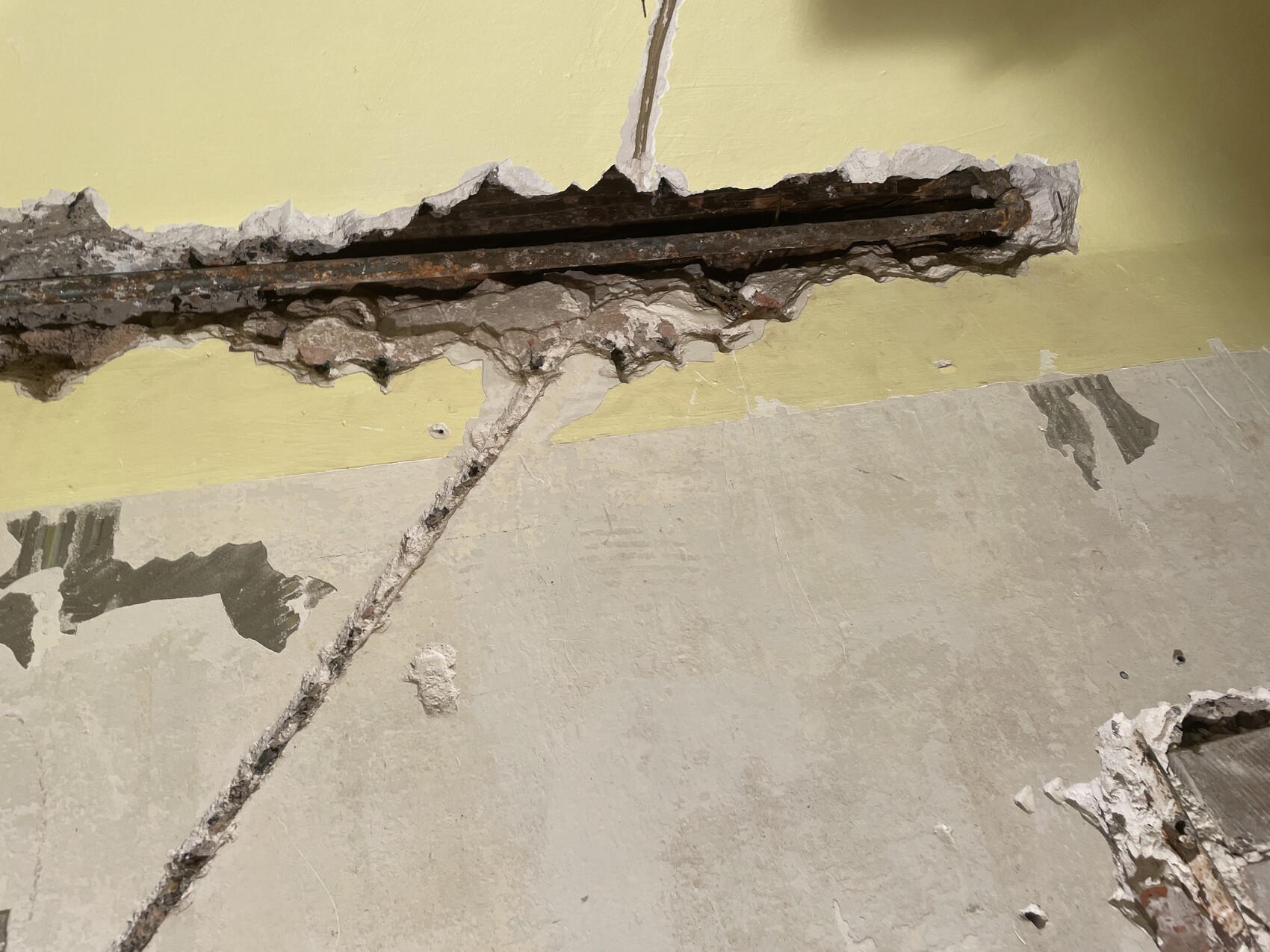

nordanney19 Feb 2024 09:58If the wall shown in the pictures were load-bearing, I wouldn’t enter the house today and would have legitimate concerns. It also looks only a few centimeters thick (a few inches).
And that’s all that can be said. No information on thickness, material, no plans (for the floor plus above and below), no structural engineering details, etc.
Buildings from the 1950s and 1960s often present surprises in the structural details of the shell construction. Materials were sometimes used very sparingly or improvised from other applications.
The wall appears to be at most a half-brick thickness (11.5cm (5 inches)). In houses from this period, such a wall can indeed be load-bearing. A key factor is also the construction of the ceiling above the ground floor and how the wall may serve as a support (reinforced concrete ceiling / timber beam ceiling / precast ceiling with varying orientation of joists, etc.).
These structural relationships can only be clarified on site by a structural engineer, who can then approve demolition or replacement if necessary. The original house plans and the structural calculations submitted with the building permit / planning permission are always helpful for this. If you do not have these, an inquiry at the archive of the relevant building authority will assist.
You should not make any decisions on your own without this preliminary examination by the structural engineer.

The house was built in the 1950s/60s.The 1950s alone cover several building periods and extend up to around 1963. If this is the same house as in https://www.hausbau-forum.de/threads/sandstein-keller-flecken-auf-boden.45708/, it would actually be older. After World War II, no archives in Germany were bombed (with the exception of a significant loss in Cologne). The photos without scale and without knowledge of the exact location in the floor plan are practically worthless. Please provide floor plans and at least one cross-section. Who is pounding on that wall so aggressively (and were the pipes replaced with hoses before or after that)?Alexannahaus schrieb:
