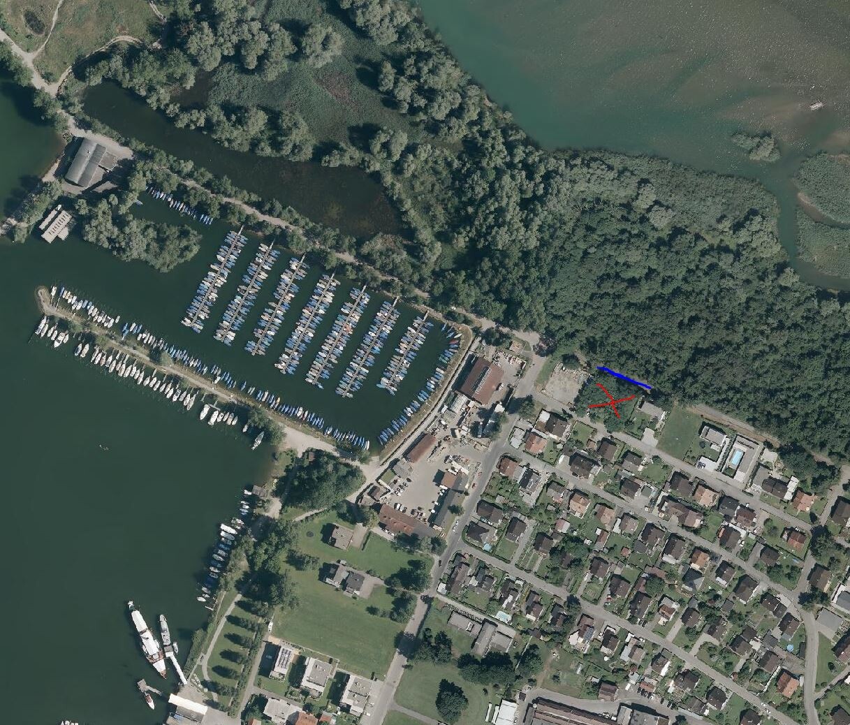

I think I didn’t describe the geographic location clearly enough in the initial post.
To the north of the plot, there is an embankment, and behind it a nature reserve. This area is wooded, and I probably won’t have a view over the trees even from the third floor.
To the west, there is an empty lot followed by a one-and-a-half-story building. Beyond that is the lake and the harbor.
Attached is the image. The plot is marked with a red X, and the embankment is marked in blue.
I somehow don’t understand the issue with the embankment? If it is located north of the property and does not block the view to the west, its height shouldn’t really matter, right? Besides, I wouldn’t orient living spaces mostly to the north because light and warmth are more important to me than a view of the forest...
You won’t be able to avoid seeing the trees in the northeast, and besides, you never get any sun there. Why don’t you build a house similar to the one the neighbor two houses to the right of you has, with a nice terrace on the third floor? Or at least a balcony on the first floor facing west?
