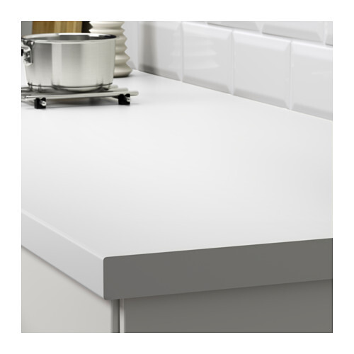

I have changed my mind and decided against the Linnmon tabletop.
Instead, I will go with something sturdier, which is actually 30 euros cheaper in price because the shipping costs are only 6.99 euros (about $7.50), instead of 29 euros (about $32).
I think this is a good choice!
SÄLJAN
Countertop, white
And it should certainly be able to support the Power Manager as well?
SÄLJAN
Countertop, white

IKEA-Freund30 Jun 2016 20:29A 2-meter (6.6 feet) particle board will sag if you don’t take any measures against it, even with a thickness of 38 mm (1.5 inches). At the very least, you should provide a support at the wall at the appropriate height. However, such a particle board is definitely heavier.

IKEA-Experte30 Jun 2016 21:24Yes, that should be fine. I believe the €6.90 shipping cost is a system error. "The delivery cost for parcel shipping is €6.90 per package (weight up to 30 kg (66 lbs), size up to 168×60 cm (66×24 inches))." This will surely be corrected soon.
