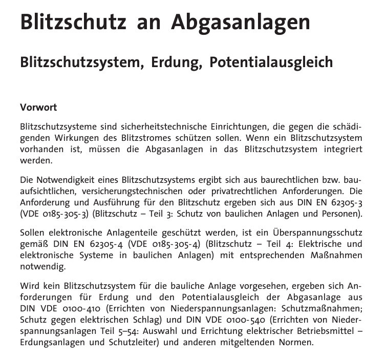

For our custom-designed single-family house, soon to be built using timber frame construction and without a planned lightning protection system, the question has arisen whether an external stainless steel chimney needs to be grounded.
The specialist company installing the chimney said they have not done this anywhere for many years, while the electrician and the foundation contractor have a different opinion.
Since the chimney outlet is the highest point of the building, the likelihood of a lightning strike there is the greatest. Could it therefore make sense to ground it, even if the house does not have any other lightning protection system?

nordanney22 Nov 2024 13:32To my knowledge, the chimney must be included in the equipotential bonding according to VDE standards. However, I can't tell you exactly where this is specified. I had this discussion a few years ago with a chimney expert and an electrician, and they showed me the relevant sections.
nordanney22 Nov 2024 13:39Similar topics
