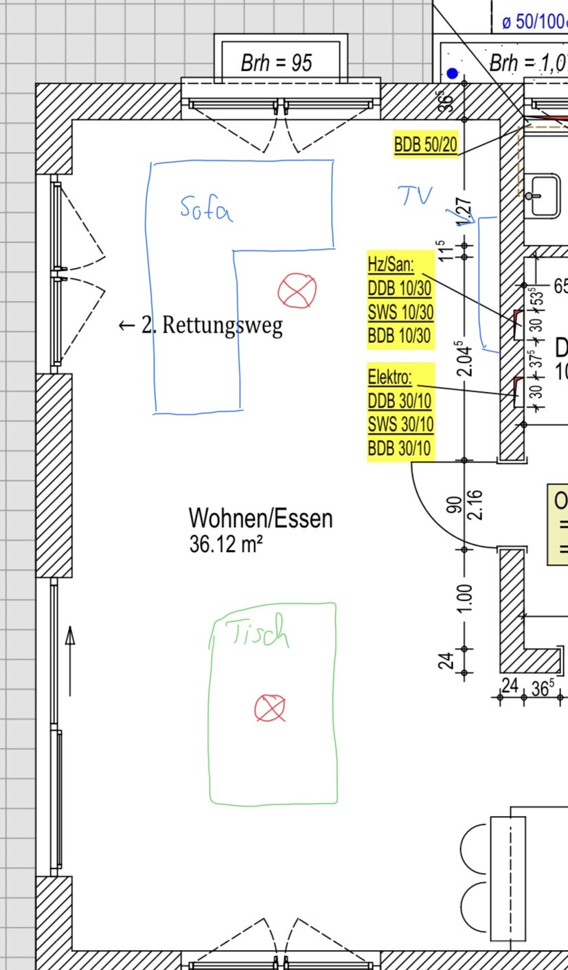

My wife and I are currently planning the construction of a single-family house. We have just completed the electrical planning together with the electrician. At the moment, there is only one ceiling light fixture planned in the living room. We might place a floor lamp in a corner as well. We would like to have the option to dim the lighting a bit when watching TV, so it is not too bright or glaring. However, since the LED recessed spotlights in the concrete ceiling are very expensive with our builder, we are looking for alternatives.
Do you have any tips or suggestions for additional lighting options besides the ceiling fixture?
Michael
Grundriss eines Wohn-/Essraums (36,12 m²) mit Sofa links, grünem Esstisch und Rettungsweg.

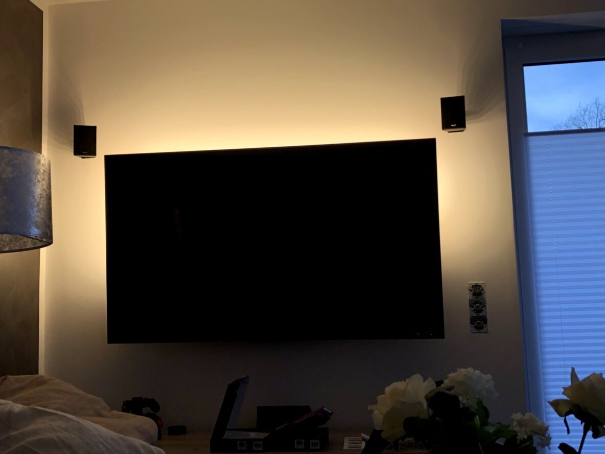

danixf
14 May 2020 21:23
A dimmable fireplace is definitely recommended.
Stick an LED strip to the TV. This provides nice indirect lighting.
Wall sconces would also be an option.
Großer schwarzer Fernseher an der Wand, Lautsprecher links und rechts, Fenster rechts, Blumen im Vordergrund.
Tarnari14 May 2020 21:25
I would choose a wall light with warm white light behind the sofa in the corner between the windows, along with indirect lighting on the TV wall. As shown in the drawing, it feels too dark to me with unpleasant shadows.

mime270
14 May 2020 21:45
Tarnari schrieb:
I would choose a wall light with warm white light behind the sofa in the corner between the windows, and indirect lighting on the TV wall as well. The way it is shown in the drawing feels very dark to me, with unpleasant shadows.
The idea of the wall light sounds good. What kind of indirect lighting would you choose for the TV area?

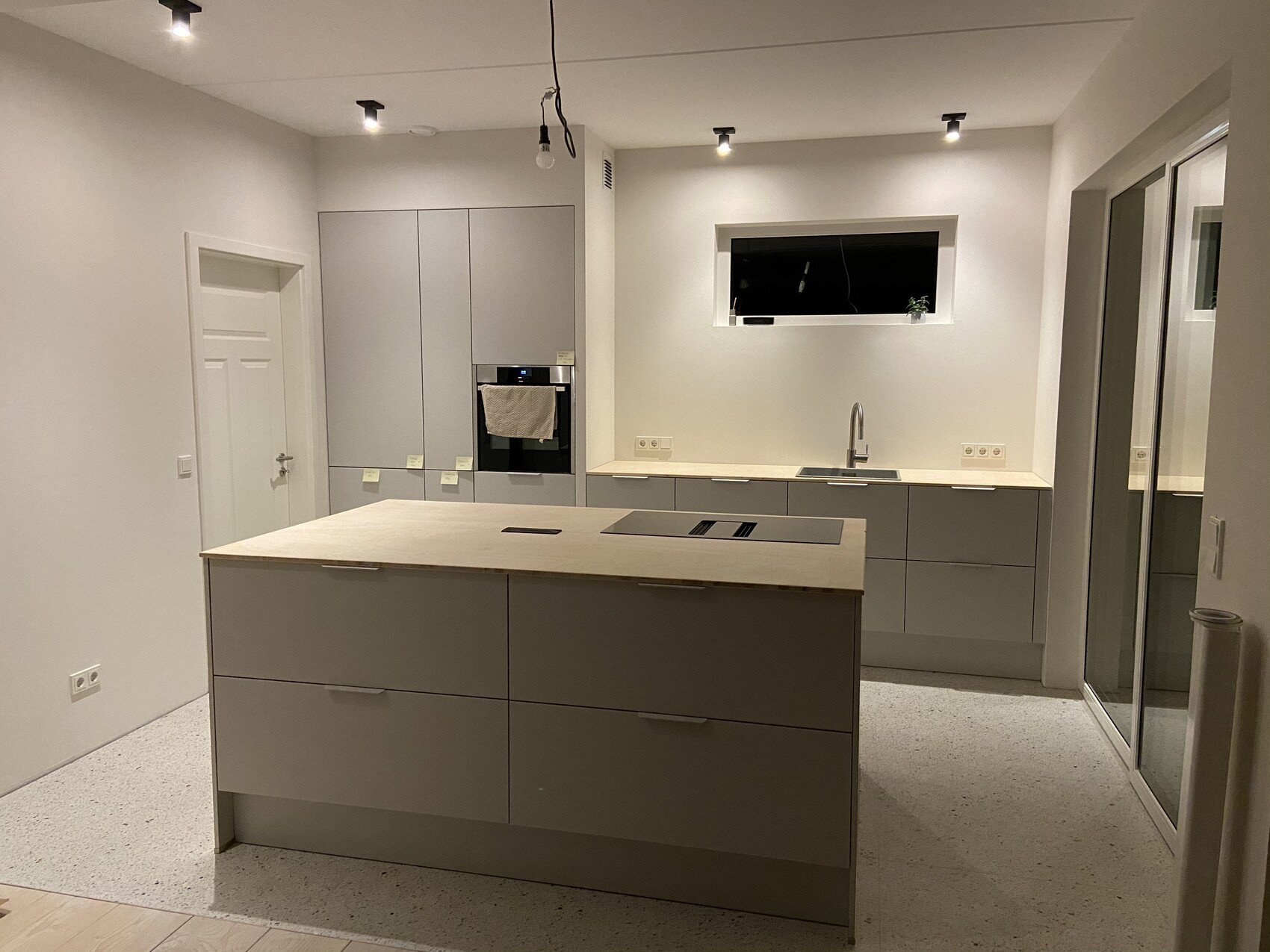

spochtsfreund
15 May 2020 08:14
I would (even after the fact) have ceiling junction boxes installed instead of recessed spotlights. Then you can use surface-mounted spotlights, which, for example, can be dimmable. We installed these on our existing spotlight holes because we found regular recessed spotlights inconvenient after the fact.
Moderne Küche mit grauen Fronten, großzügiger Insel, Spüle und eingebautem Ofen
