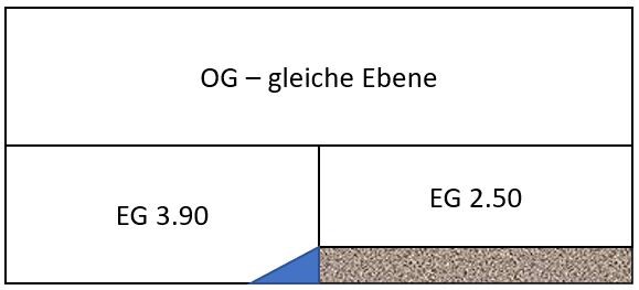

Since we have a slope plot and our house is built along the slope, the rear part of the house slopes downward. At the top, we don’t follow the step down—this results in a higher ceiling height in the living/kitchen area on the ground floor at the back.
Coming from the main entrance, you can look all the way down over the small staircase (1.40m (4 ft 7 in)). Does anyone know how I can set this up in DiaLux? We want to illuminate the staircase, and the open hallway passes by the coffee bar on the way to the dining room—where we plan to create different lighting scenes.

Does anyone here know how I can implement this in DiaLux?Where exactly do you see a problem?N
NordischJung5 Sep 2021 17:17Issue resolved. User error – was able to fix it using the cutting tool.
