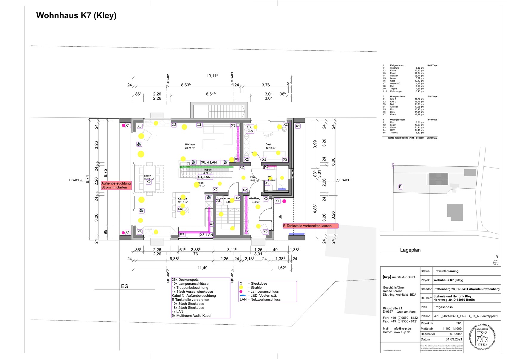

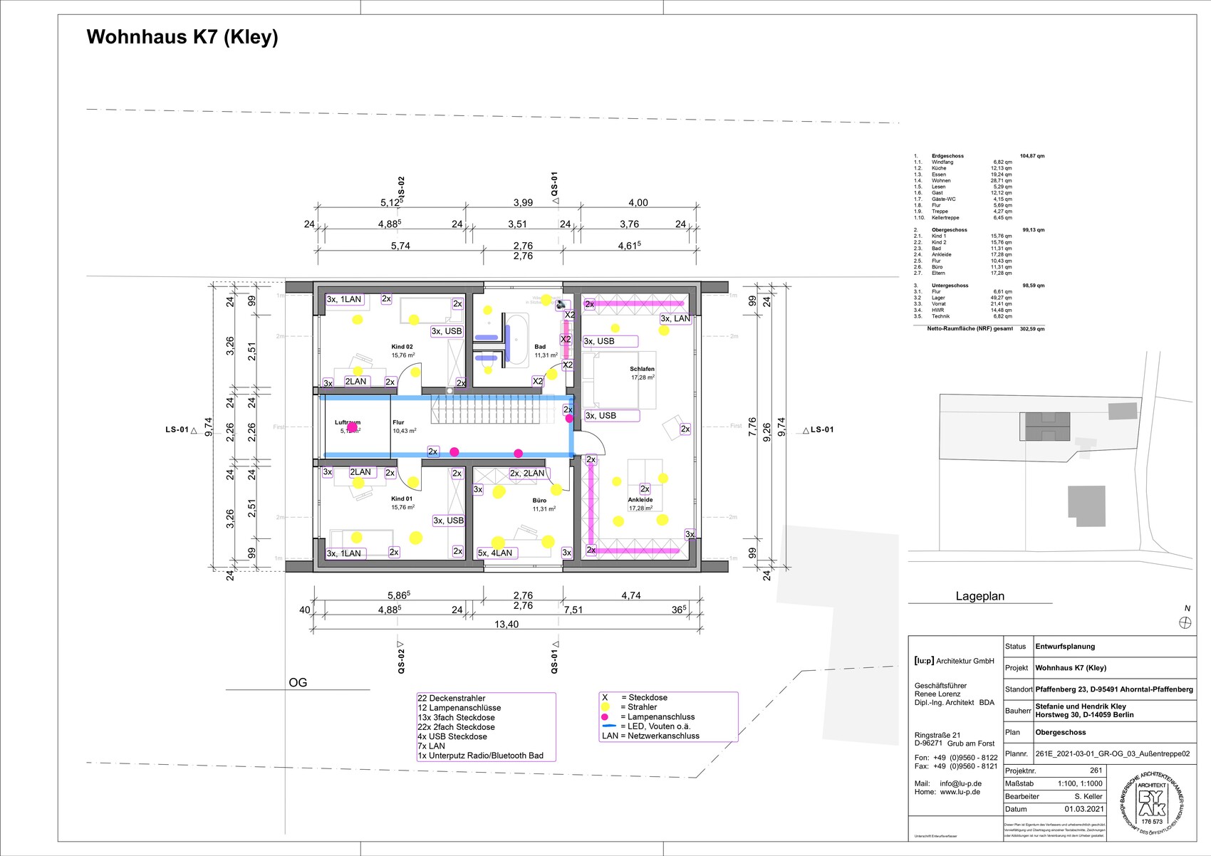

Dear forum,
we are currently planning the construction of our single-family house. Last week, I created an initial draft for the lighting and electrical installation, which I would like to share here for discussion.
Do you think I should reduce the number of recessed ceiling lights? Are the power outlets sufficient? I look forward to your comments!
Floor plan ground floor: residential house K7 (Kley) with living, dining area, and kitchen.
Floor plan upper floor of a residential house K7 (Kley) with rooms, hallway, bathroom, and technical symbols.
