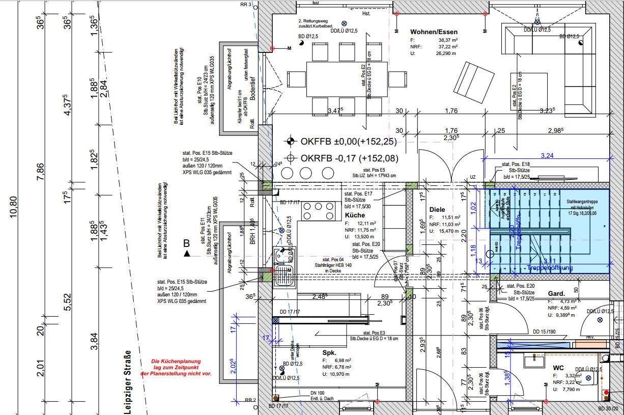

BauNoobie26 Jul 2020 15:29Dear community,
I would appreciate your valued help and ideas for a fall protection solution for my light wells (ground floor plan attached). The light wells are very wide (2.5 m (8 ft 2 in) and 4.2 m (13 ft 9 in)) and approximately one meter (3 ft 3 in) deep each. Fall protection is necessary because the drop into the light well is 1.2 m (4 ft) deep.

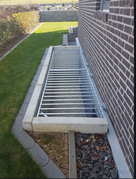

How much space do you have in front of the light wells? If it only goes down 1.20 meters (4 feet), then extend it outward and add a step with a second row of L-shaped concrete blocks, so you only go down 2 times 0.6 meters (2 times 2 feet). Then you won’t need anything else. The light well is already fixed, and unfortunately, I couldn’t create any steps in front since I wouldn’t be able to get around the house anymore (the plot is relatively small). I only found the following picture, which I like.
Can anyone tell me what would be needed for this and whether it is child-safe?

The version shown in the picture probably isn’t really child-safe, since it’s still easy to slip your foot through. Another option could be a welded wire mesh panel that can then be adjusted accordingly!?
Well, whether it looks good in the picture? You will simply have to go to a metalworker. If I were you, I would do that anyway and ask what other ideas they might have. It will have to be custom-made anyway.
