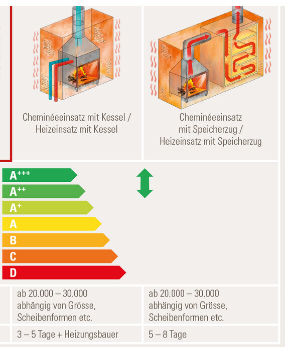

Do the built-in refractory bricks last longer than the stated lifespan (I have read about 15 years), meaning, do the built-in bricks last longer than those in the firebox? Previous tenants rarely lit the fireplace, only during cold snaps. However, the depreciation value is considered, and tenants do not have to pay compensation for wear since the house is 20 years old. I installed the fireplace for cold snaps during transitional seasons and for special days in winter, not for daily use instead of the underfloor heating. There are more refractory bricks installed than shown in the attached sketch. Because the luxury of 12 hours of heat output is so appealing, the fireplace is being used for unintended purposes.
