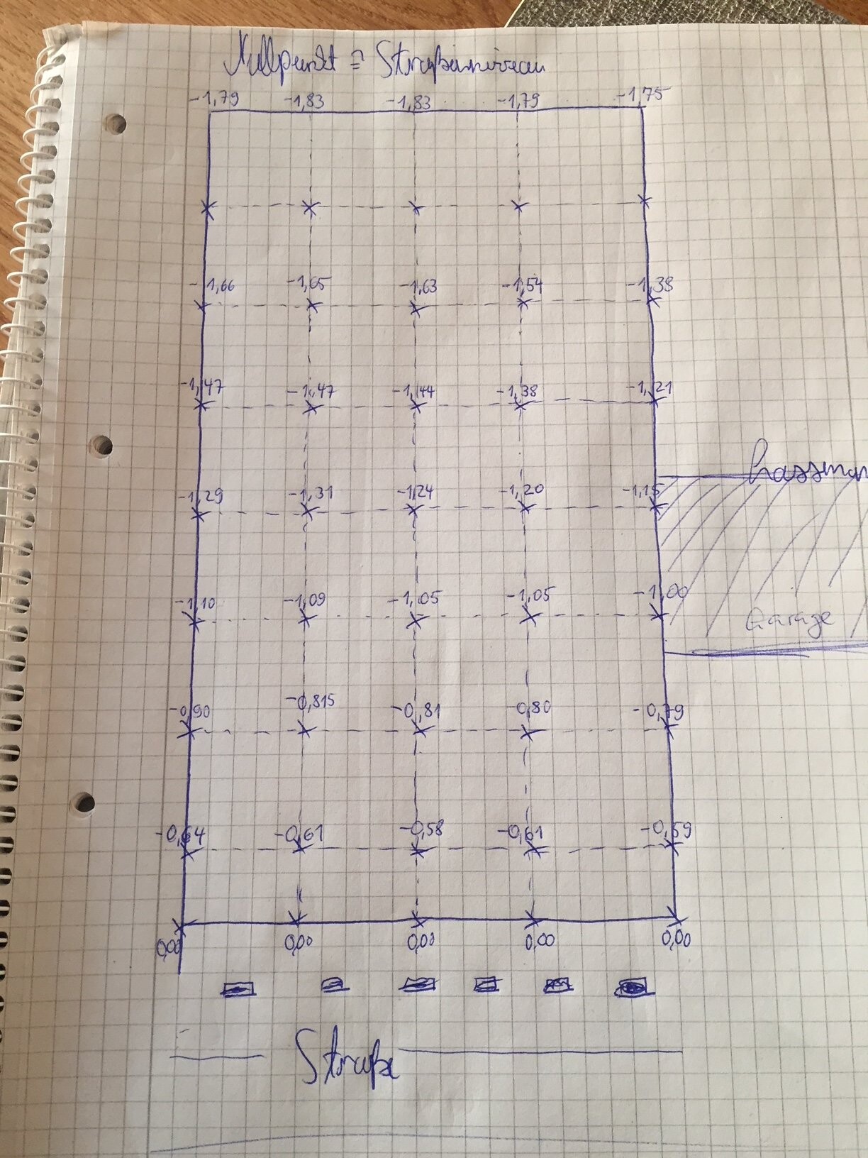

Our plot slopes down from street level by almost 1.80m (6 feet). Please see the image below (each square corresponds to 1 meter (3 feet)).
Now to my question: Could you share your opinions on whether you would prefer a basement or to raise the ground level? Since we want to position the house as close to the street as possible, it’s not clear if opting for a basement is the best solution here. The plot is somewhat “in between” in this regard.

Mottenhausen9 Dec 2019 15:01Mudo1991 schrieb:
@11ant The survey area covers the entire plot.So, a slope of 1.8m (6 feet) over nearly 40m (130 feet) depth of the plot? That is so slight that it should hardly affect the decision on whether to build a basement or not. If the street level were lower, I would consider the option of an underground garage, but as it stands... get quotes for both with and without a basement and then decide based on a cost-benefit analysis.
Mottenhausen schrieb:
So a 1.8m (6 feet) slope over almost 40m (130 feet) of lot depth? That’s so slight that it should hardly affect the decision about having a basement or not. If the street were lower, I would consider an underground garage, but as it is... get quotes with and without a basement and then decide based on a cost-benefit comparison. Even if I want to bring the ground floor up to street level?
Mottenhausen9 Dec 2019 15:13Yes, definitely. Simply backfilling and compacting layer by layer doesn’t cost a fortune.

Even on a flat plot, you will need to remove more than just the topsoil for the foundation slab.
Regardless of the plot
Do you want a basement?
Which rooms should be located there?
Some builders construct a basement on a perfectly level plot, while others fill in 2 m (6.5 ft) or more within the building area to avoid having to build a basement.
How are your neighboring properties developed?
We actually don’t need a basement and would only use it reasonably for a utility room and technical equipment. We would still have an office on the ground floor, considering a bedroom for old age. As a fully basemented house, the basement would be oversized.
@haydee The neighboring plot to the north is vacant, to the east there are buildings at a sufficient distance, and to the south, the garage is right at the property line with a large house directly behind it.
Mudo1991 schrieb:
We would still have an office on the ground floor with a view to a bedroom for old age. A full basement would also be oversized. Oh, two suggestions at once for the recommendation, but first, there is still a lot to read for several rounds: Especially if 1991 is your birth year, you are more likely to build again close to retirement than it would make sense to prepare a care-friendly ground floor in advance. And partial basements "save" only in a few special cases.
