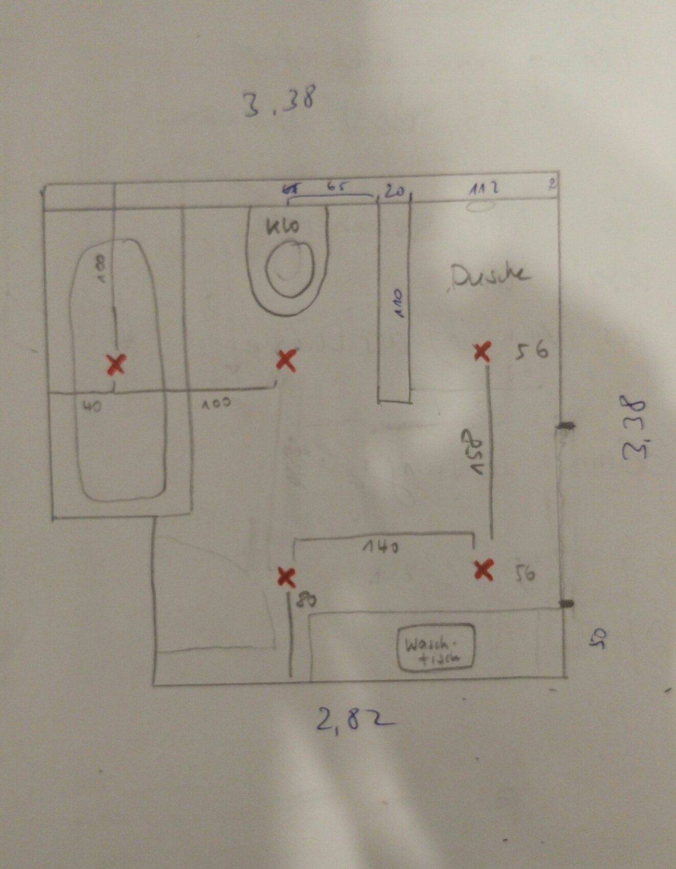

Hello everyone!
I have been working on planning the LED spotlights in the bathroom of our new build for hours now. I originally thought that 5 spots would be enough, arranged symmetrically. But then the distances between some spots are quite large (140cm (55 inches) and 158cm (62 inches)). I hope you can see all the necessary information on my sketch. Sorry for the poor quality.
Do you have any ideas on how to do it better or differently? Should I just add 2 more spots?
We completely removed the washbasin from the circuit because it will have separate lighting anyway.
We also made the spotlights dimmable so that you can still see something while bathing, but the atmosphere is more relaxing.
I would consider whether LED lighting is actually appropriate or if halogen might be a better choice.
Best regards in short
Knallkörper20 Jun 2017 10:15More recessed lights with lower wattage each provide a pleasant, even, and glare-free illumination. In the shower, I installed two because I personally didn’t like the large shadows cast by the 360 mm (14 inch) Raindance showerhead. Medicine cabinets also work well for us as a kind of "night light"; we have already replaced the switches with automatic ones. Finally, for recessed lighting, you can use a combination of dimmer and automatic switch—there are many options available, including night light functions and adjustable turn-on brightness. Personally, I prefer this over wall and niche lighting. We have 10 recessed lights in a similar floor area.
My two cents on LED versus halogen: an important consideration is the heat generated by the fixtures, especially if a vapor barrier is present. LEDs tend to be less critical in this regard. (Nonetheless, I measured temperatures of around 90 degrees Celsius (194°F) on a 6W LED fixture using an infrared thermometer; the fixture was hanging freely on the cable, turned on for one hour.)
