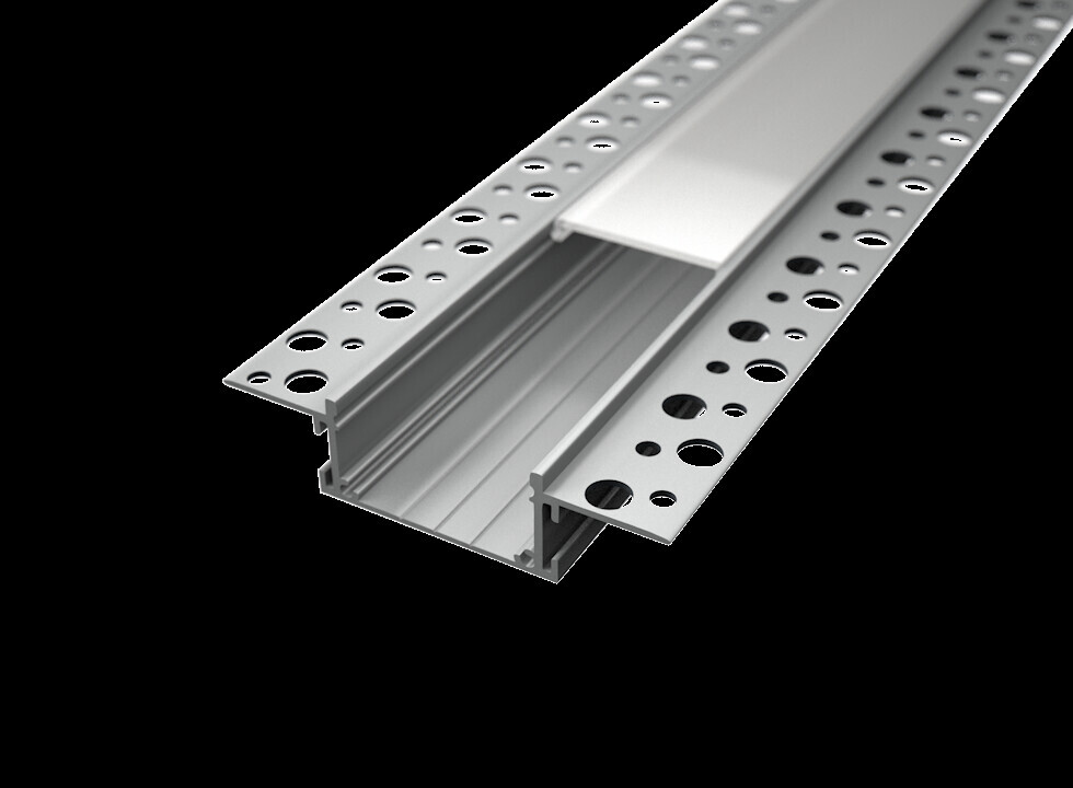

I installed these profiles in my garage lintel; they were properly covered with plaster.
Long aluminum mounting profile with many round holes, open U-profile
I’m not entirely sure what you are planning: Do you want to have them on the walls or just on the ceiling?
