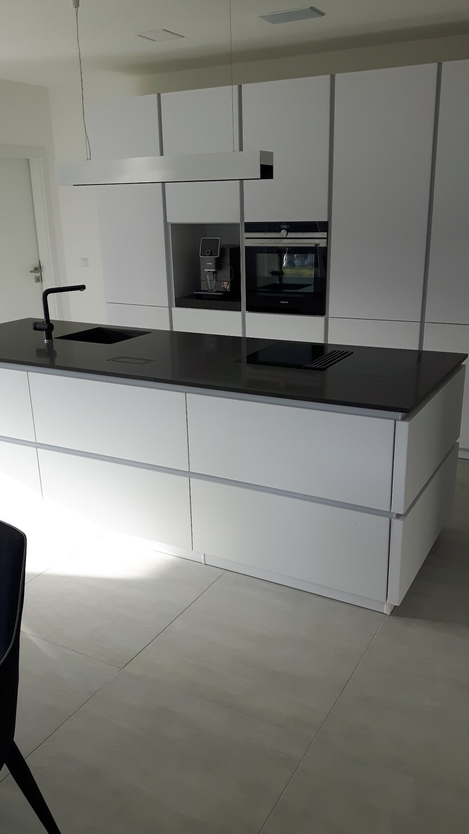

WilderSueden21 Sep 2023 15:13We have a few spotlights, each above the showers and one above a toilet, plus three in the hallway. I would do it the same way again. In the kitchen, we have task lighting under the wall cabinets, which is much closer to the work area than a dozen spotlights on the ceiling.
I installed several 20 x 20 cm (8 x 8 inches) recessed LED spotlights/panels. You can see them at the top left next to the LP. They are almost completely flush and provide bright light. I can adjust the color temperature in three steps. I installed them in several rooms. The drywall contractor cut the holes beforehand, which made installation very quick and easy.
In my opinion, spotlights are not appealing, and I don’t understand why they are used so excessively in nearly every new build. Usually, when the homeowner skips installing dimmers, it ends up looking like a doctor’s office or an operating room. I would much rather focus on individual accent or focal lighting (since "spot" actually means a single point, not mass usage) as well as indirect lighting. In areas where you really need a lot of light (which is usually not the living space), panels work well. They provide, as you said, consistently even illumination.
