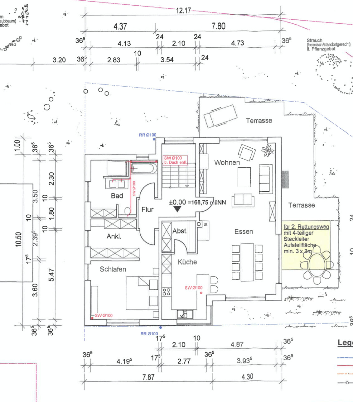

we are almost finished with the planning of our project, but there is one issue that has concerned us from the start and that we haven’t been able to solve given the current floor plan layout.
I’ll try to keep it brief: We definitely want a built-in shower without a door in the ground floor bathroom (it doesn’t have to be fully walled up to the ceiling; it can also be half-open with, for example, glass extending up to the ceiling). Because of strict building regulations—or rather, regulations that are not favorable for our project—we get very little living space in the attic, so we had to give up on having the bedroom there. Therefore, the bedroom, dressing room, and master bathroom are all on the ground floor. Due to the somewhat limited square footage, we are unable to fit the shower in the bathroom the way we would like. Do you perhaps have any tips or ideas on how we could plan the shower a bit larger or longer within this floor plan so that we wouldn’t need a door for the shower? I was told that a doorless shower only makes sense from about 1.60m (5 ft 3 in) in length.
I’m deliberately not going into further detailed information about the project, the plot, etc., since this concerns only the bathroom. The bathroom is 12.66 m2 (136 sq ft), the dressing room is 9.09 m2 (98 sq ft), and the master bedroom is 15.31 m2 (165 sq ft).

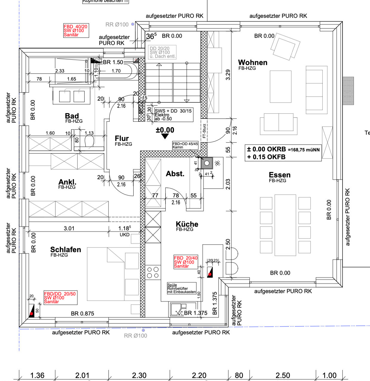

It’s not about having the bed in view when you enter the room, but rather about practically lying in bed with your head right next to the door. This always feels much less comfortable than lying in bed and looking towards the door from there.
Therefore, position the headboard of the bed either to the left side of the room or even along the bottom side of the plan. On the wall with the headboard, there should either be no window or two rather narrow windows on each side of the bed. Having the headboard along the bottom side also has the advantage that there is plenty of space on both sides of the bed. A wider window could then be installed on the left side. Ideally, maintain at least 60 to 70 cm (24 to 28 inches) of distance from the partition wall to the dressing area.
If there is a bathtub, I would plan for more space there, and reduce the length of the shower accordingly. The passage near the washbasin looks very narrow.
I would swap the toilet and closet storage areas and avoid placing a large dividing wall between them.
I would adjust the sill height above the bathtub. A height of 150 cm (59 inches) is not ideal—if there is a window by the bathtub, it might even be designed so you can look out from the tub. Cleaning the window will be inconvenient regardless of its position.

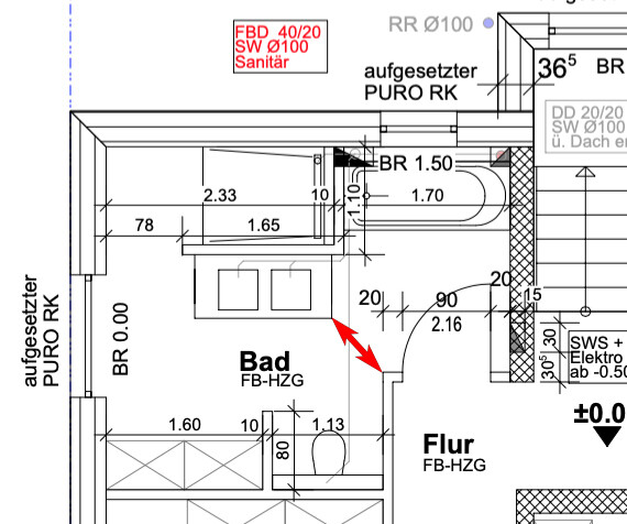

This looks quite awkward to me.
This narrow passage is rather poor:
Also, when entering the bathroom, you end up right at the bathtub. To avoid this, you have to almost make a 180° turn and squeeze through the narrow space.
The room dimensions are not indicated here either. Or can someone redraw the room based on the windowsill height and the bathtub width?
Having the bed placed like this is completely out of the question. I hope you have also planned electrical outlets on the other side so you can reposition it once you see it and realize this.
Additionally, I would suggest having the living room door open the other way around—just as a side note.
