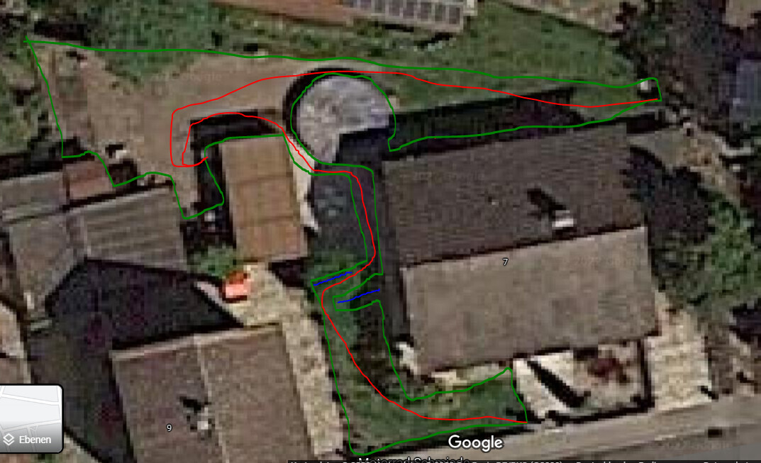

I would like to install a robotic lawn mower in my garden but am quite uncertain about how to proceed!
The green outline represents the future lawn area, the red line indicates a possible location for a boundary wire, and the blue area marks a privacy screen that will still be installed.
There is a terrace with chairs and a table between the two areas, so the mower cannot simply pass through there.
Questions:
What is the best way to mow the two separate areas?
Is the position of the charging station (at the end of the red lines) suitable?
Would the robotic mower be able to mow around the privacy screen as well?
My only idea so far is to create two separate mowing zones, manually place the mower on the second area at fixed intervals, and have it return to the charging station using the boundary wire. I would try to lay the wire as far as possible from the terrace chairs, probably in the gaps between the tiles.
The plot has a slight incline to the right, but there are no height differences between the garage, pool, and the lower area.
Thank you in advance.

I have created another "drawing." The blue area still represents a privacy screen, green is BK, and red is SK.
The space between the pool and garage is unfortunately only 78cm (31 inches), and the area above between the pool and fence is just over 80cm (31.5 inches), but no lawn edging stones have been installed there yet. Is it even possible to implement it this way? I understand that a corridor of 60cm (24 inches) is possible (Gardena smart silent), but there should also be a 35cm (14 inches) clearance from a wall. If narrower corridors are possible using, for example, Husqvarna or other brands, that would also be something to consider.
