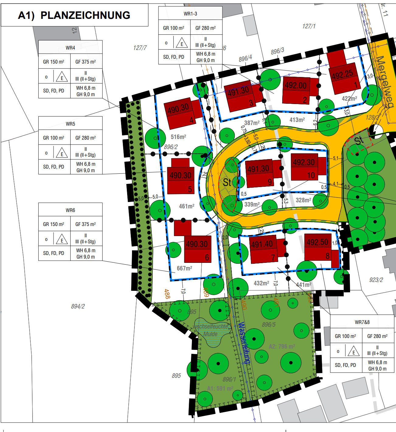

wiltshire15 Jan 2025 22:09The driveway width wouldn’t be a concern for me. What is located outside the area to be developed?
Panning206115 Jan 2025 22:28wiltshire schrieb:
The driveway width wouldn’t worry me. What is located outside of the area to be developed? On the north side, there is also a residential area with multi-family houses and detached houses. To the west, there are fields behind the trees.
Both plots are subject to nearly identical regulatory frameworks, but the buildable area increases by 50 square meters (about 540 square feet) once the lot size crosses the 500 square meter (approximately 5,380 square feet) threshold. Due to the visitor parking spaces opposite and the curved road layout, both driveway situations are similarly moderate (but not bad). It is not automatically granted that you can use the entire street boundary as a driveway, and the driveway for plot 5 is actually more convenient. If you can afford the slightly larger plot size, you will have significantly more freedom to build on plot 5. Plot 5 borders only the adjacent neighbors 4 and 6, while plot 4, as a corner lot, borders plot 5 and existing development. Regarding the required planting strip, neither plot disadvantages the other. The terrain appears to be fairly level from north to south and slopes noticeably toward the west.

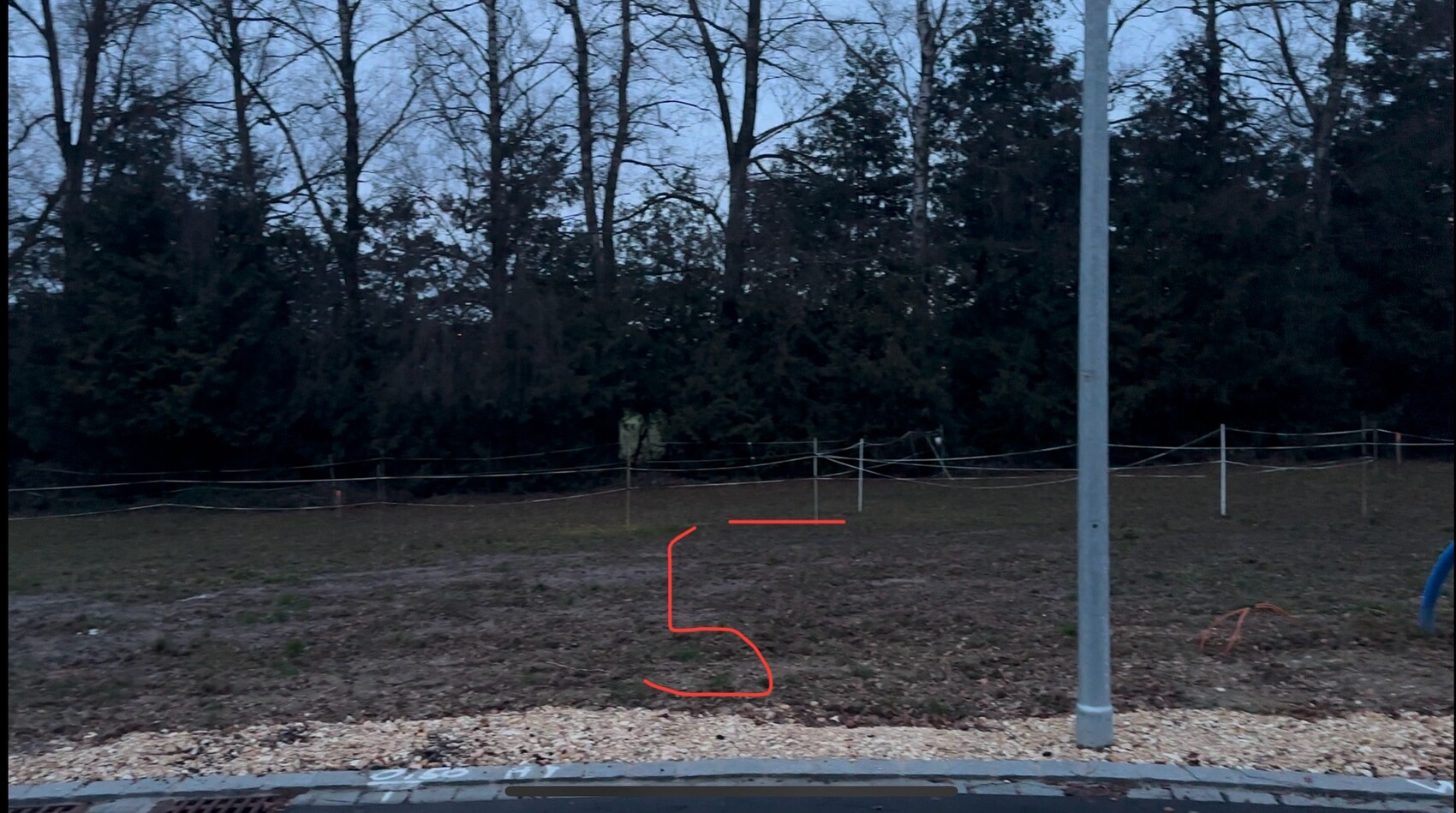

P.S.: This is roughly how it probably looks there at the moment:
Panning206115 Jan 2025 23:0111ant schrieb:
Both plots are subject to practically the same regulatory framework, but the buildable area jumps by 50 square meters (about 540 square feet) once you cross the “500 sqm (5400 sq ft) plot size” threshold. Due to the visitor parking spaces opposite and the curved layout of the street, both driveway situations are similarly moderate (but not bad). It is not automatically granted that you can use the entire street frontage as a driveway, and the one on plot 5 is actually more convenient. If you can afford the larger plot size, building on plot 5 offers significantly more freedom. Plot 5 only borders the adjacent neighbors 4 and 6, while plot 4, as a corner plot, borders plot 5 and existing buildings. Regarding the mandatory planting strip, they cancel each other out. The terrain seems fairly level north-south and noticeably slopes downward to the west. I can’t really picture a house on plot number 4 yet, at least not visually.
P.S. This is approximately what it currently looks like there: In fact, it’s already finished; only the plots are still undeveloped. It is fully serviced, etc.
I can only roughly imagine building on the corner like this.
The tree that was supposed to be on plot 5 has been cut down, but the municipality would plant a new one and you could choose which type.
