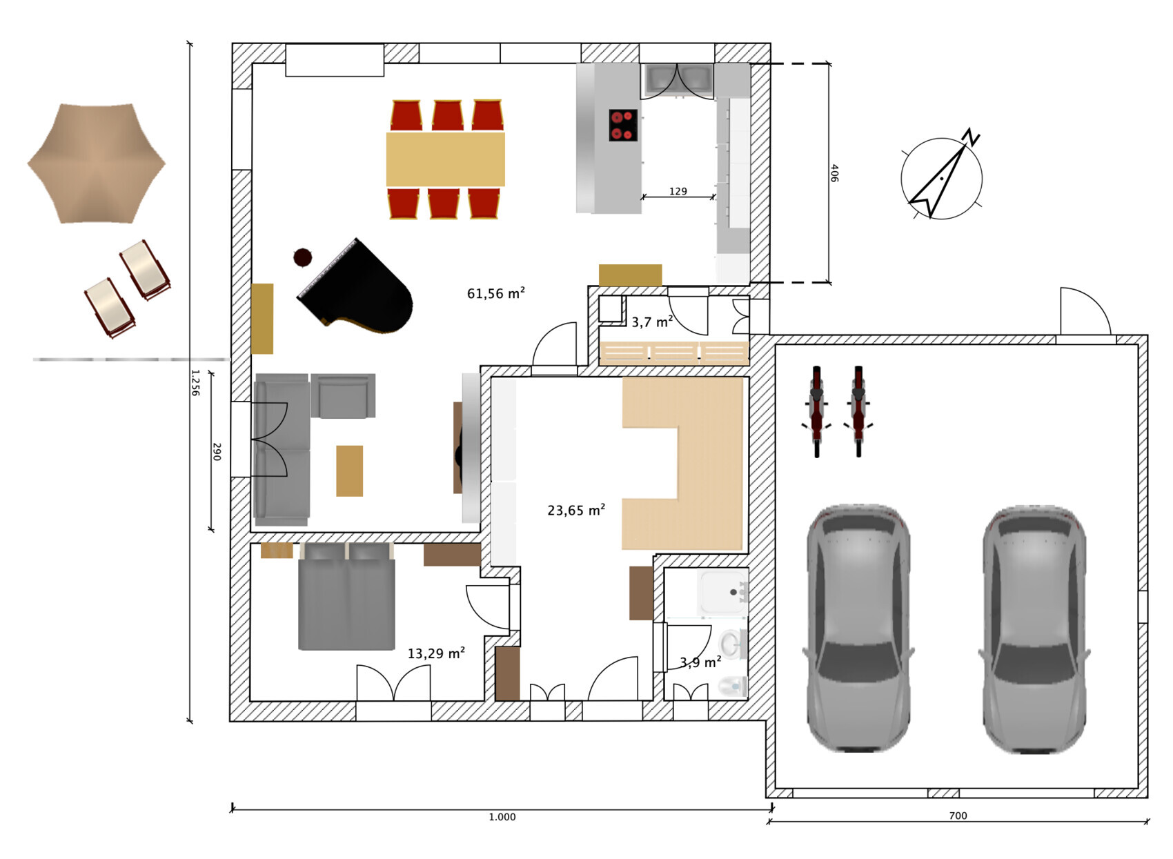

I have mostly been a silent reader until now, but I’m stuck with my plans and need some advice. Here are the basic details first:
Homeowner requirements
Bright with lots of space, modern, open but not too stylish. Function follows design.
Lots of space and storage, no dark hallways, entrance area ideally with an atrium.
Guest bathroom and staircase to upper floor should not be directly at the main door (to avoid dirt area).
We have a grand piano (1.6x1.8 m (5.2x6 ft)), which must be accommodated in the house (an heirloom with personality, occasionally played). Ideally in the living room on the ground floor in a dark corner to avoid direct sunlight. Alternatively upstairs, but definitely not in the basement.
Well insulated. We are considering QNG certification to qualify for the KfW loan, but not if it leads to unreasonable extra effort.
Planned by: Do-it-Yourself
What do you especially like?

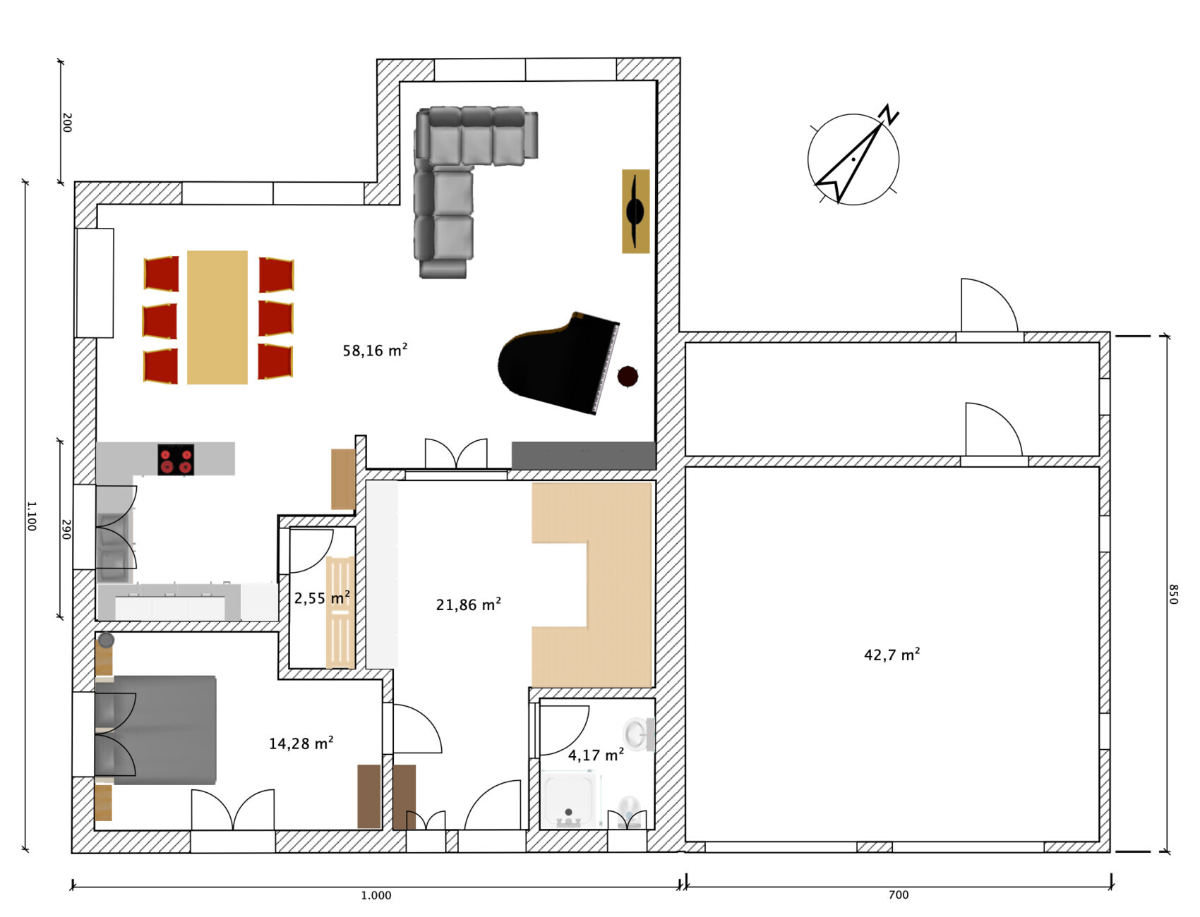

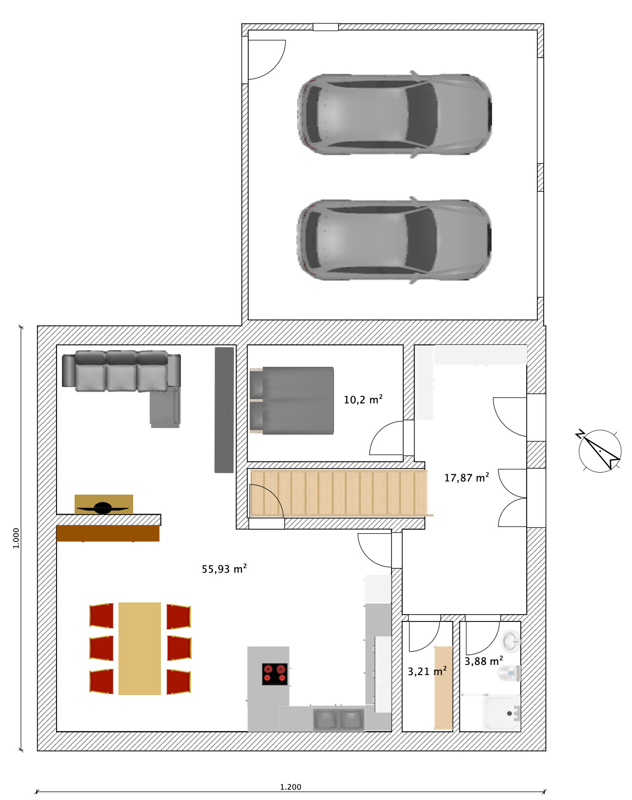

The version with a straight staircase is basically just a larger version of the sample house with a 10x12 m (33x39 ft) footprint. I’m not a fan of straight stairs, and the basement access would go through the living room. However, the entrance with a separate wardrobe is appealing.
With the bay window variant: the bay window likely increases costs. The guest bathroom is accessed through the dirt zone near the entrance door. If I swap staircase and guest bath, the bathroom won’t have a window unless I move the garage forward as well.
With the 10x12.5 m (33x41 ft) variant: The grand piano somehow doesn’t fit well.
Personal budget limit for house, basement, including fittings, garage, terrace, driveway
900,000
Preferred heating system:
Air-source heat pump with underfloor heating and ideally also central residential ventilation.
If you have to give up on certain features or expansions, which ones would you drop?
The grand piano can be moved upstairs if necessary. The garage can be replaced by a carport.
Which features can you absolutely not do without?
The basement is still under discussion. My wife prefers having a basement. I could live without one.
Why is the design like it is now?
Experimenting with SweetHome 3D after studying many show homes and floor plans, none of which suited us because a room was always missing or there wasn’t enough space for the grand piano in the living area.
The goal is to get a rough idea of how much living area is needed to fit all the desired rooms, so we can then estimate costs.
I try to keep the footprint to 10x12 m (33x39 ft) so that the overall living area doesn’t get out of hand. However, this limits fitting a guest room as well as the grand piano on the ground floor. The space shouldn’t feel cramped. I definitely do not want to make it bigger since we don’t need extra space upstairs.
I’m open to all criticism. My thinking is probably stuck on these floor plans, so a push in a completely different direction might be helpful.

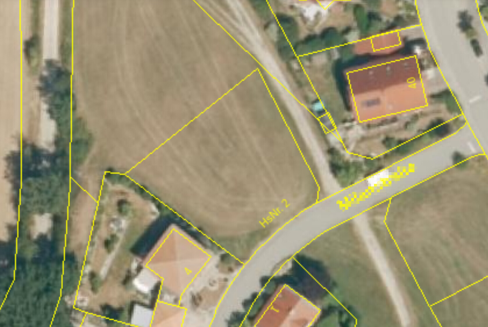

| Plot size | 900 sqm (already owned) |

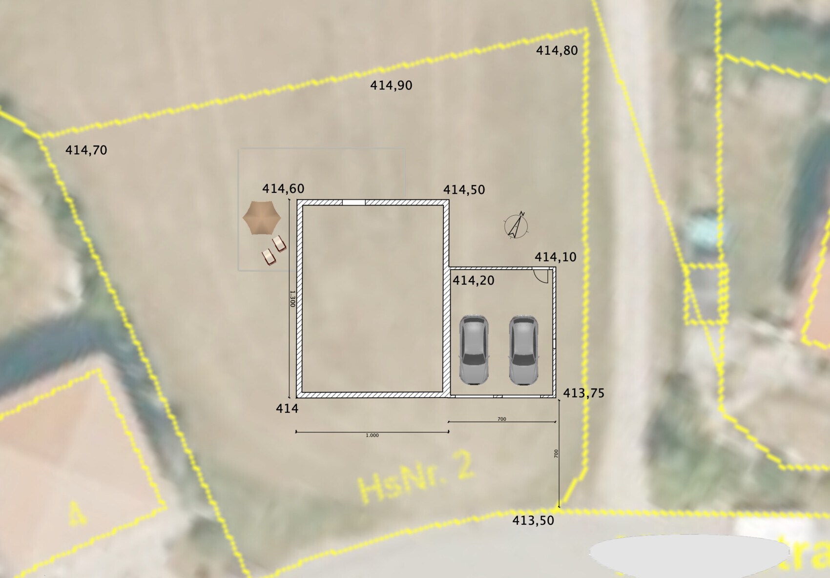

| Slope | Entire plot drops from north to south by about 1.2 m (4 ft) over 29 m (95 ft), within the building envelope of the house over 13 m (43 ft) it drops about 0.6–0.8 m (2–2.5 ft) |
| Site coverage ratio | 0.2 |
| Floor area ratio | 0.33 |

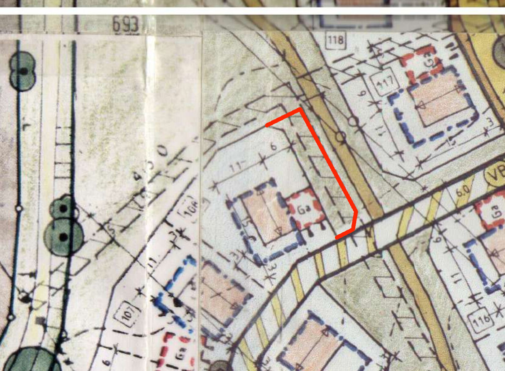

| Building envelope, building line, and boundary | House 15x11 m (49x36 ft), garage 6x8.5 m (20x28 ft); garage width can increase if it remains within the building envelope of the house. The building envelope was defined for a smaller plot, which was later extended eastwards (see image Baufenster.jpg). I assume the envelope may be moved east accordingly, but approval is still pending. |
| Edge development | Garage only |
| Number of parking spaces | 2 |
| Number of storeys | 2 full floors |
| Roof type | Gable roof with 25–30° pitch |
| Orientation | View from living-dining area towards northwest, as this side is unobstructed |
| Maximum heights / restrictions | - Wall height 6.1 m (20 ft) (measured from top of ground floor slab) - Base height 0.3 m (1 ft) (from top of ground floor slab) - Excavations not allowed - Filling up to 0.5 m (1.6 ft) allowed - Width-to-length ratio must not significantly deviate from 1:1.2 - Excavations and fillings allowed for garage access (base height up to 1 m (3.3 ft)) |

xMisterDx12 Dec 2023 20:28But now aren't we stepping into satire?
A music room, 4x4 m (13x13 ft), for a grand piano?
Anyone who does that would probably also put their motorboat into a swimming pool measuring 10x4 m (33x13 ft).
We're talking about a grand piano, not a keyboard. A grand piano requires a reasonably large room for proper acoustics; in a 16 m² (172 ft²) room, it sounds like a sack of nuts. Truly the dream of every professional musician.
xMisterDx schrieb:
Now we’ve clearly reached satire, haven’t we?
A music room, 4x4m (13x13 ft), for a grand piano?
Anyone doing something like that would also put their motorboat in a swimming pool measuring 10x4m (33x13 ft).
We’re talking about a grand piano... not a keyboard. A grand piano needs a reasonably large room for proper acoustics; in a 16m² (172 ft²) space it sounds like a sack of nuts. Surely every professional musician’s dream. Here an expert reveals themselves 😀;)
I’ll just leave it at that here.
Regardless, at the very least, care should be taken to ensure the instrument is not exposed to large fluctuations in temperature and humidity to avoid damage. Everything else is more a matter of personal preference, which any architect involved will surely take into account.
Buchsbaum13 Dec 2023 08:45xMisterDx schrieb:
Children can and should be taught not to scribble on the wooden table or grand piano... Do you even have young children yourself? Please show me a child who doesn’t scribble somewhere at some point. Unfortunately, you often come across as quite out of touch with reality.
Theory and practice usually differ significantly.
First, it’s important to clarify what kind of grand piano we’re talking about. It could be a large concert grand or a baby grand. If the original poster wants to have a music room, then they should go ahead and do so.
If there will be three children, ideally you would need three separate bedrooms. One master bedroom, two bathrooms, a kitchen, a living room. That will be a large house.
Schorsch_baut13 Dec 2023 09:45A friend of ours is an amateur pianist and musicologist and has his Bechstein grand piano placed in a bay window of the living room. Since it is an old grand piano, it needs regular tuning anyway, so direct sunlight doesn’t really matter.
hanghaus202313 Dec 2023 11:35If I interpret the elevations correctly, there is only a 0.6 m (2 feet) height difference affecting the house.
Is there a reference height specified in the building permit / planning permission?
