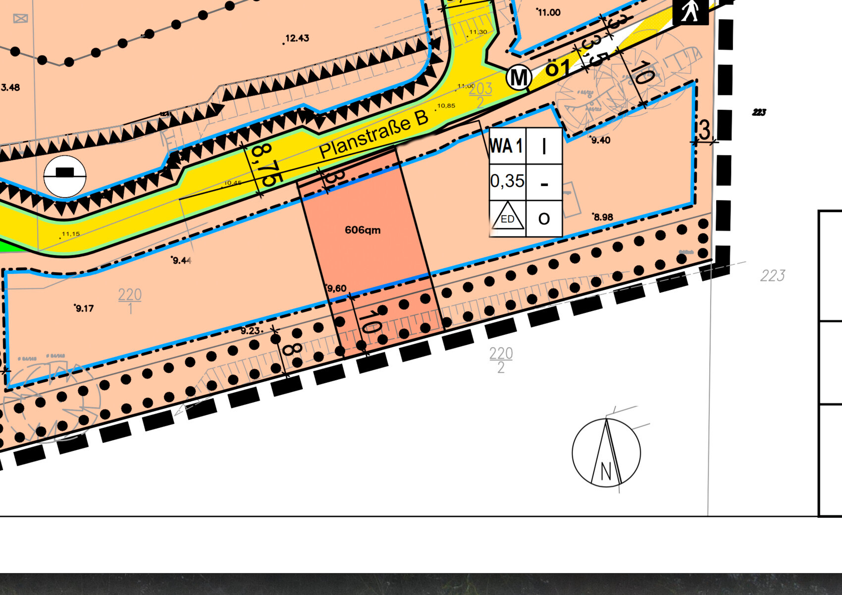

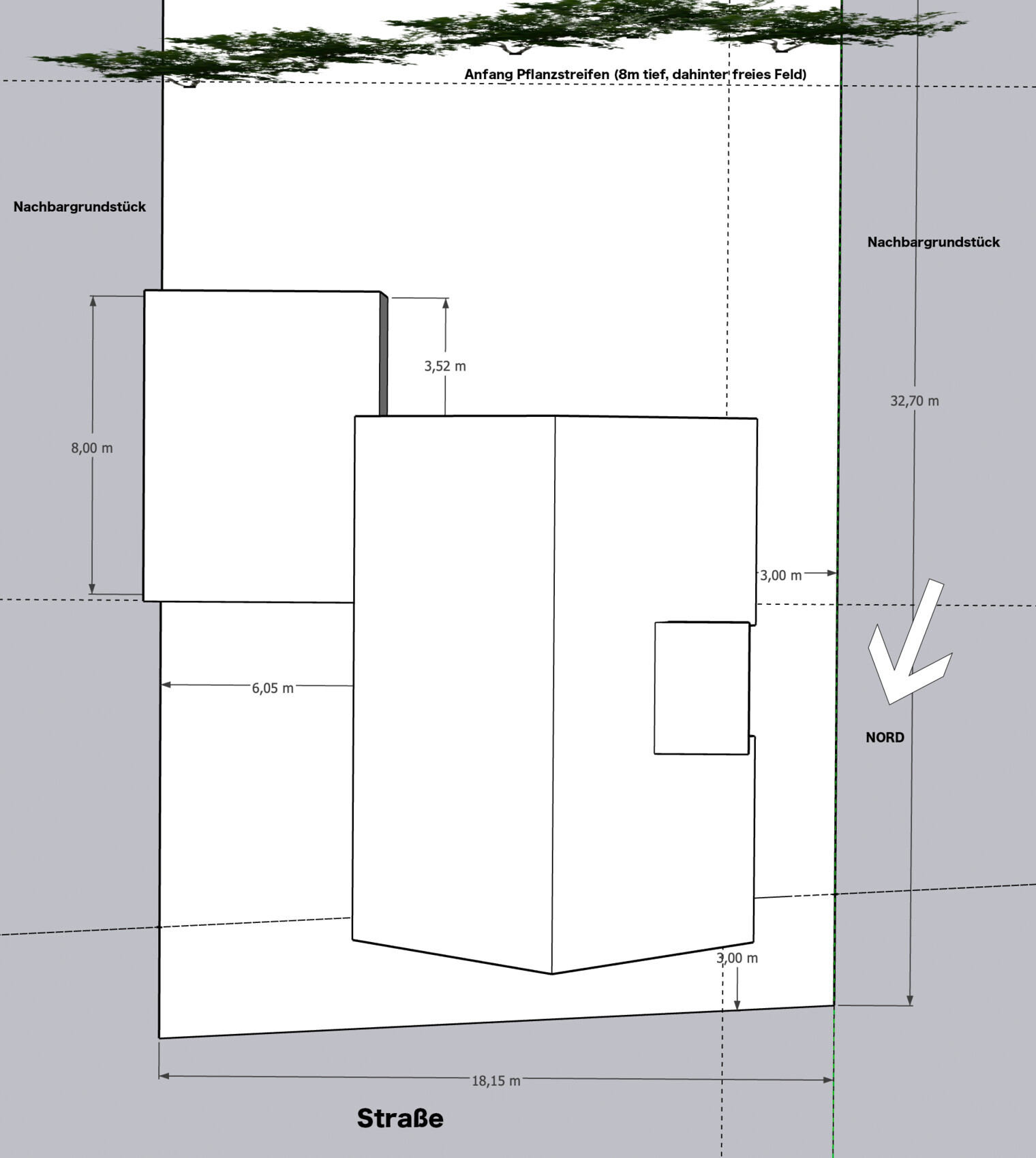

I more or less stumbled upon a plot of land after someone let their reservation expire.
The plot is about 606 square meters (6,521 square feet), according to my "measurement" approximately 18.10 meters by 33.50 meters (60 feet by 110 feet), not officially surveyed yet, and now I’m wondering exactly what I can do with it.
The development plan sets out the following for "my plot":
  • 0.35 floor area ratio
  • Single-story buildings only
  • Maximum building height 10 meters (33 feet)
  • Eave height max 4.50 meters (15 feet)
  • One driveway with max width of 4 meters (13 feet)
  • Two parking spaces are mandatory
  • Roof pitch between 15° and 51°
  • Roofs of garages etc. may differ in shape
  • Garages, carports, and ancillary buildings as defined by §14 (1) of the building use ordinance, which are buildings, must not exceed the street-side building boundaries of the access roads.
  • Dormers and roof recesses: the total length of dormers or roof recesses per roof side may not exceed 50% of the total length of that roof side.
  • Standard distance to property boundary is 3 meters (10 feet)
  • In the southern area, there is an 8-meter (26 feet) deep strip across the full width of the plot (approx. 18 meters (60 feet)) where trees and shrubs must be preserved. This area is quite densely vegetated and reaches heights up to 10 meters (33 feet) – I’ve tried to visualize this below
  • In the middle of this vegetation is a downward slope... the building boundary to this strip was reduced from the normal 3 meters to 2 meters (7 feet) so the plots aren’t too restricted.
Site plan of a building area with street B, colored zones, measurements (606 sqm) and north arrow.
Plot layout with central house, surrounding courtyard area and garden hedge at the bottom edge.

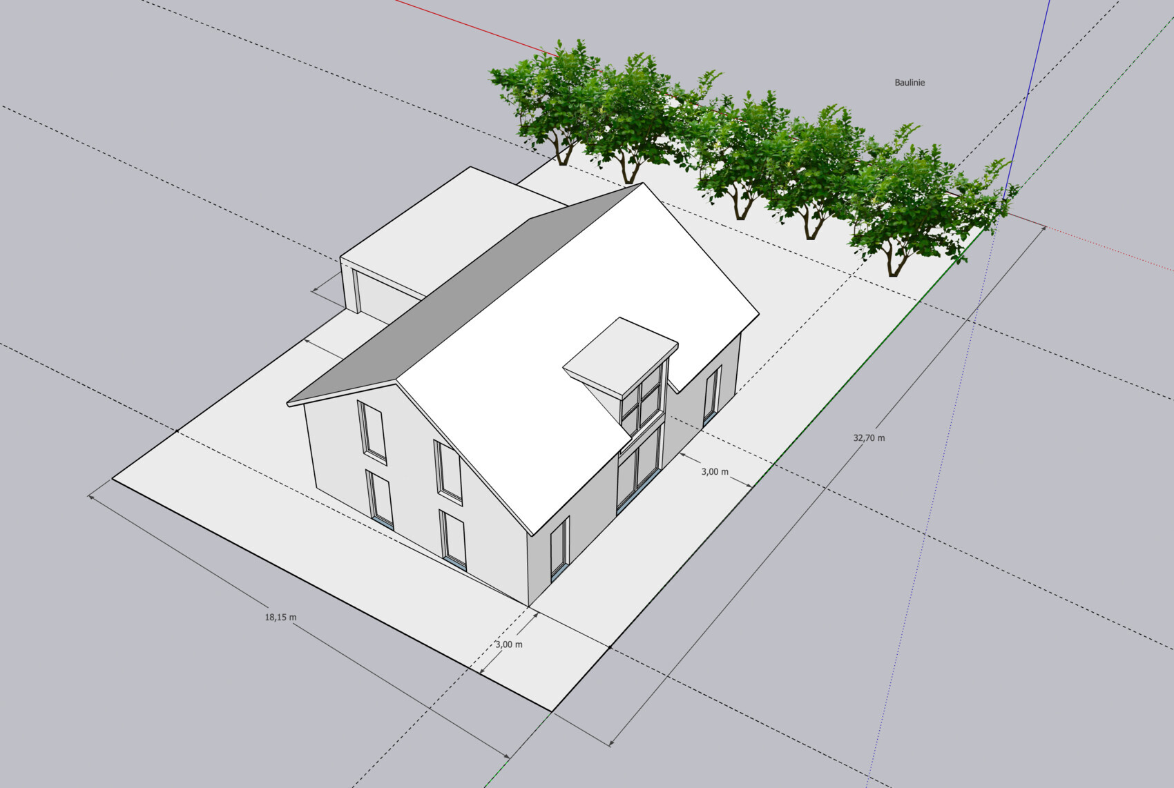

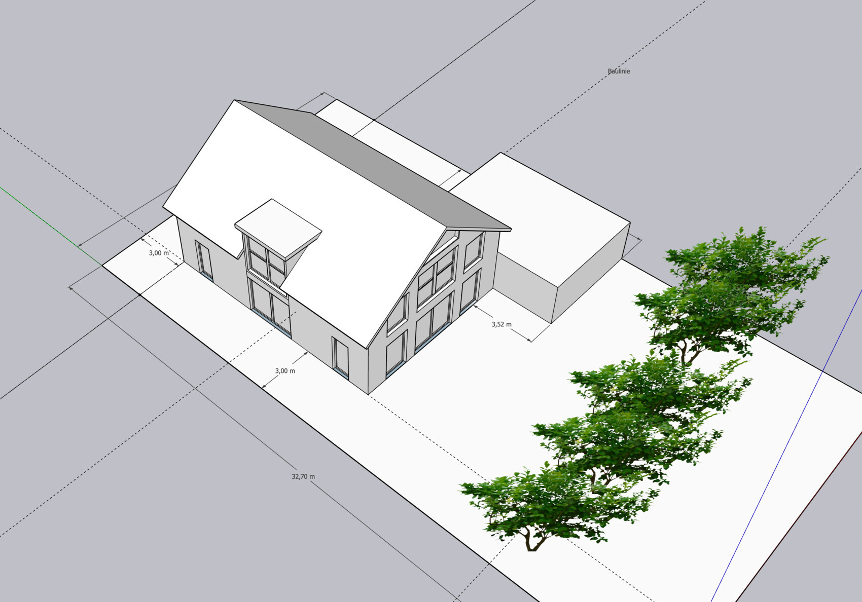

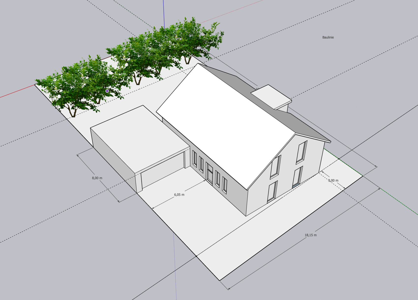

3D model: House on plot with hedge and indicated dimensions.
3D house model with gable roof on blue background, green hedge at edge, dimension lines visible.
Here I have placed an example house measuring 9.60 meters by 11.95 meters (31.5 feet by 39 feet), which I like based on my initial review (Viebrockhaus Edition 600).
Next to the house, in the 5.50-meter (18 feet) wide space there would be a carport – is that enough space for two parking spots? I would prefer not to make the house narrower just to accommodate vehicles... but then there’s hardly any room left for fencing?!
The terrace and garden at the back are, of course, limited by the tall trees – but that’s a compromise I’ll have to accept.
I’ve never built a house in my life before... so this is my first time dealing with this topic in detail. What would you do in this situation? Make the house a bit smaller?
If you need more information, just ask – as I said, I’m a beginner and eager to learn 🙂

Garage, carport: Plot is not measured yet; should be about 18.15m (60 ft) wide, so (see my sketch) a double garage should fit?!

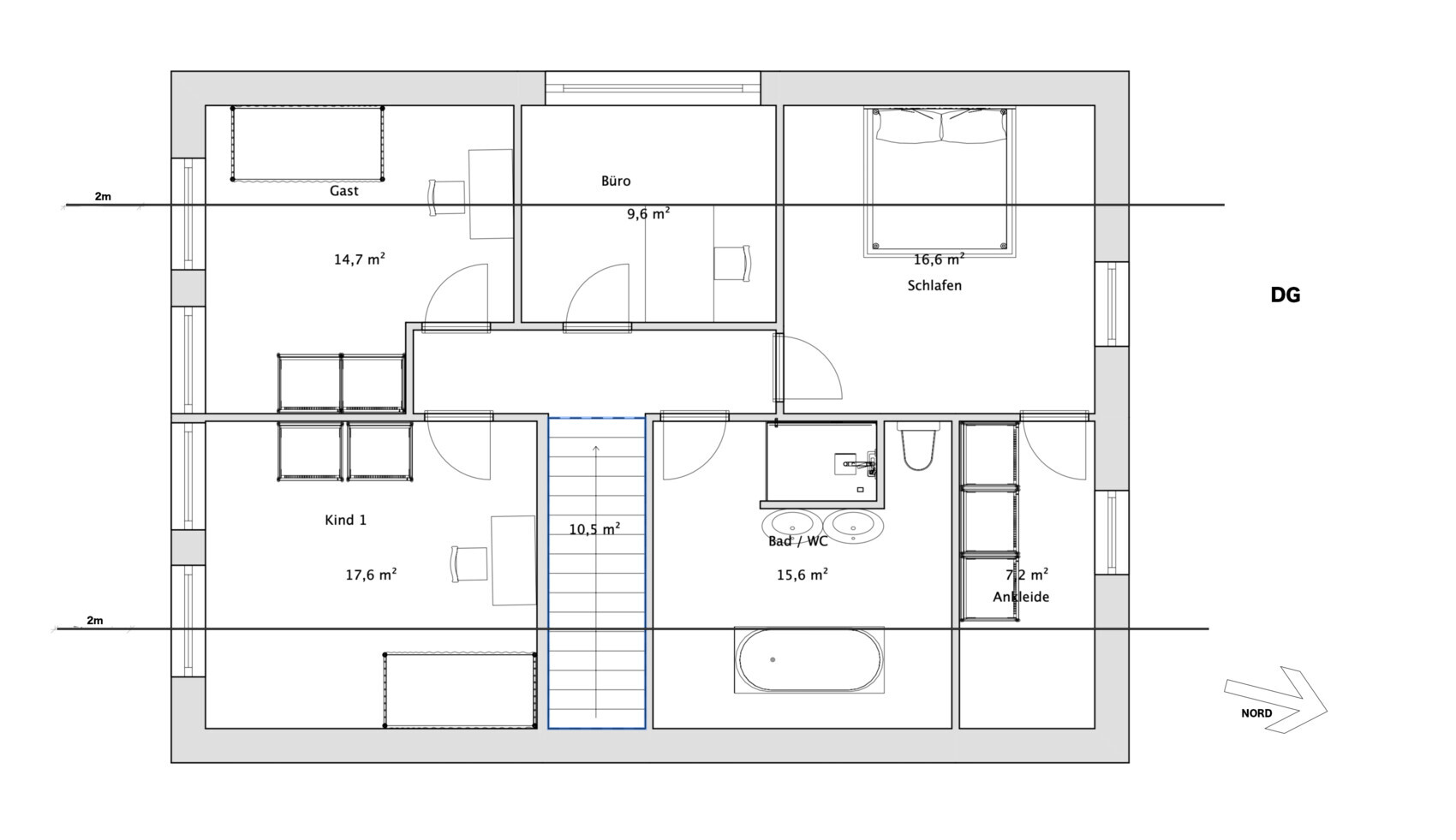

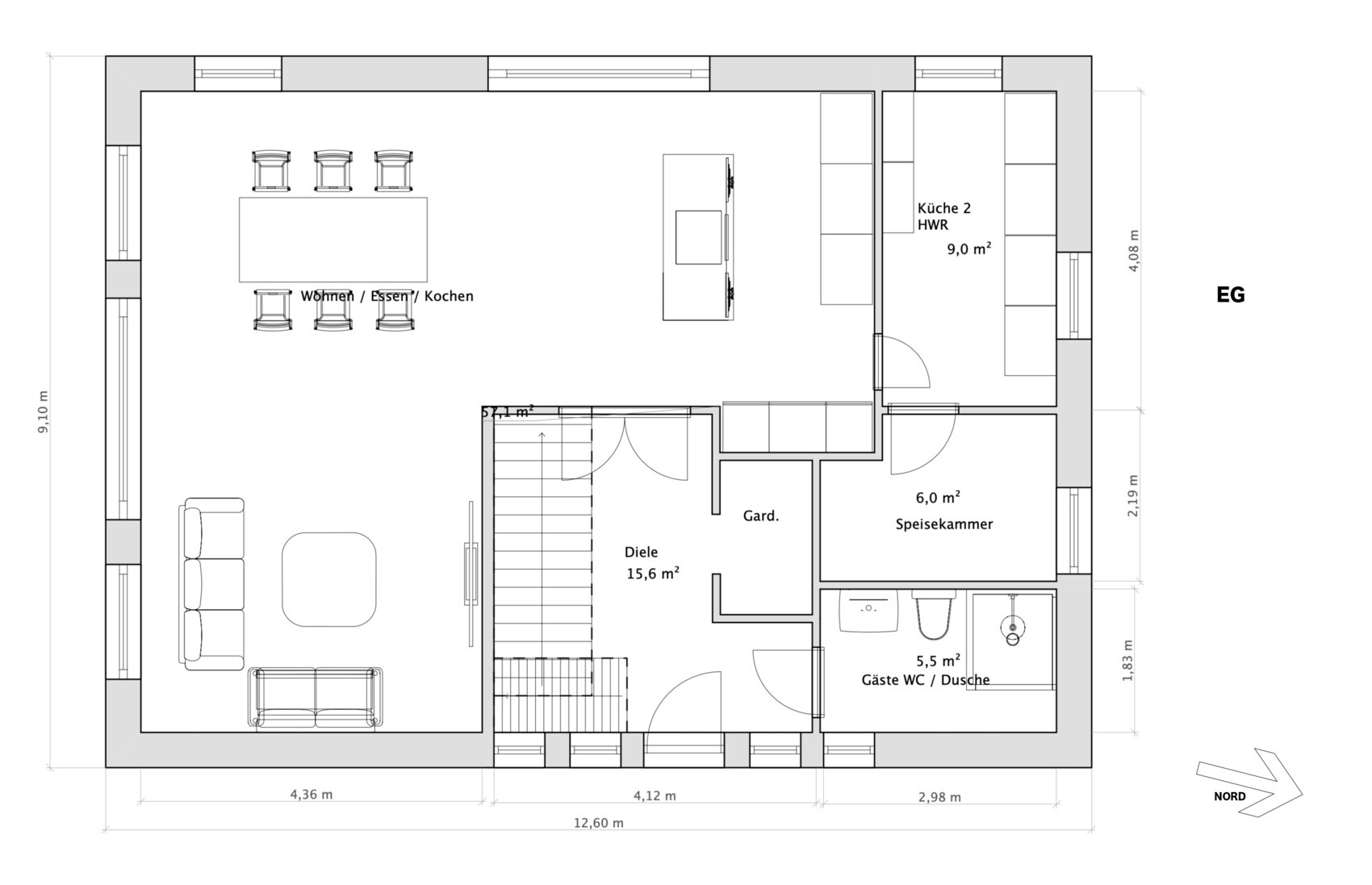

Standard design from Viebrockhaus, which we like as is… on the upper floor, we so far only partitioned part of the office into a room—in the original plan, it is an open space… but since Viebrockhaus anticipates a workspace here, it probably isn’t ideal to have it open in the hallway area…
Bedroom faces north toward the street because the house must be oriented with its gable side to the street. Is the bay window a “waste” since it only faces the neighboring house?
Site plan of a building complex: floor plan, dimension lines, neighboring plots, north direction.
Ground floor plan: open living/dining/kitchen area, kitchen 2, pantry, guest WC, hall.
Attic floor plan: guest, office, bedroom, child 1, bath/WC, dressing room; staircase.

In my personal opinion, a second kitchen only makes sense if you have staff who can quietly prepare food when guests are present. I wouldn’t install a second kitchen in the house just to have a place to put dirty dishes, especially not 2 meters (6.5 feet) away from the main kitchen. A kitchen like that will cost you roughly 3,000€*9 sqm plus kitchen appliances easily totaling around 35,000€. With that kind of budget, you could throw away used dishes for years instead. It’s better to spend 5 minutes loading everything into the dishwasher. Then you get a large utility room/pantry combination instead.
By the way, where exactly do you want to place the terrace? Which door will you use to go outside?
Adding this extra wall for the office will certainly make the hallway and stairs quite dark. Is that what you want? The hallway also feels a bit cramped. The openness of the original design won’t remain much, but the “office” there was only really suited to paying bills on a Sunday afternoon.
haydee
21 Jan 2021 20:45
A secondary kitchen for practical use and what the show kitchen is for.
You get the western sun
