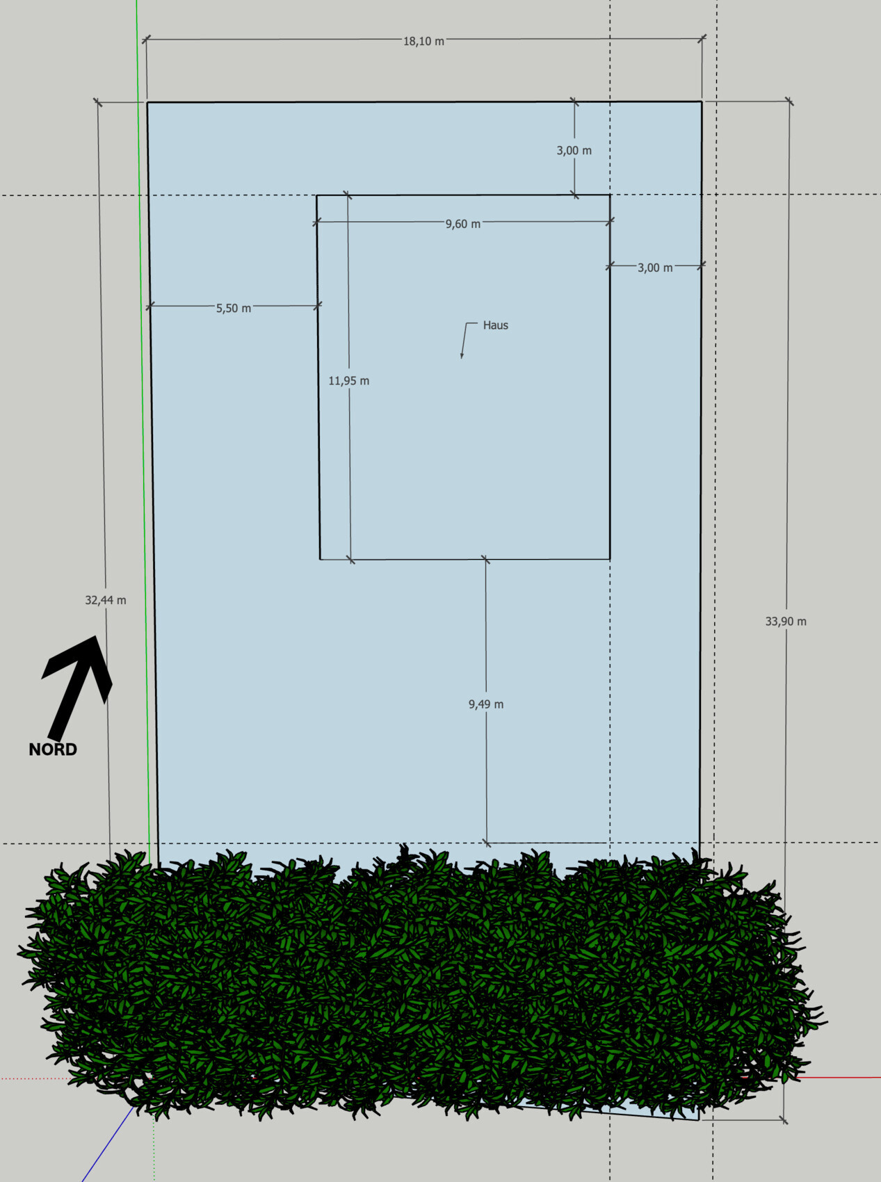

Here I have placed an example house measuring 9.60 meters by 11.95 meters (31.5 feet by 39 feet), which I like based on my initial review (Viebrockhaus Edition 600).
Next to the house, in the 5.50-meter (18 feet) wide space there would be a carport – is that enough space for two parking spots? I would prefer not to make the house narrower just to accommodate vehicles... but then there’s hardly any room left for fencing?!
The terrace and garden at the back are, of course, limited by the tall trees – but that’s a compromise I’ll have to accept.
I’ve never built a house in my life before... so this is my first time dealing with this topic in detail. What would you do in this situation? Make the house a bit smaller?

Yes, I have neighbors to the left and right sides… well, not yet, but then – it’s a new development area. The street is in the north. Below is a sketch with a north arrow.
Plot plan: outer rectangle with house inside, north arrow, dimensions and hedge.
You can also see how the street runs in image 1 of my initial post – that is an excerpt from the development plan.

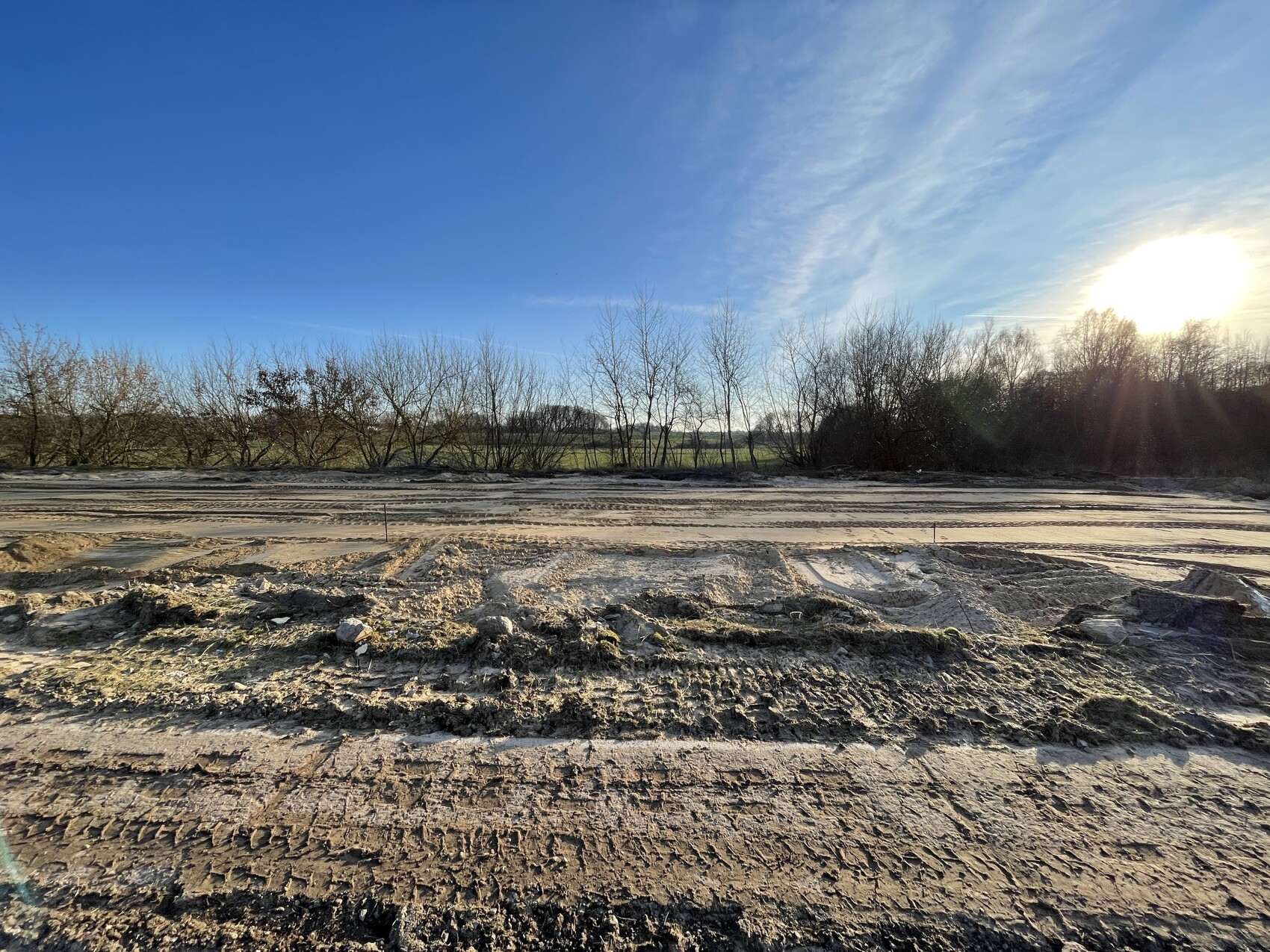

Here is a photo from today of the property, looking south. The two poles (if you can see them) roughly mark the start of a 9.50m (31 feet) wide house... just wanted to get an approximate sense of scale.

WilderSueden
16 Jan 2021 20:27
I can’t say if that will be enough—I’m not that far along yet. All I can tell you is that I’ve doubled my budget and decided to skip the basement. Slowly, though, things seem to be stabilizing.
