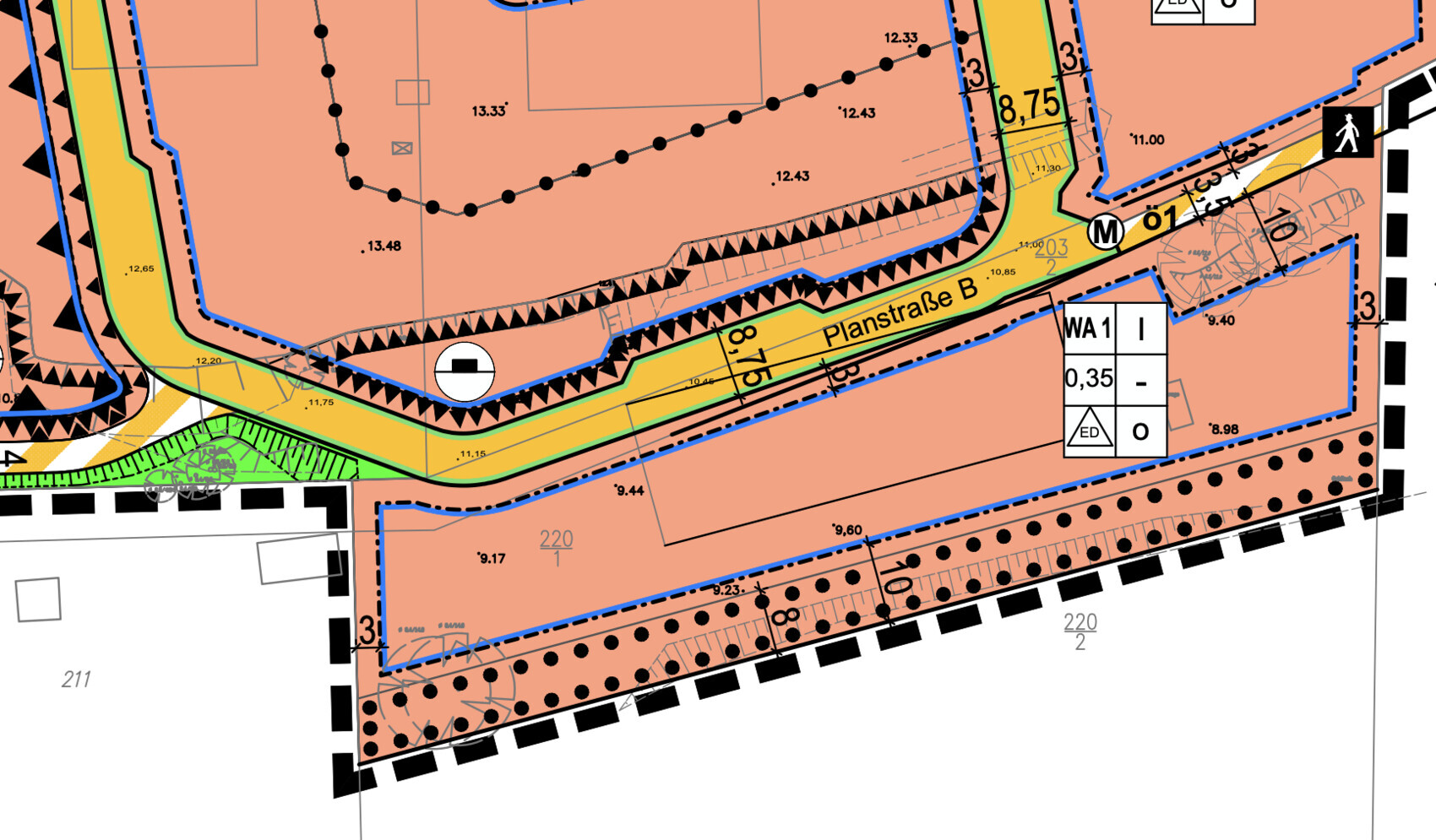

News – and a question has come up that I can't figure out on my own – it would be great if you building plan experts could explain the following to me:
Above "Plan Street B," there are these jagged lines pointing outward. The light gray lines below show an existing embankment on the site. According to the explanation, the jagged area means:
"On the areas for embankments, the surface of the plots shall be adjusted by filling to match the heights of the adjacent traffic areas."
Filling. So, they intend to build up the ground here – which makes sense. However, I don’t understand "heights of the adjacent traffic areas." According to the image, the ground level in the upper part of the road is currently 12–13 meters (39–43 feet), then comes the road, and below that is "my" plot – currently at 9.40 to 9.60 meters (31–32 feet).
Does this mean the road will be built at a higher level? Only then would there be a need for filling for plots north of the road to reach the adjacent traffic area, right? Would my driveway then be quite steep going up to the road? 😉
I hope you understand what I mean... Is my plot significantly lower than the road that will be built there? And if so, is that at least an advantage in terms of the permitted eaves height? This is set as follows:
"Maximum 4.50 meters (15 feet) – the reference point for the height of structures is the height of the fully developed traffic area adjacent to the plot (top edge of the traffic area according to the plan drawing), always measured at the middle of the plot’s access driveway."
Or am I completely misunderstanding all this?

I don’t see anything clear here. The actual elevation points in the planned road area vary too much to leave them uneven like that. However, I cannot tell what the target elevation should be. In the jagged area, it seems that the ground level of the properties will be adjusted to match the road height, somewhat similar to hedge height restrictions at visibility triangles. My assumption is that the properties south of planned road B will still be lower than the road even after its completion.
