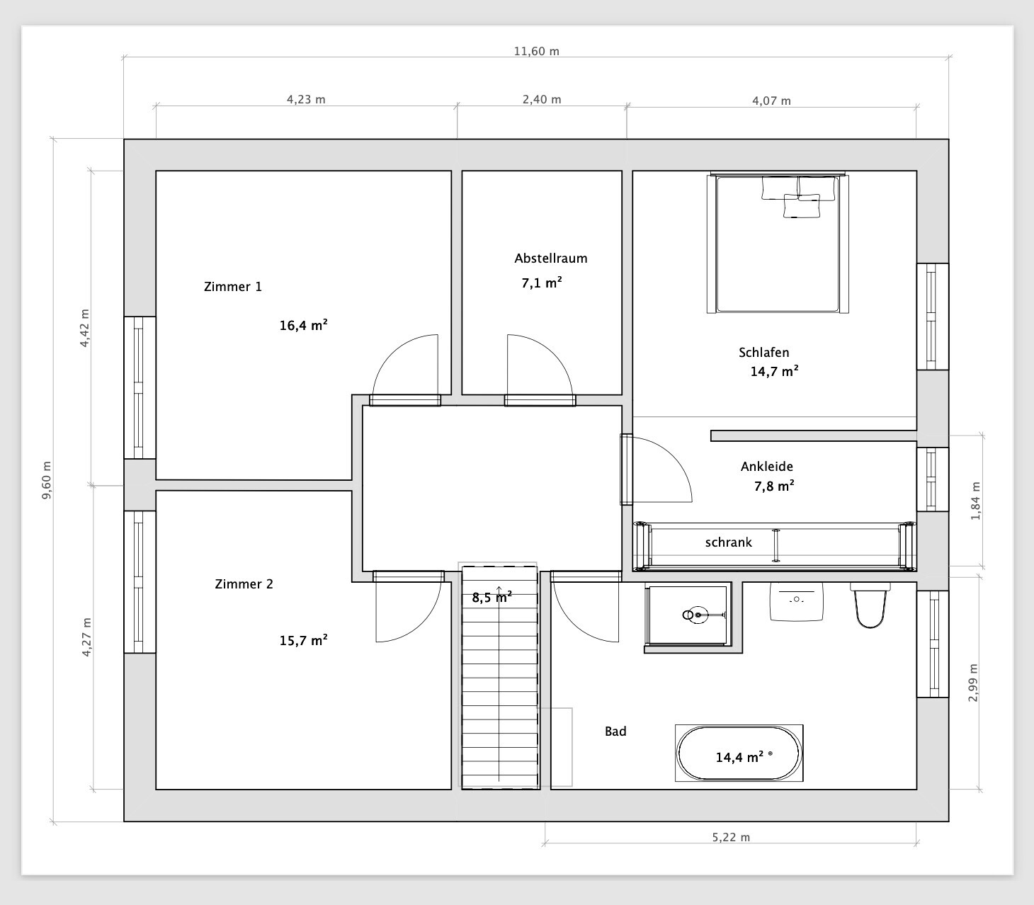

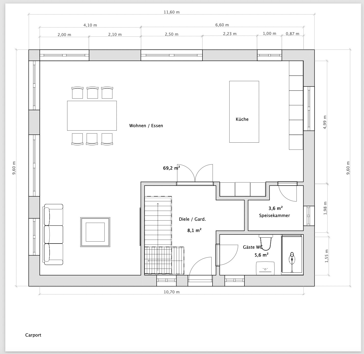

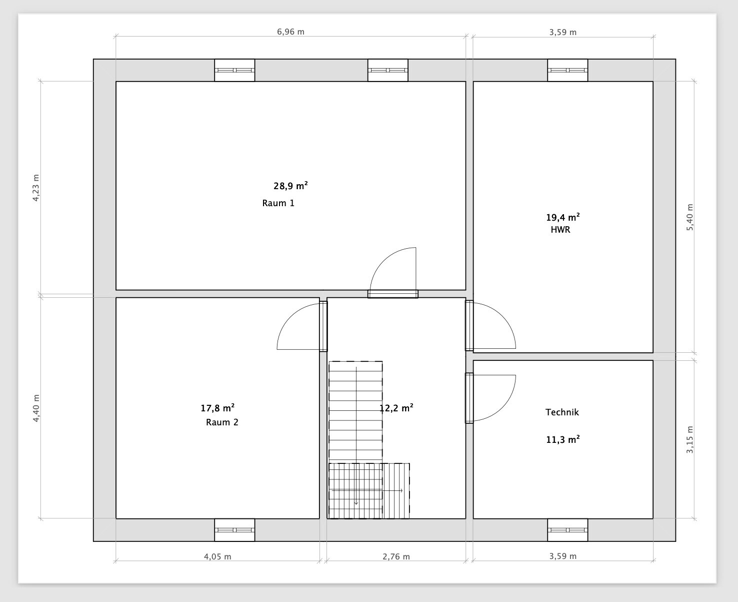

Here is a brief update:
- Now 9.60 meters (31.5 feet) wide, which is very helpful for the upper floor; the bathroom should fit with the 2-meter (6.6 feet) line, etc.
- We decided to skip the upstairs office. There are currently two of us, so we have enough rooms. Even if that changes significantly (;)), the basement offers plenty of space, and I am leaning strongly towards a ceiling height of 2.33 meters (7.6 feet) there, which would be quite usable.
- Instead of an upstairs office, there is now a storage room (maybe still too large?). This solves the problem of light exposure, and the vacuum cleaner needs a place too...
- The windows on the plan are far from final—so far, they have mostly been placeholders without exact measurements, which also leads to inconsistent spacing between them, etc.
- The pantry is actually more like a general storage room for all sorts of things...

The staircase is too short. But there is still some room for adjustment. The hallway upstairs will simply be recessed.
Where is north?
Personally, I would avoid a staircase with a landing in the entrance area, which is often sandy, if there is an option (meaning more space than 55/60 sq.m (592/646 sq.ft) on each floor).
