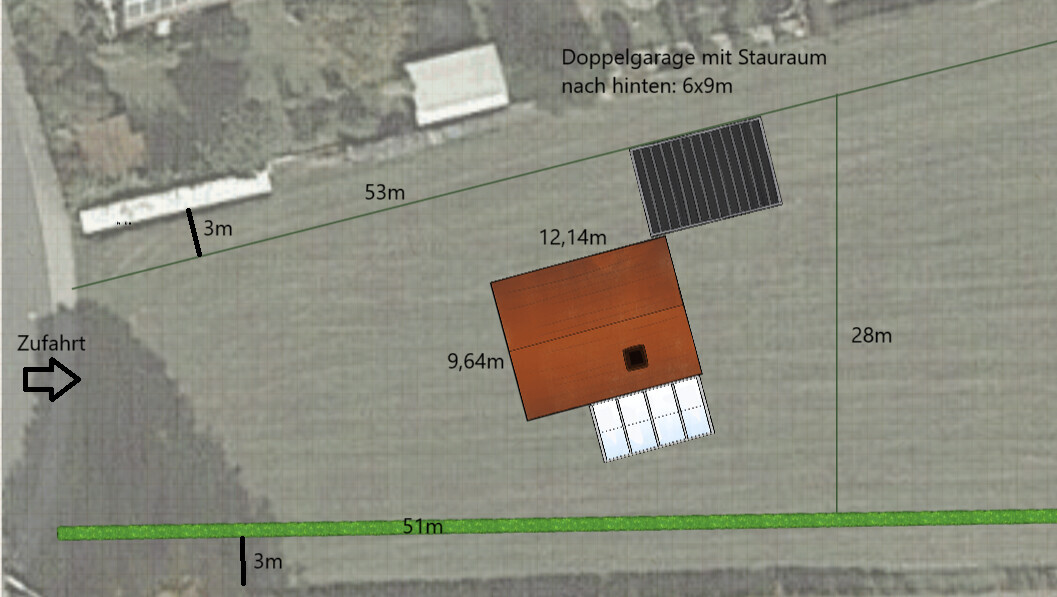

We are having some difficulties with the site layout and I wanted to ask for advice here:
The plot narrows towards the street on the west side, and we would appreciate any tips, suggestions, or ideas on how to best arrange the house, garage (or possibly a garage with an attached carport), and terrace to have the best possible south- and west-facing garden.
The land slopes about 1.5m (5 feet) from north to south, but we plan to level this with retaining walls using L-shaped concrete blocks, which our neighbors are also considering along the southern boundary. A 3-meter (10-foot) setback is required on both the northern and southern property lines for hedge maintenance to the south and as a path to the north.

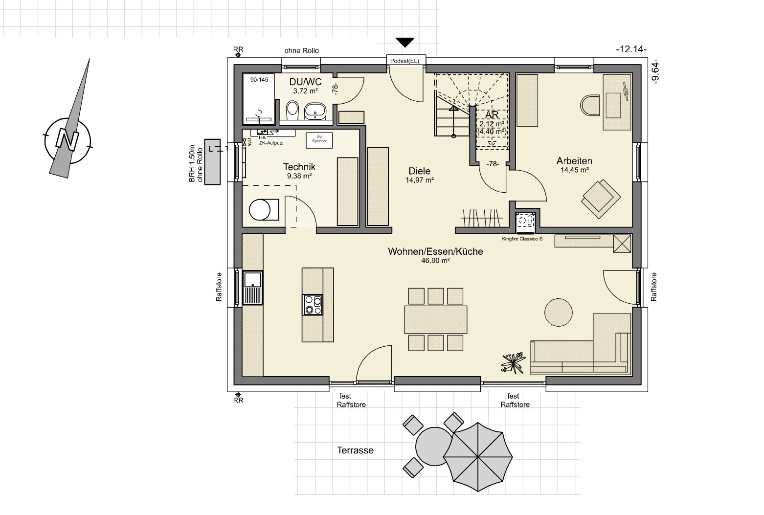

The house measures 12.14 x 9.64m (40 x 32 feet), and we would like a double garage including storage space of 6 x 9m (20 x 30 feet), preferably close to the house or even attached.
The first draft is attached and can still be modified spatially.
Please disregard zoning plans and permits for now, as these will need to be applied for individually.
Could any creative minds please provide some suggestions or ideas on how we might design this?
As I have drawn it, it would require a lot of paving, which would be okay if necessary.

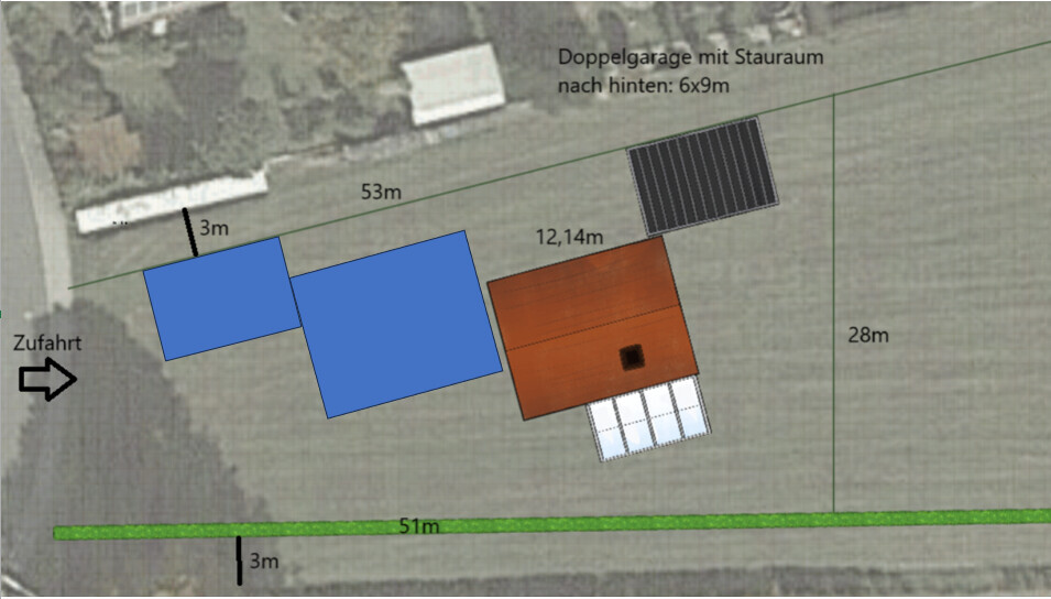

Thank you very much for the responses!
Perhaps I shouldn’t have sent the drafts along, as they are just rough layouts mixed together and, as mentioned, will still be changed.
My main concern is how to best arrange the house (with photovoltaics), garage, terrace, and garden on the plot.
We might purchase the building plot and currently have no idea how to most efficiently place the items mentioned. We will probably need to consult an architect in advance after all.

Tip: Draw the property to scale and create templates for garage/carport (per parking space 3 x 6 meters (10 x 20 feet)), house (approx. 10 x 12 meters (33 x 39 feet)), and terrace (3.5 x 5 meters (11.5 x 16 feet)) and move them around yourself. Read the state building regulations and the zoning plan beforehand.
