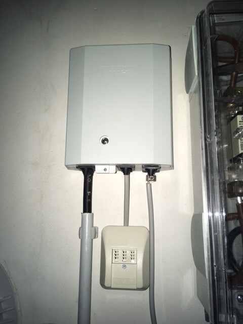

Attached is a first look at our main distribution frame (?) in the house connection room in the basement.
What we have:

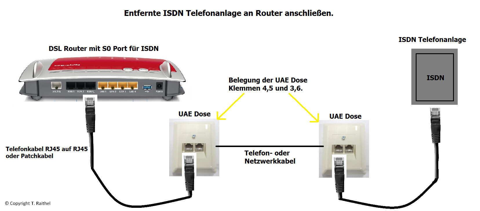

This is about ISDN, but the principle is the same...just imagine the picture showing a telephone instead of an "ISDN telephone system." The telephone outlet boxes (UAE sockets) would then be one port on your patch panel and one RJ-45 socket (LAN) somewhere in the house.
DSL router with LAN cables and ISDN connection in the home network

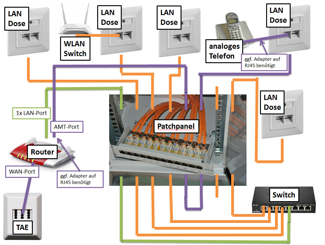

I tried to illustrate my understanding graphically:
Network overview: patch panel, switch, router, LAN outlets, analog phone, many cables.
Mycraft2 May 2017 08:50
Yes, this is still not 100% exact but it’s very close to what you ultimately want.
