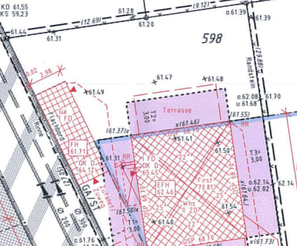

Henrik081712328 Jul 2017 08:44I already explained this... aligning with the neighbors means that our garden will need to drop by 1 meter (3 feet 3 inches) over 10 meters (33 feet) because the house exit is 1 meter (3 feet 3 inches) higher than the fence, and there are 10 meters (33 feet) to that fence since the property slopes downward and the house is positioned relatively high.
I can gladly create and share a sketch, which will probably help more.
I wonder who might know me from where and draw conclusions from that. So far, no one has been able to answer my question about what options are available when the neighbor’s fence is already in place and we are overall x centimeters (x inches) higher, but want to slope down to the fence or go directly up to it, and what can or must be done in such a case.
Edit: Attached is an excerpt from the site plan with elevations. The finished floor level of the house is at 62.46 meters (205 feet), we step out on the level, so the terrace is at the same height, and you can see that the neighbor’s property is about 1 meter (3 feet 3 inches) lower. We want to avoid steep slopes or embankments as much as possible (except directly in front of the fence combined with a hedge, so that it’s practically hidden) – here I’m missing good options.
From the terrace, of course, a “hard edge” and a staircase down, but we don’t want a 1 meter (3 feet 3 inches) drop there; rather, we want to raise the ground slightly so that, on the one hand, the existing soil can be reused and, on the other, we don’t have a 1 meter (3 feet 3 inches) or more difference in height between the lawn and the terrace.

Henrik081712328 Jul 2017 10:46Who ever said that we want the fence to be 1 meter (3.3 feet) above the neighbor’s property? It’s funny to say that no one is helping me here, and then twist my question and base a ridiculous answer on that.
That’s it for me here – what’s the point of a forum if you always have to turn to others? If everyone did that, the forum wouldn’t exist – so people who think like that about forums should just stay away – it’s the easiest solution, right!?
If a property slopes down towards the neighbor, it’s obviously clear that their land ends higher than the lower neighbor’s. This shouldn’t be so hard to understand, and the attached sketch should have made that clear to everyone.
