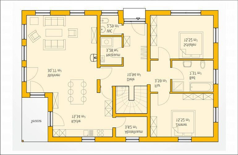

we are currently planning an L-shaped bungalow with the following details.
--> It would be great to get some critical feedback on our current (own) design (Image 1).
This design is based on the Town & Country Perfect 111 bungalow (see Image 2).
Due to the specified roof pitch and roof shape, there will likely be an attic space – so far, I am unsure what the best use for it might be.
Thank you very much!

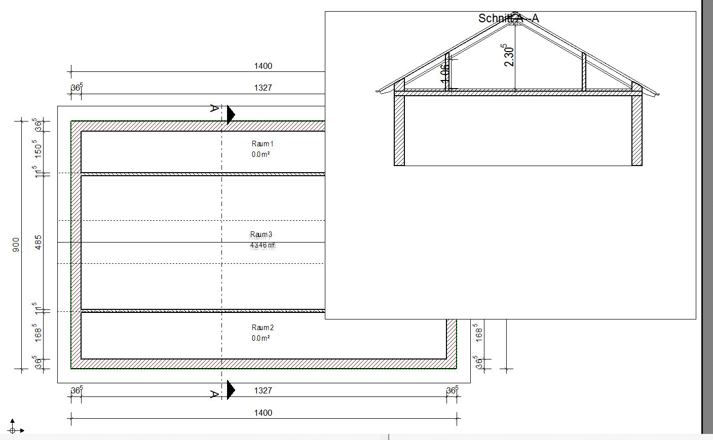

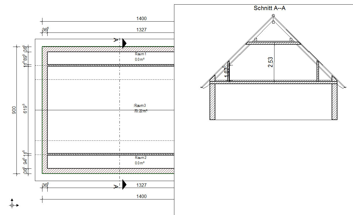

What Yvonne means is that a usable space is created in the upper floor anyway due to the gable roof. Even with a 30° roof pitch and a knee wall height of 0 cm (0 inches):
You can get over 70 sqm (750 sq ft) at 45° and 0 cm (0 inches), even creating a small attic space.
However, I think that with 30° on an L-shaped design, it won’t work because the connection of the L will not fit properly.

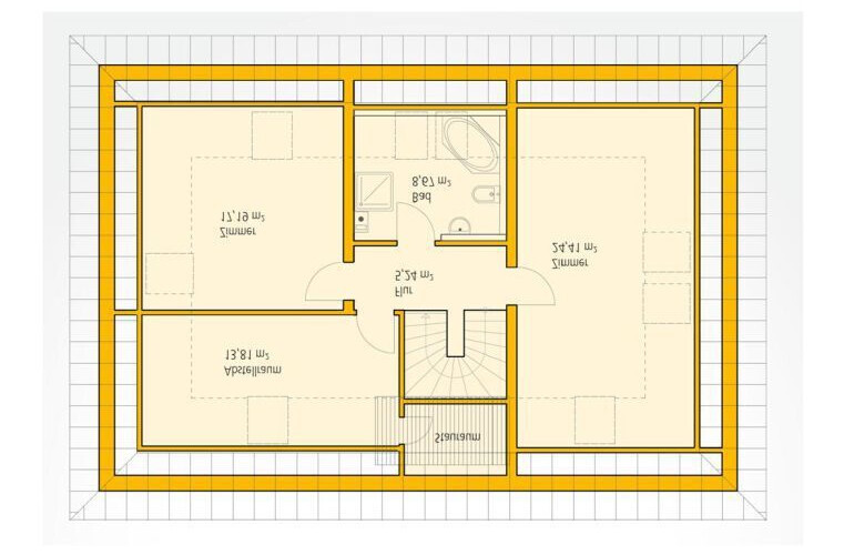

The Ytong floor plan I showed is also available as a version with stairs. Here it is mirrored for your plot, with a high hip roof shown.
It would be conceivable to have only one child’s bedroom on the ground floor for now and definitely the stairs and provision for a small bathroom upstairs. Then you could initially just add a few walls upstairs and use the space as easily accessible storage. @Nordlys also made their attic area accessible by stairs for storage use.
If a second child comes along, the children can move upstairs. A guest room or office can be created downstairs. When the children eventually move out, the parents could, for example, set up two bedrooms downstairs or use one as a spacious dressing area. Upstairs there is always space for visiting children, grandchildren, etc., and, of course, storage.

The Ytong floor plan I showed is also available as a version with stairs. Here it is flipped for your plot, and the roof is shown as a high hipped roof.
So it’s conceivable to currently plan only one child’s room on the ground floor, definitely include the stairs and prepare for a small bathroom upstairs. Then you can initially add just a few walls upstairs and use the rest as easily accessible storage space. @Nordlys has also made their attic accessible by stairs for storage use.
If a second child comes along, the children can move upstairs. A guest room or office can be created downstairs. When the children move out someday, the parents could set up two bedrooms downstairs or use one as a spacious dressing room. And upstairs you always have space for visiting children, grandchildren, etc. Plus storage space. Very generous of you to illustrate that graphically. Thanks for that!
We will actively plan to use the attic as storage space (and possibly as an "emergency reserve") since we are opting out of a garage and basement and planning "only" around 120 sqm (1,290 sq ft). An updated design from the architect will follow.
kbt09 schrieb:
It would be possible to have only one child’s room on the ground floor at the moment, along with the staircase and provisions for a small bathroom upstairs. Then you can initially just add a few partition walls up there and use the space as easily accessible storage. @Nordlys has also made the attic area accessible by stairs for storage use.I would follow this plan... and then you have to consider what exactly you want to store there. If it’s quite a lot, without a proper staircase it’s basically “putting it on the sidetrack,” only to realize three years later that you just stored things without really using the space. That’s why we always recommend including actual furniture layouts in all plans and always visualizing the resulting daily workflows.Similar topics
