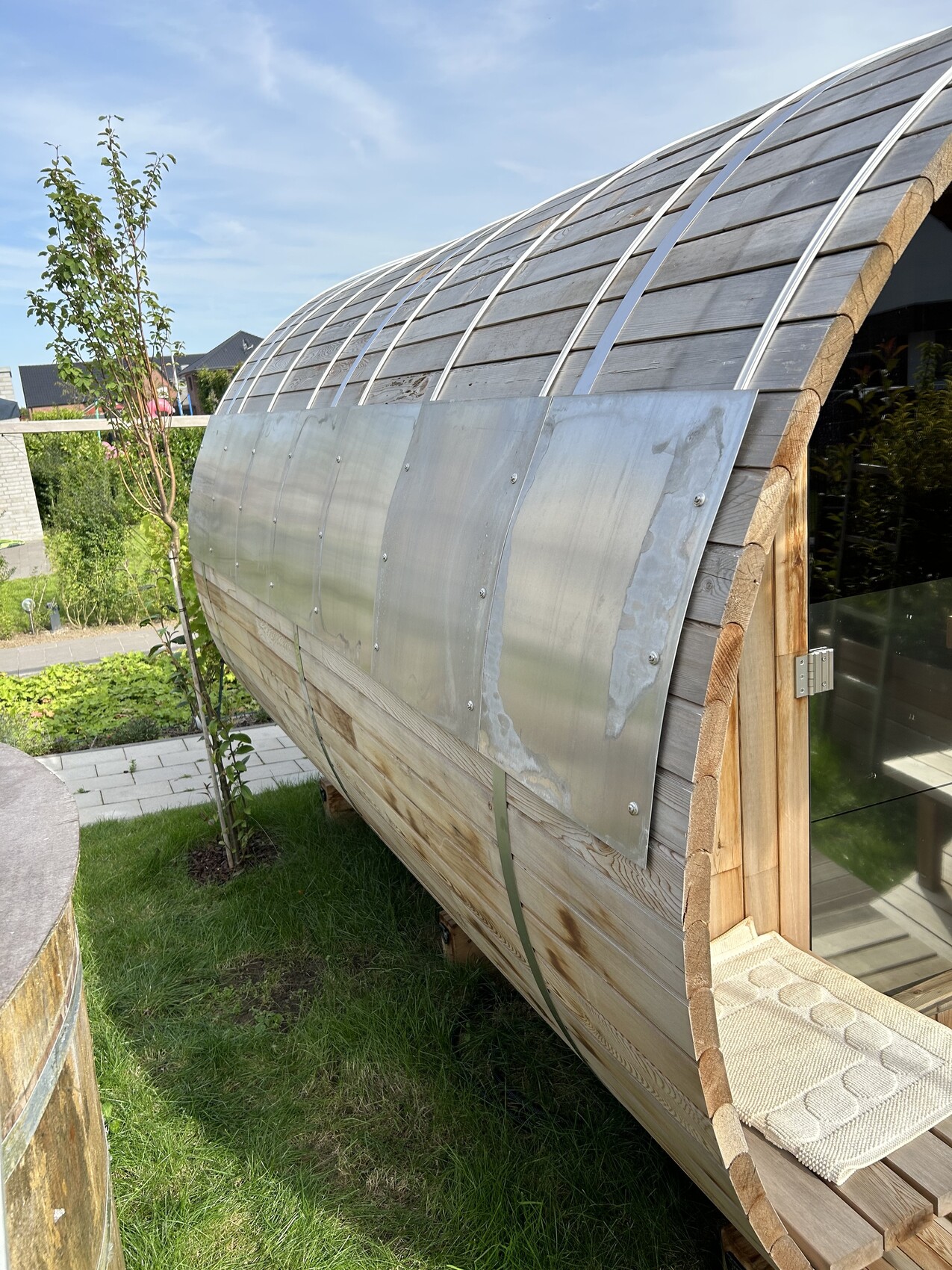

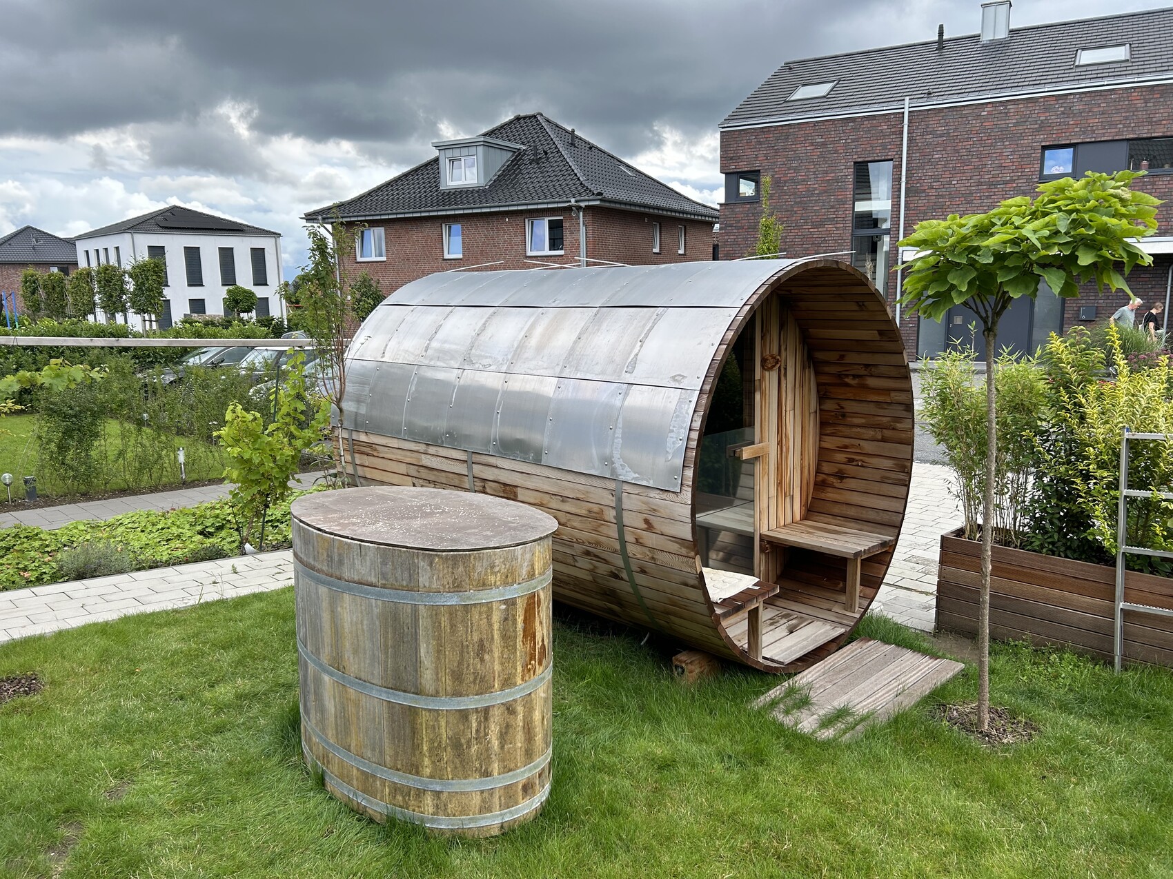

In the end, I had to make a compromise with the roof since no roofer provided me with a quote. Using 56 aluminum sheets about 45x55cm (18x22 inches) each, a pack of metal screws for roofing, and 16 covers from small cable ducts, I have now installed the roof myself. Only the top row (8 sheets) and some finishing touches like additional screws and edge trims remain.
The holes are, of course, made slightly larger than the screws so the sheets can move a bit. The plastic strips create some space between the metal and the wood for ventilation.

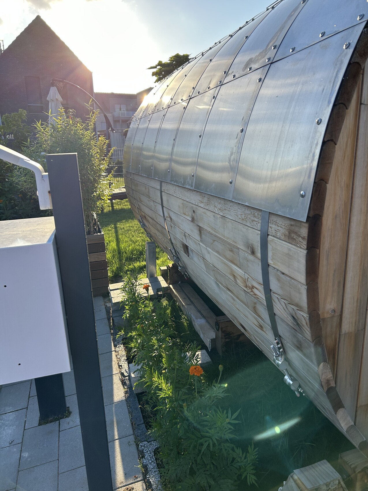

Well, respect your opinion. But that’s not corrugated sheet metal; besides, the metal is matte, not shiny polished (it’s also roughly sanded).
I would have preferred wood too, especially since cedar can actually be used for that. But due to the design, it’s not waterproof, and having a sauna constantly soaking wet isn’t a solution either (risk of mold inside).
And: the Zugspitze picture had a bitumen roof... Do you really find that more attractive than aluminum sheet?
For me, that was a no-go. Curved standing seam aluminum sheet metal (my preference) unfortunately couldn’t be offered by any roofer nearby and would have ended up costing over 2,500 EUR (around 2,600 USD) if installed DIY, which I currently don’t consider worthwhile.

So, the roof is now watertight and all the screws are in place. Only the sanding work remains, and I also want to finish the edges neatly.
