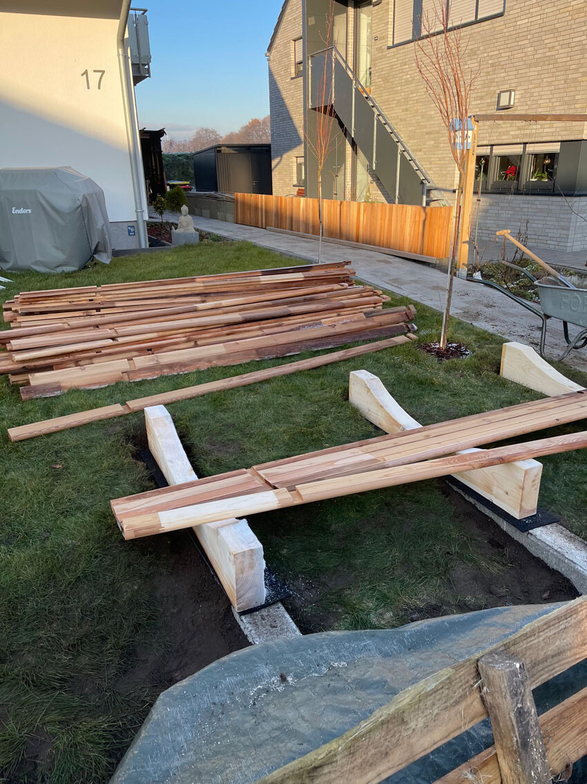

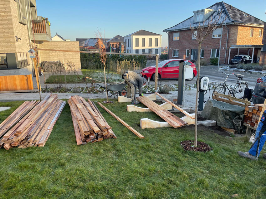

So, today the work finally started 😉 A few hours spent sorting the wood in beautiful sunshine but bitterly cold weather, leveling and installing the foundations (concrete lintels). Then, we began with a few boards. The progress is already a bit further than shown in the picture, the two partition walls are already standing.
Work will continue tomorrow at 8:00 a.m. ...

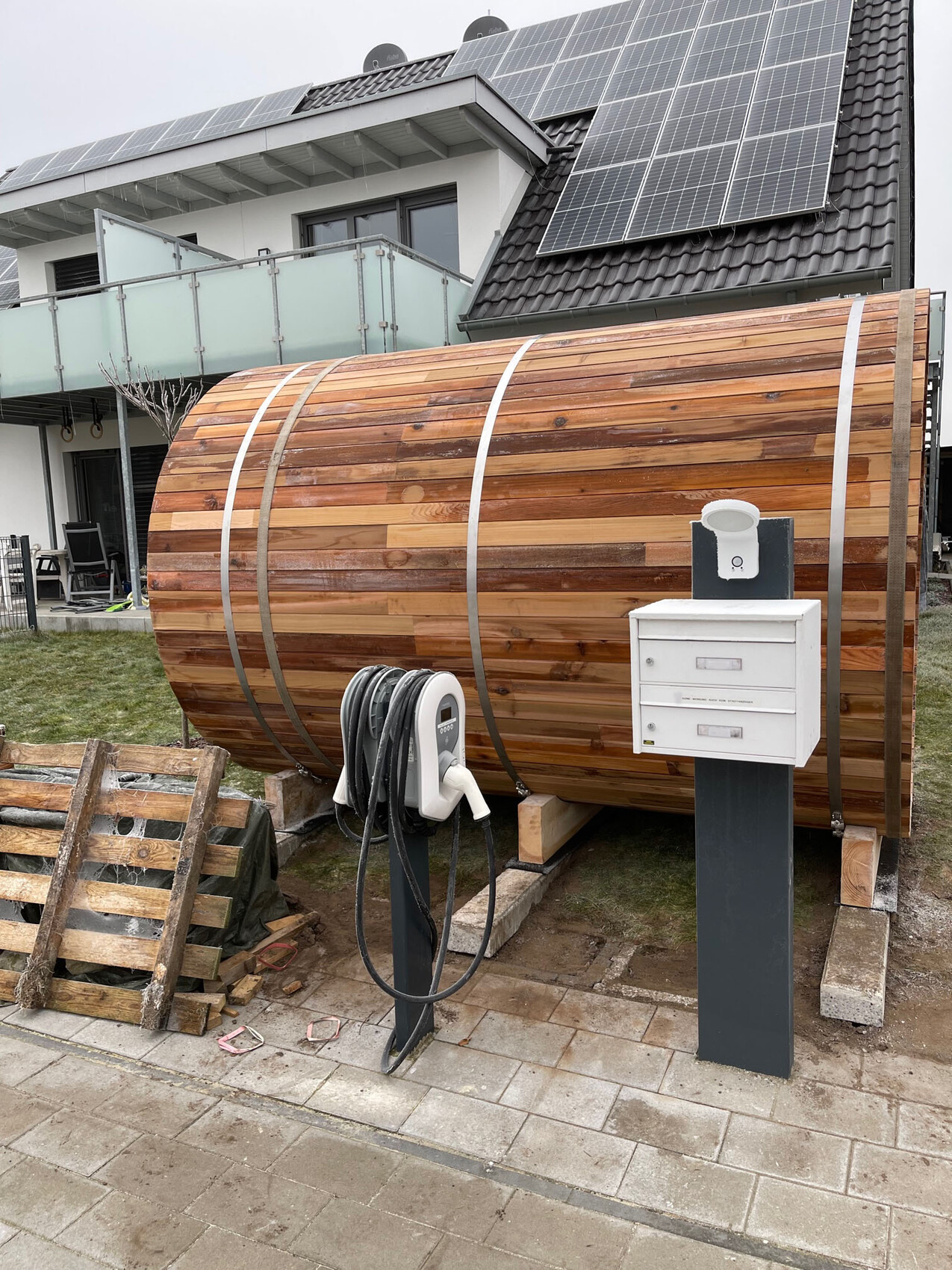

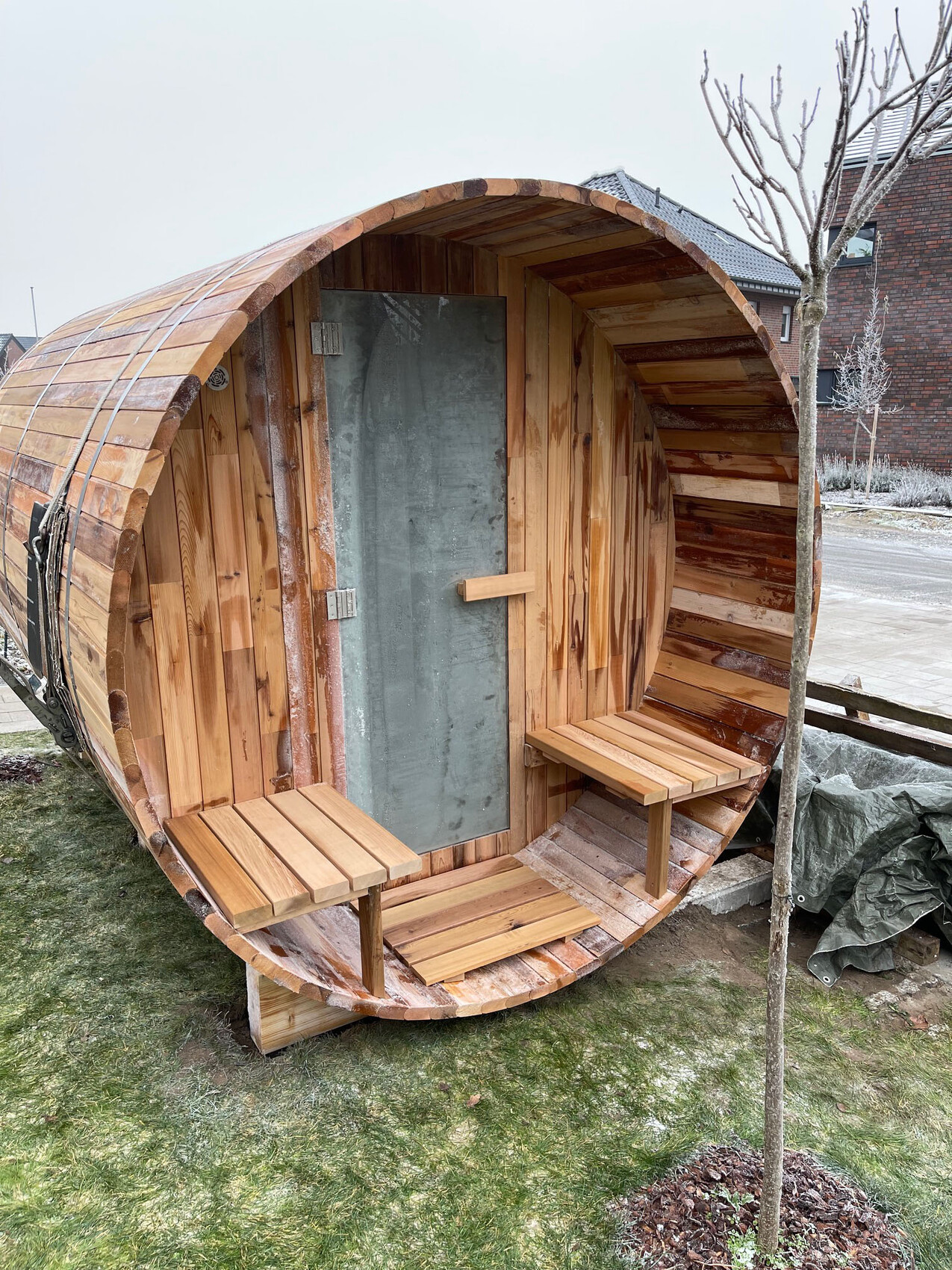

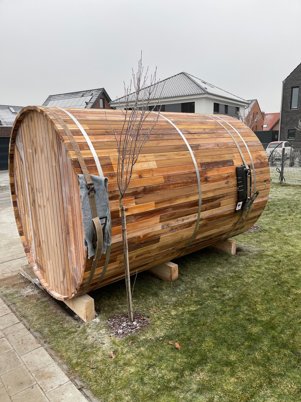

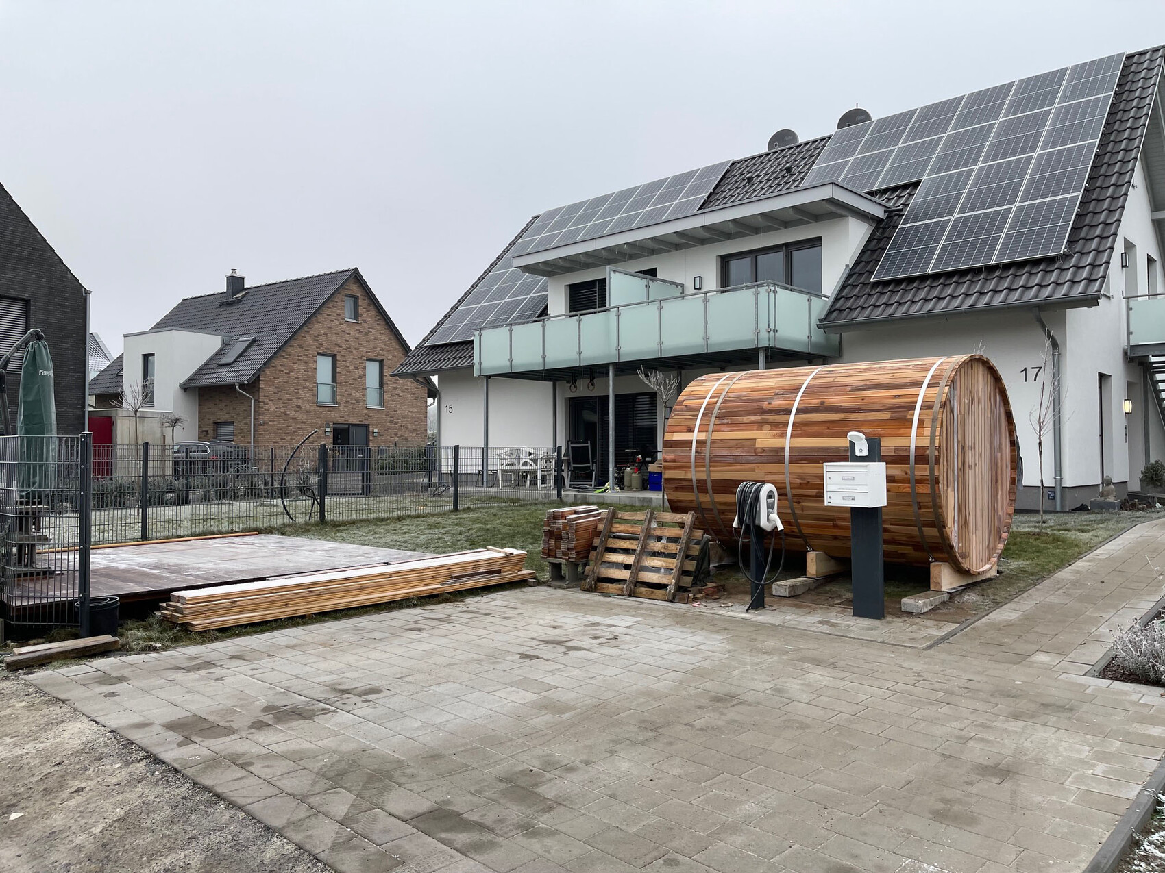

Myrna_Loy17 Dec 2022 14:22I would relocate the small tree; otherwise, there could be issues with moss growing on the sauna. Alternatively, the tree might suffer during the coldest winter due to the unexpected residual heat.
Myrna_Loy schrieb:
I would relocate the small tree; otherwise, there could be issues with moss developing on the sauna. Or the tree might suffer during the coldest winter due to unexpected heat emissions.I’m afraid you’re right. We noticed the same thing yesterday, and I will probably do it next year. Maybe the tree will simply be placed next to the sauna, at some distance from the other small tree. The upper half will probably still be covered with a metal cover. M
Myrna_Loy17 Dec 2022 14:33I thought that depending on the orientation, shading from the crown and foliage would make the seating area easier to green. I might plant bamboo or another tall grass there.
Benutzer 100117 Dec 2022 15:06This piece would also look great in our garden, especially right now—minus 5°C (23°F) and 15cm (6 inches) of snowwwww
