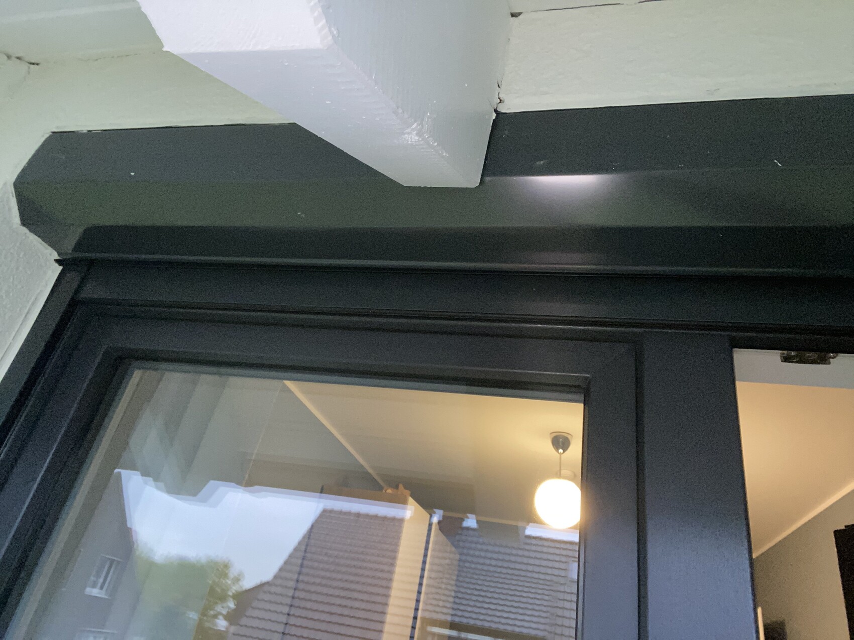

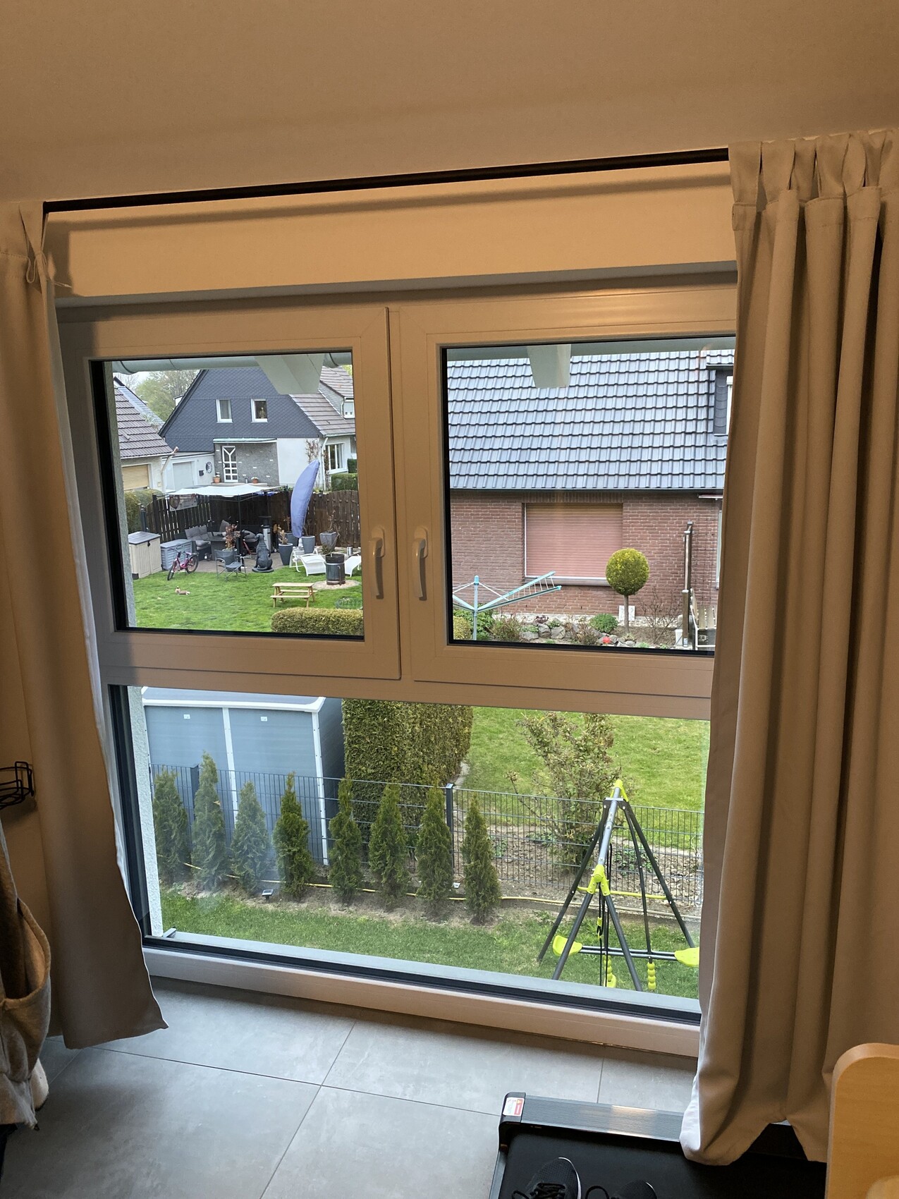

dobbelhaus25 Sep 2019 22:21It is a 15m² (approx. 4.2 x 3.5m) children’s room with only one window. Fortunately, this is the only window that is not high enough due to the roof slope. I visited the window manufacturer today, and he suggested using a front-mounted roller shutter box that is only 15cm (6 inches) high and can be installed directly under the rafters, instead of the more common top-mounted boxes that are 30cm (12 inches) high. This way, the visible area at the highest point will be about 160cm (63 inches). The window frame and other components will start above 160cm (63 inches).

I’m no longer active in this forum but just received an email about your post. We installed the window in this room exactly as I described in my earlier post. It worked quite well, and the result isn’t bad at all. Take a look at the photos.
