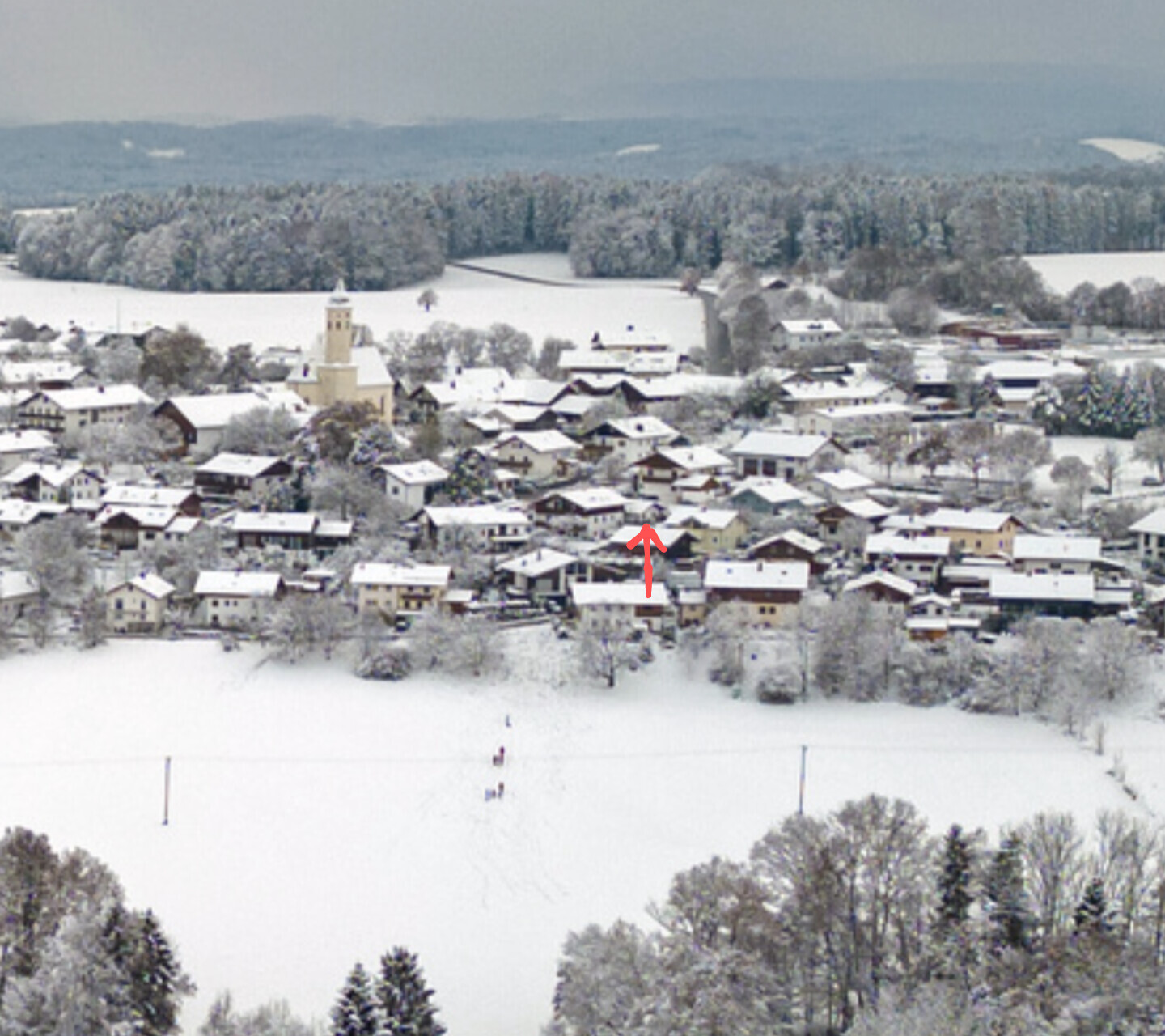

we are currently planning an extension on top of our garage. This addition will be connected to the first floor of the existing building and is intended to provide enough space for my soon-to-be family of five on one level. We were actually ready to submit the plans. However, some neighbors have given me their “expert advice” during the signature collection, which made me reconsider. The background is that in the new construction we will have a knee wall height of 2.07m (6 ft 9½ in), resulting from a similar gable height and a 22° roof pitch like the existing house. The orientation will also remain north/south as in the existing building.
Now to the “problem”:
After subtracting the ring beam/joist, I think the windows facing north/south will have a maximum height of 1.70–1.80m (5 ft 7 in – 5 ft 11 in) below the eaves. Together with the roof overhang, I fear the view will basically be directed downward, which would be a pity given the otherwise magnificent distant view. To overcome the roof overhang at the terrace door, our draftsman has drawn in a dormer at the hallway height. Access to the garden was important to us.

hanghaus202313 May 2024 14:54Does the surrounding area allow for such a tall building? How high and large are the neighbors’ buildings? An aerial photo with at least a 100 m (330 ft) radius can help with the assessment.
hanghaus202313 May 2024 17:42If the garage does not violate any setback regulations, in my opinion, you can use the neighbor’s example as an argument. Is there a cadastral plan available for the affected neighborhood?
