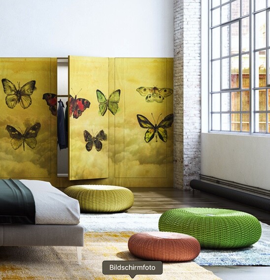

In my opinion, the most impressive solutions are offered by the Italian door company Linvisibile – I once cut out a promotional photo showing one of their doors open.
It gets a bit more expensive if you want to optimize the door gap.
