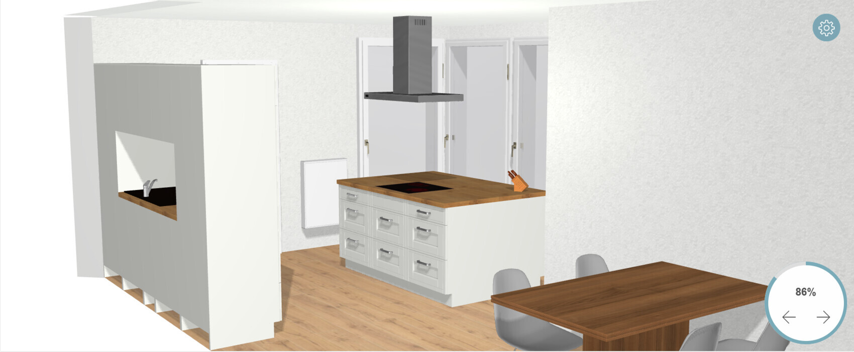

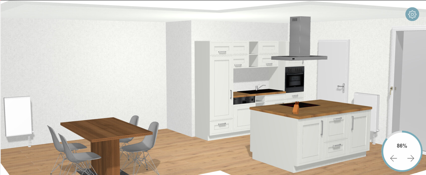

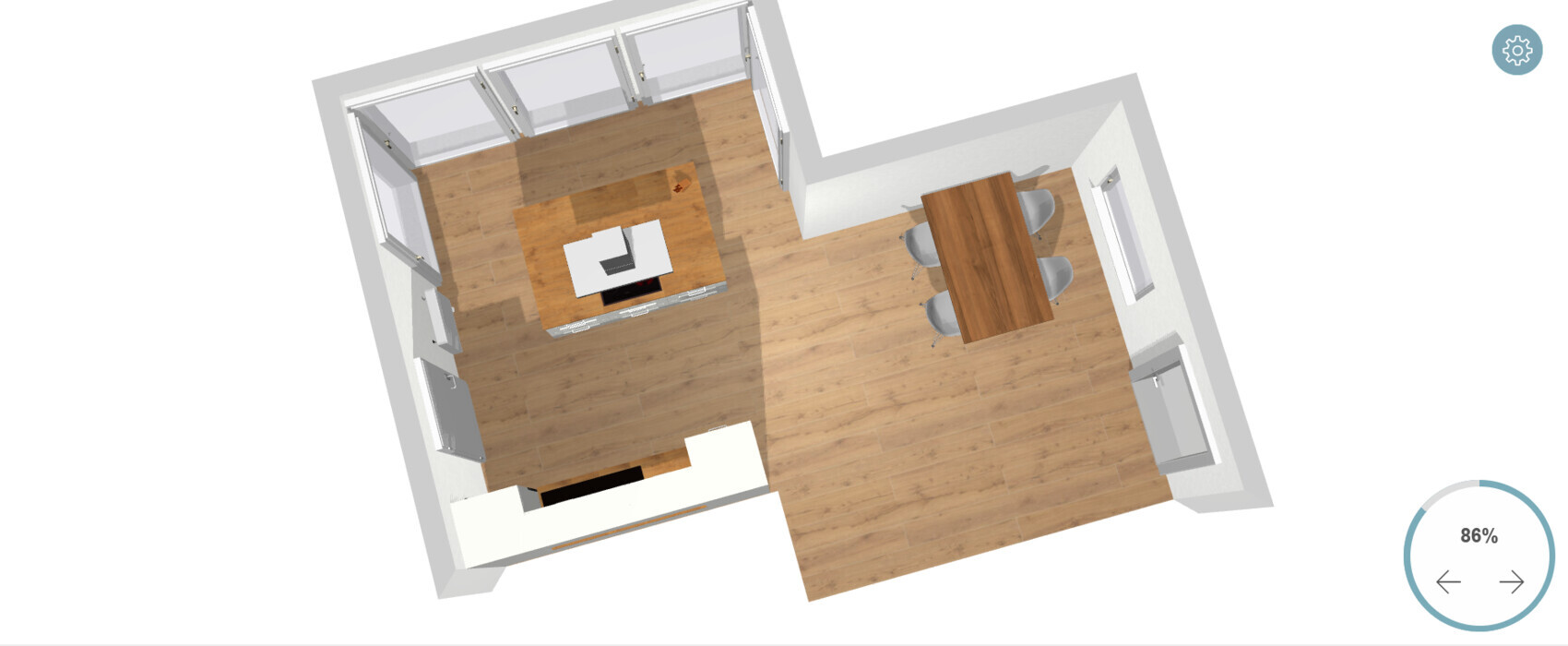

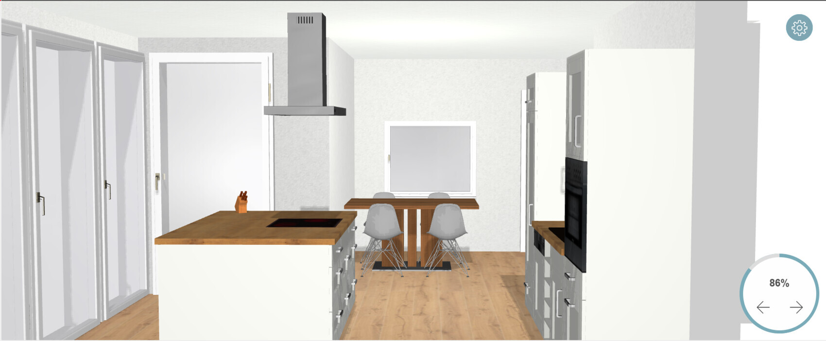

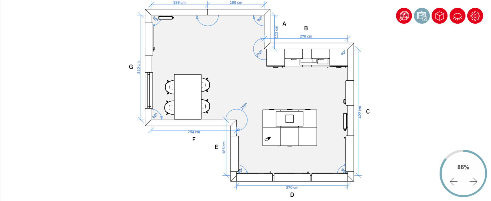

we have now developed a concept for a kitchen design and would like to gather additional opinions on the layout.
The kitchen will be relocated to a new room, and connection points are already available.
What do you think about the kitchen layout? Is there anything in particular to consider when planning a kitchen island?
- No suitable workspace
- Why have open compartments where dust accumulates, like in US kitchens?
- 1-2-2 grid layout – waste of storage space
- Ikea is not necessarily cheap – sometimes a kitchen from a small local kitchen studio is more affordable and offers much more flexibility with the cabinets.
I’m not really satisfied with the overall design.
- You have very little countertop space. Don’t you want to place anything on the work surface?
- In my opinion, the layout doesn’t make the most of the kitchen. There’s a lot of unused area... Where does the door next to the tall cabinet wall lead to? And why is there any change of rooms at all?
- Visually, I don’t think the farmhouse style fits well with this modern niche wall, but maybe it looks better in real life.
- How wide is the gap between the countertop run and the island? In my opinion, it shouldn’t be more than 120 cm (47 inches).
- Have you done a proper storage plan to decide where everything should go?
Myrna_Loy14 Sep 2022 23:00You gain countertop space by placing the stove where the sink is currently located. This way, you can also easily install a range hood just above it. I would suggest positioning the oven conventionally below the stove, which will free up workspace to the left of the stove. Wall-mounted ovens are currently popular but aren't always the best solution. Honestly, how often do you take out a 30-kilogram (66-pound) roasting pan with a goose that you absolutely need an ergonomic working height for? Unless the plumbing cannot be routed to the island.

However, I can still view and read the new post. There is much more information there than here, but the hand-drawn sketch doesn’t even show which “corner” is being referred to.

Personally, I’m not a fan of this new design style with the narrow countertop plus tall cabinets on both sides. But that might be a matter of taste. To me, it feels cramped on the left, right, and above. Even if it isn’t ergonomic, I would have the kitchen wall continue around the corner further back. However, it is nowhere mentioned or visible what exactly is located at that corner. The drawing shows the corner as closed, including the area where the access to the living room might be. There is supposed to be a utility room, but where is it?
