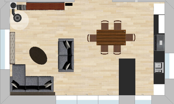

After extensive discussions, we have ultimately decided against an L-shaped kitchen layout. This now leaves us with two different options for the kitchen island. What are your thoughts on these two variants? What advantages and disadvantages do you see for each?
Details:
- No door between the hallway and the room, only a 2m (6.5 ft) wide passage with a lintel
- Dining table size: small variant 2m (6.5 ft), medium variant 3m (10 ft), long variant 4.5-5m (15-16.5 ft)
- Distance between the kitchen run and the island: 0.95m (3 ft)
- The window on the right side of the plan should not be moved; patio doors could be shifted if absolutely necessary
- Kitchen run layout from top to bottom: oven, stove, dishwasher, sink, freezer, refrigerator
Why choose a kitchen island at all?
1. More countertop workspace
2. Additional storage is needed
3. At least a partial separation between the kitchen and the rest of the room
Variant 1 – island at the top of the plan:
- The dining table is closer to the windows, which might be more pleasant
- The main workspace is far from the refrigerator, sink, and trash bin, so it might not be used as intended
- The first thing you see from the hallway is the kitchen island (which doesn’t feel very welcoming to me)
- Good amount of open space when entering the room
- Table and chairs partially block the patio doors, making opening and passing through inconvenient
Variant 3 – island at the bottom of the plan:
- The dining table seems more accessible, also due to the permanent opening to the hallway
- The dining table is about 2.5m (8 ft) away from the patio doors
- Opportunity to set up a very long table for celebrations

kbt09 schrieb:
Regarding the sink… you don’t wash everything by hand, only a few items now and then, so you get used to the drainer being oriented differently.
Our requests are not being considered with this:
1. A certain visual and perceived separation between kitchen and living area
2. Not having to be seated entirely within the kitchen
3. Placing dishes to the left side
4. Keeping the kitchen window in its current position
Instead, we have gained plenty of space for moving around, which we definitely did not ask for.
kbt09 schrieb:
…I already mentioned [URL='https://www.hausbau-forum.de/threads/Grundriss-160m-Bungalow.13566/page-4#post-129511']that 850 cm (28 feet) width is a rather inconvenient dimension
Yet the room has this dimension and it cannot be changed.
That’s why I’m asking if there are possibilities we don’t know about without having the floor plan.
Unfortunately no, but there is always the option to furnish more economically.
Floor plan of an open living and dining area with dining table, sofa group, and kitchen line.
DragonyxXL
13 Oct 2016 15:49
Bamue89 schrieb:
Or rather, the passage position does not allow for a comfortable arrangement of the dining table. Is this an urban villa? Regards
The problem is not entirely clear to me. Either we are sitting at the table eating, so that no one has to constantly pass through, or the chairs are pushed in and we can move around everywhere.
It is not an urban villa, as matte1987 pointed out.

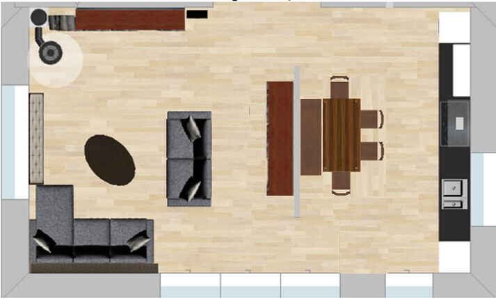

L
Legurit
13 Oct 2016 18:38
To be honest, with this floor plan, I would draw a wall about 2.5 meters (8 feet) long, two-thirds the height, centered vertically. I would place the dining area with a bench against that wall. I would skip having a counter.

Bamue89
13 Oct 2016 20:16
No problem at all. It just has to be to your liking. I meant that the room is accessed from the center, and the table will inevitably be positioned along that line of sight in every layout option. Or am I wrong? I’ll need to take a closer look at the floor plan on the computer later. Best regards
