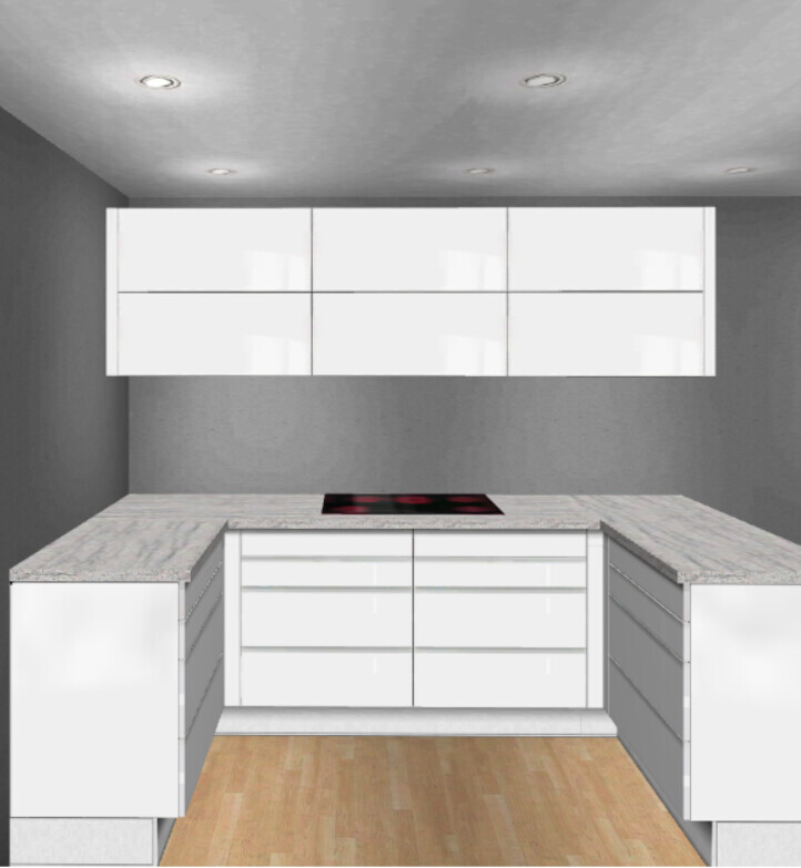

We have now completed the kitchen planning (see photos). Only the colors are still missing. The floor will be wood-colored tiles. Appliances: Bosch oven and dishwasher, Elica Tesla Switch induction cooktop (nothing else was available 🙂 ), LG side-by-side fridge/freezer, Eufy robot vacuum that can go under the island from the side. The countertop is ordered; it will be natural stone with a marble look (see photo). Now the question about the cabinet colors. We mostly want gloss white lacquer. The wall with the side-by-side fridge should be different. Either the color of the floor (photo attached), anthracite, or also gloss white lacquer? 🙂
Do you perhaps have similar kitchens and could share some experiences/photos?

Bertram10015 May 2022 08:16I think the kitchen layout is poorly planned. The counter is uncomfortable next to the long cabinet, there are few drawers, and the dishwasher blocks the way when it’s open. For me, neither the layout nor the color scheme would work.
Keep in mind that white, even though it is neutral, stands out more than muted colors.

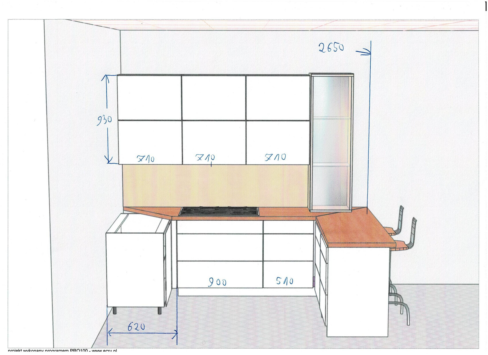

Does anyone understand this drawing?
In the 1990s style kitchen, there is an 80cm (31.5 inches) cooktop centered, but no matching hood above it? Why are the dimensions so odd when it could be simpler?
Maybe a hood above the cooktop? So, everything will still be adjusted. The induction cooktop comes with a downdraft ventilation system including recirculation.
We have now decided on option d) 🙂 The lower cabinets on the wall with the sink and the one with the induction cooktop will be in wood tones. Also on the side of the island where there are no stools. Separation from the floor will be done with a white baseboard. We will receive the revised plan including costs tomorrow.

evelinoz schrieb:
The cabinet run is not deep enough for downdraft ventilation, unless you are okay with shallower drawers. Those are only 37cm deep (15 inches) and the upper drawers of about 20cm (8 inches) depth in the 90cm (35 inch) drawer are completely lost. We provided the cabinet maker with the induction cooktop including downdraft ventilation. He will adjust the base cabinets accordingly. Since he installs this as standard by now, I trust him in this area.
