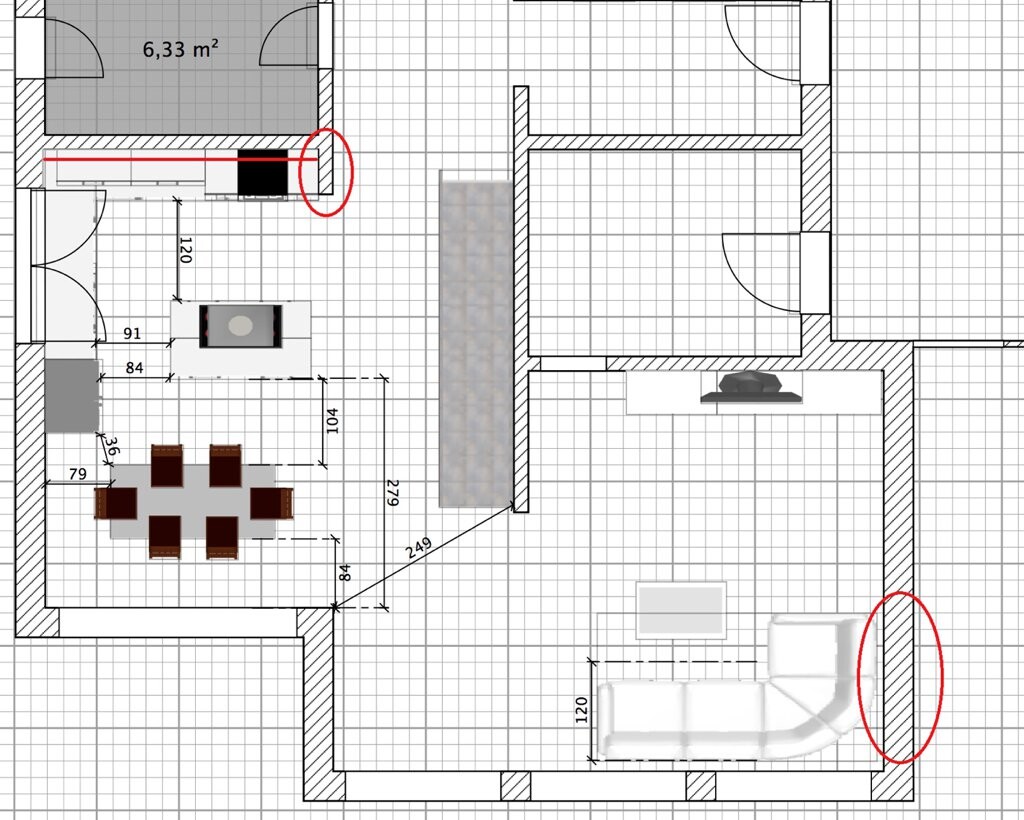

I’m very interested in this example because it’s very close to our kitchen (which is planned to be purchased on December 29).
It would be great to know the measurement from the end of the kitchen island to the wall behind the dining table—that is, how much space is available there?
I’d like to compare that with our room layout.
Good luck,
Jan
77.willo21 Dec 2017 22:54
It is exactly 320cm (126 inches). The distance between the table and the wall is 90cm (35 inches). Everything is very comfortable, but there should not be much less space.
steija1
22 Dec 2017 20:49
77.willo schrieb:
It is exactly 320cm (10 ft 6 in). The distance between the table and the wall is 90cm (35 inches). Everything is very comfortable, but there should not be much less space.
Thank you very much for the information. Although there isn’t much room for adjustment, we would appreciate opinions on our space layout.
Behind the dining table, there would be a glass front instead of a wall, but the current distance to the kitchen island is "only" 279cm (9 ft 2 in).
It shouldn’t be less than 120cm (47 inches) from the kitchen island to the opposite kitchen wall either.

On the contrary.
I would actually argue that there should not be more than 1.20 meters (4 feet) between the island and the row. Anything beyond that becomes ergonomically impractical and results in longer walking distances...
