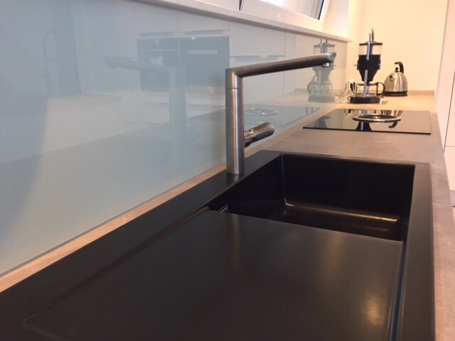

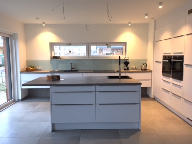

However, with glass, it should be considered that cutouts for electrical outlets cannot be easily integrated, or at least this significantly increases the cost.
It is possible to have outlets and so on with glass as well.
After one year, we are very satisfied. Our kitchen installer charged around 1,100 euros gross for installation, sealing, and outlet modifications; about 5.5 m (18 feet) linear, in three sections. Of course, it can be done cheaper online.
Modern kitchen with built-in sink, stainless steel faucet, and glass backsplash.
Modern kitchen with island, sink, and integrated appliances.
You should avoid using frosted glass because dirt behind it can show through; instead, use painted glass on the back side. Ours is painted white on the back, but it always appears somewhat grayish due to the gray color of the countertop.
