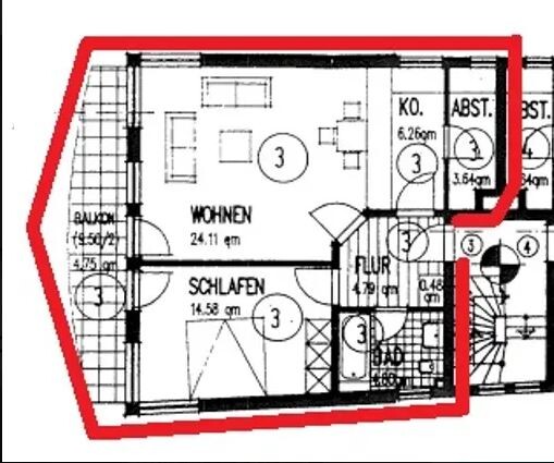

I had the idea to enclose the kitchen along the back wall of the unit using drywall, to move the door of the storage room to the lower part of the floor plan, and replace it with a sliding door, so that at least a small fold-down table can be attached to the wall, which can be folded away when not in use.
Do you think this idea could work, or does anyone have a better suggestion?

Oh, my software shows 3.35 x 1.80. According to my research, the dimensions are 3.6 m (12 ft) by 2 m (6.5 ft). Didn’t you take any measurements during the viewing? Where exactly are the water supply and wastewater connections? Washing machine and dryer in the storage room.
hanghaus202311 Jan 2023 11:22Sorry @ypg, it’s no longer possible to edit here. The question about measuring was directed to the OP. I used a double bed as a reference, which should be 2*2 meters (6.6*6.6 feet), and the base kitchen cabinets are 0.6 meters (2 feet) deep.

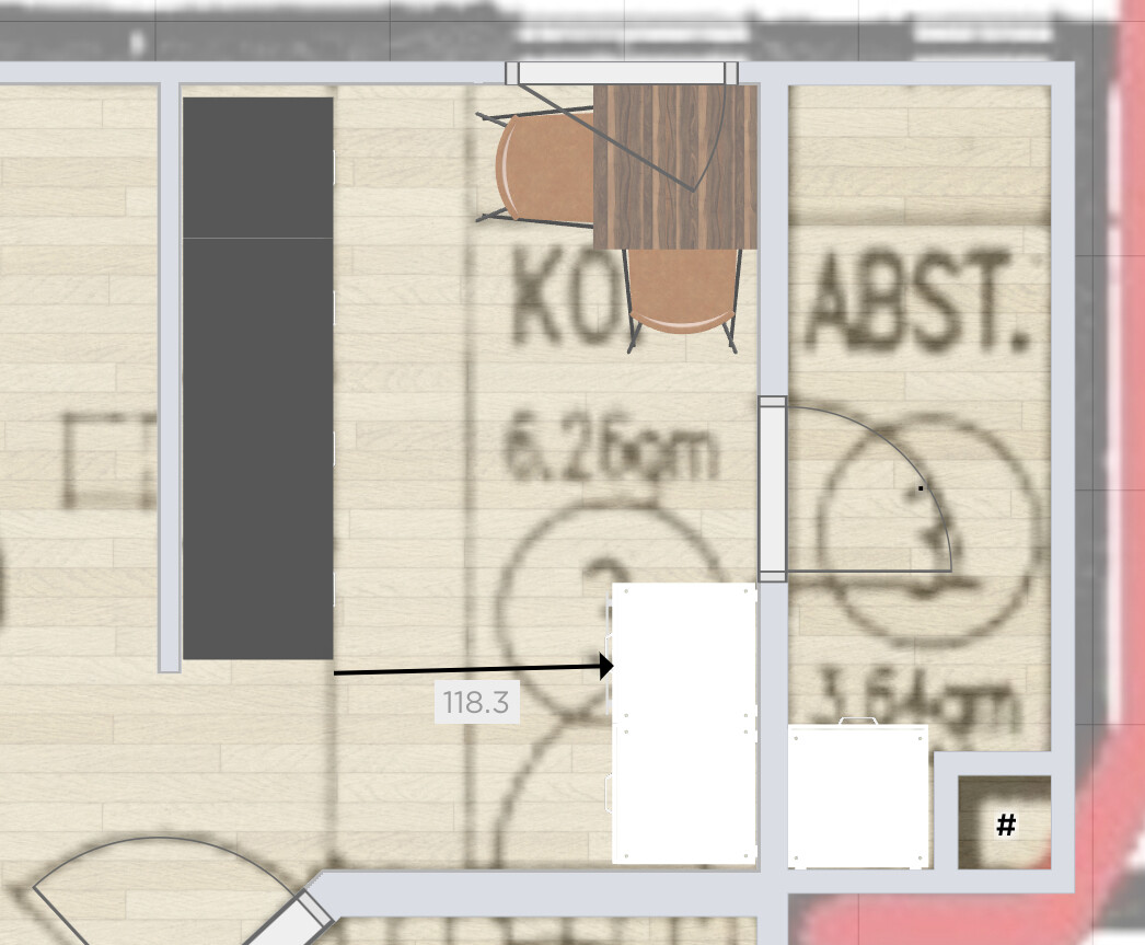

Here’s the suggestion according to mother-in-law’s wishes. I gave your suggestion a try:
You can clearly see that Twiggy would fit through, but Cindy would not. 180cm (5 ft 11 in) is not negotiable.

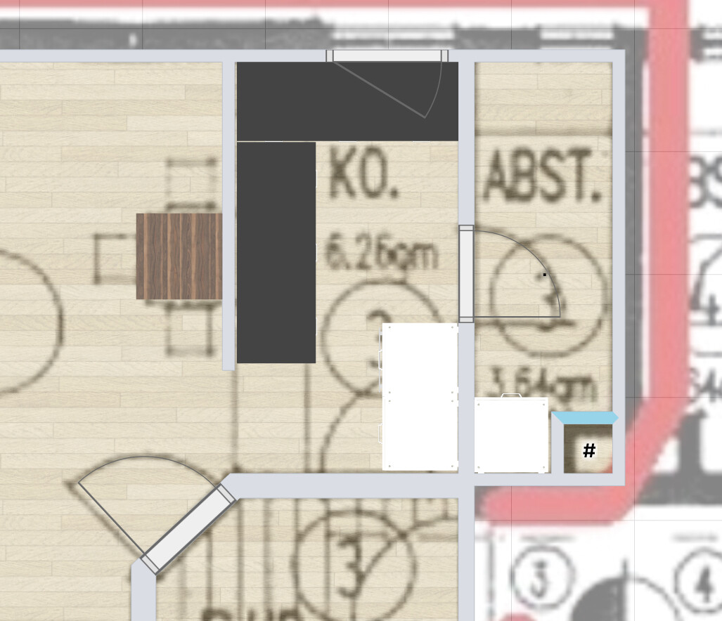

If we give the room more space, for example the 60cm (2 ft), it looks like this:
You can do that, but you don’t have to. I’m still wondering where the water connection could even be. It can only be at the back wall facing outside, which would require different furniture layout.
The problem with a drywall here is all the electrical/water installations. And a simple wall cabinet system (e.g. TBW) isn’t suitable for hanging cupboards either.
