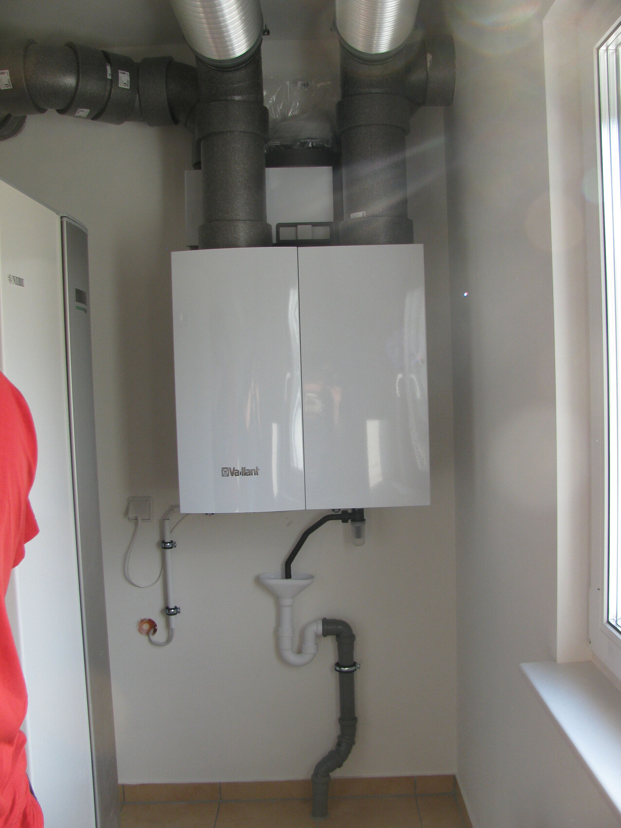

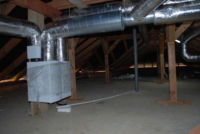

LittleWulf17 Apr 2015 22:45recoVair by Vaillant.
They seem to have only that one model. I found some information online under recoVair, but most of the time people mention other product names. On the manufacturer’s website, I only see that device and the technical data, of which I understand only about half. However, I can’t find any details about how it actually looks or is installed in a house anywhere :/
Well, it’s not just about the device—what kind of pipes and which valves? I think you should know that before making a purchase, right?
There are also different versions of the device... and the price difference can be as much as 1000 euros. So, which one will actually be installed?

LittleWulf18 Apr 2015 00:03According to the manufacturer's website, there is only one device. However, that seems strange to me. That can’t be correct, can it?
