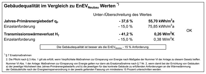

I have already mentioned several times here that a 36.5cm (14.4 inches) masonry wall (aerated concrete) with suitable technology inside the house very comfortably achieves a KfW 70 efficiency house => attachment
