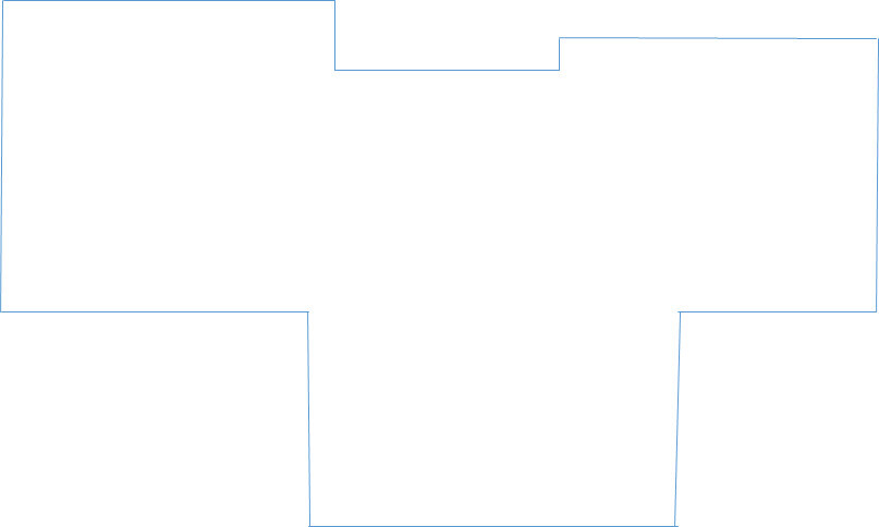

Is it due to the lower surface-to-volume ratio of a bungalow? That definitely makes a big difference, yes. However, our floor plan also complicates things.
The ideal solution is, of course, a north/south orientation. We only have southeast/northwest, though.
