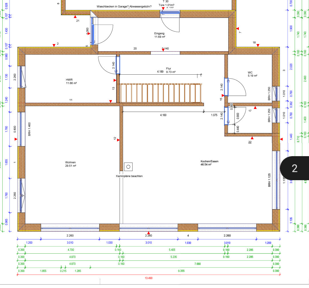

We are currently planning to install a 10 kW wood stove in our open living, cooking, and dining area. It is intended solely to create a cozy atmosphere and will be lit in the evenings only; there is no water heat exchanger. My question is whether this capacity is oversized or appropriate? The area is about 80 m² (860 sq ft), see attached photos of the floor plan and excerpts from the stove manufacturer. Thanks in advance for your answers.

nordanney22 Dec 2024 15:02No, it’s not too large. But please avoid installing heat-retaining bricks anywhere. The heat will just be blown straight out through the chimney.
We also had a similarly large fireplace (but as a tunnel fireplace) in our previous house a few years ago (built to KfW 55 standard). It was an open living/dining area of about 75m² (800 sq ft).
Yes, the room did get warmer. But not uncomfortably so.

Oberhäslich23 Dec 2024 21:48We have a KfW55 standard, an open living-dining-hall area of around 65sqm (700 sq ft), also with a vaulted ceiling, and I have to say our 4kW Olsberg stove is more than enough. We easily reach 25 degrees Celsius (77°F) with regular use. I think 10kW would be oversized if you have underfloor heating like we do.
