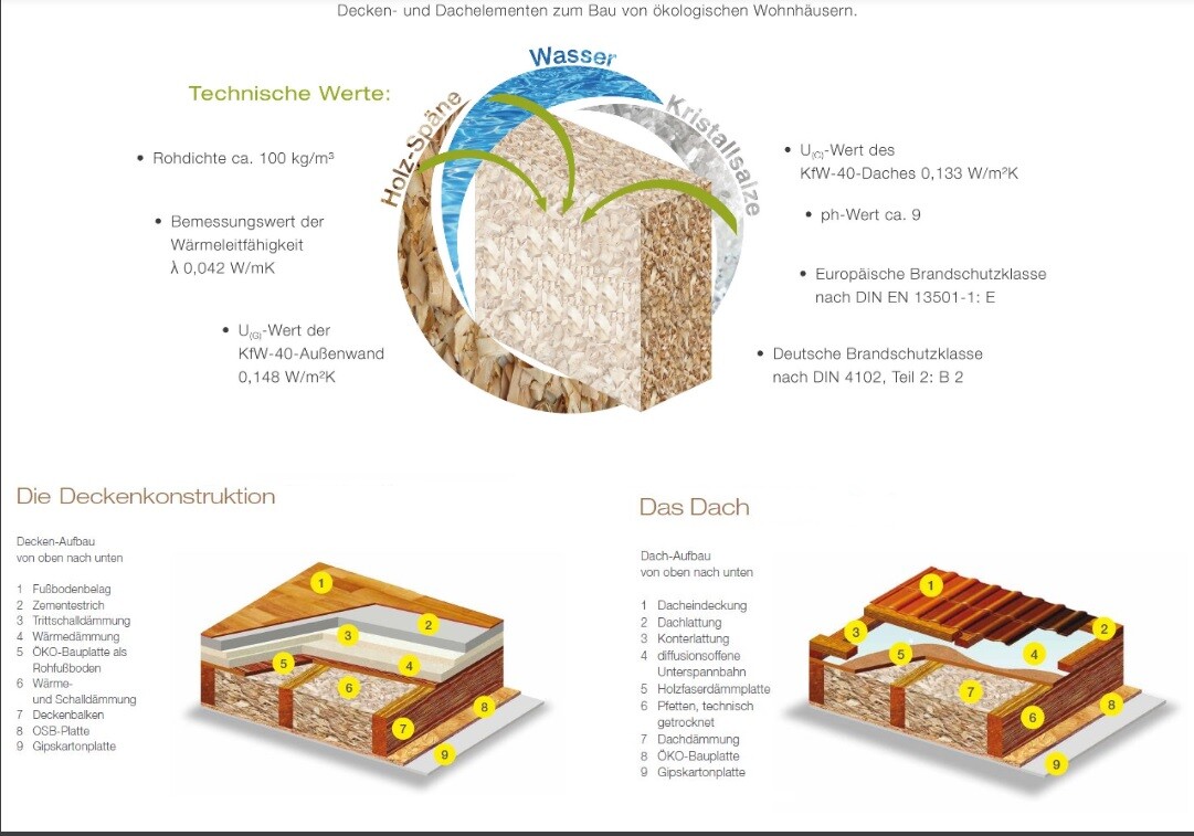

Thanks again, boxandroof! Of course, an air-to-water heat pump (those abbreviations can be confusing sometimes).
This is a standard “shoebox” house, nothing special.
I used the Crinks tool and entered the data from the offer, as well as the advertised U-value (0.148) from the manufacturer of the single-family house (the roof is a bit better at 0.133).
Key data:
Standard outdoor temperature -12°C (10°F)
H'T: (heat transfer coefficient) 0.148 W/(m²·K)
Desired average indoor temperature: 22 degrees
A: (building envelope surface area) 300 m² (3,229 ft²)
Ve: (heated gross volume) 440 m³ (15,535 ft³)
Maximum number of occupants: 4 persons
The values are quite interesting and significantly lower.
Central mechanical ventilation with heat recovery
Transmission load: 1510 W
+ Ventilation load: 193 W
+ Domestic hot water load: 400 W
= Total heating load: 2103 W
Decentralized mechanical ventilation with heat recovery
+ Ventilation load: 483 W
= Total heating load: 2393 W
Window ventilation or mechanical ventilation without heat recovery
+ Ventilation load: 966 W
= Total heating load: 2876 W
I think that with these values, a geothermal heat pump would be too expensive.

querys_ schrieb:
H'T: (overall heat transfer coefficient) 0.148 W/(m²·K) What kind of house is that supposed to be? I find that very unrealistic.
