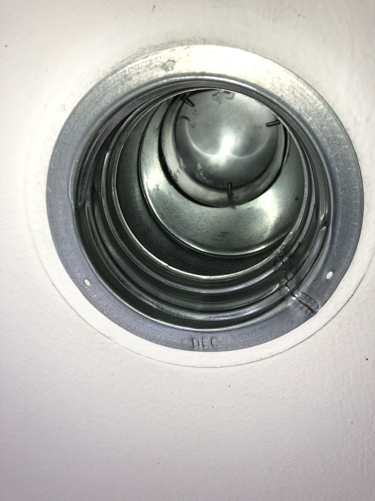

You can't do anything about planning errors or poorly constructed systems.
Supply air vent in the living room. System is almost 10 years old. No additional cleaning. Only the necessary filter replacement and a heat exchanger cleaning every three years.
P.S. Decentralized is better than nothing, but in the end they are noticeably loud.
