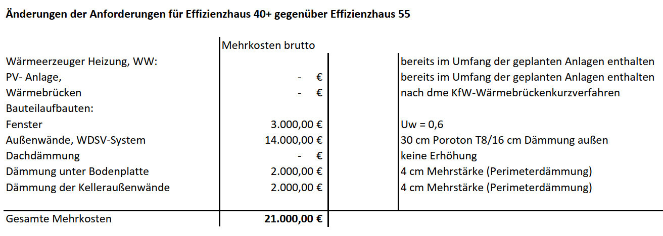

For completeness, here is the architect’s calculation:
Table: Additional costs and insulation for Efficiency House 40+ compared to 55.

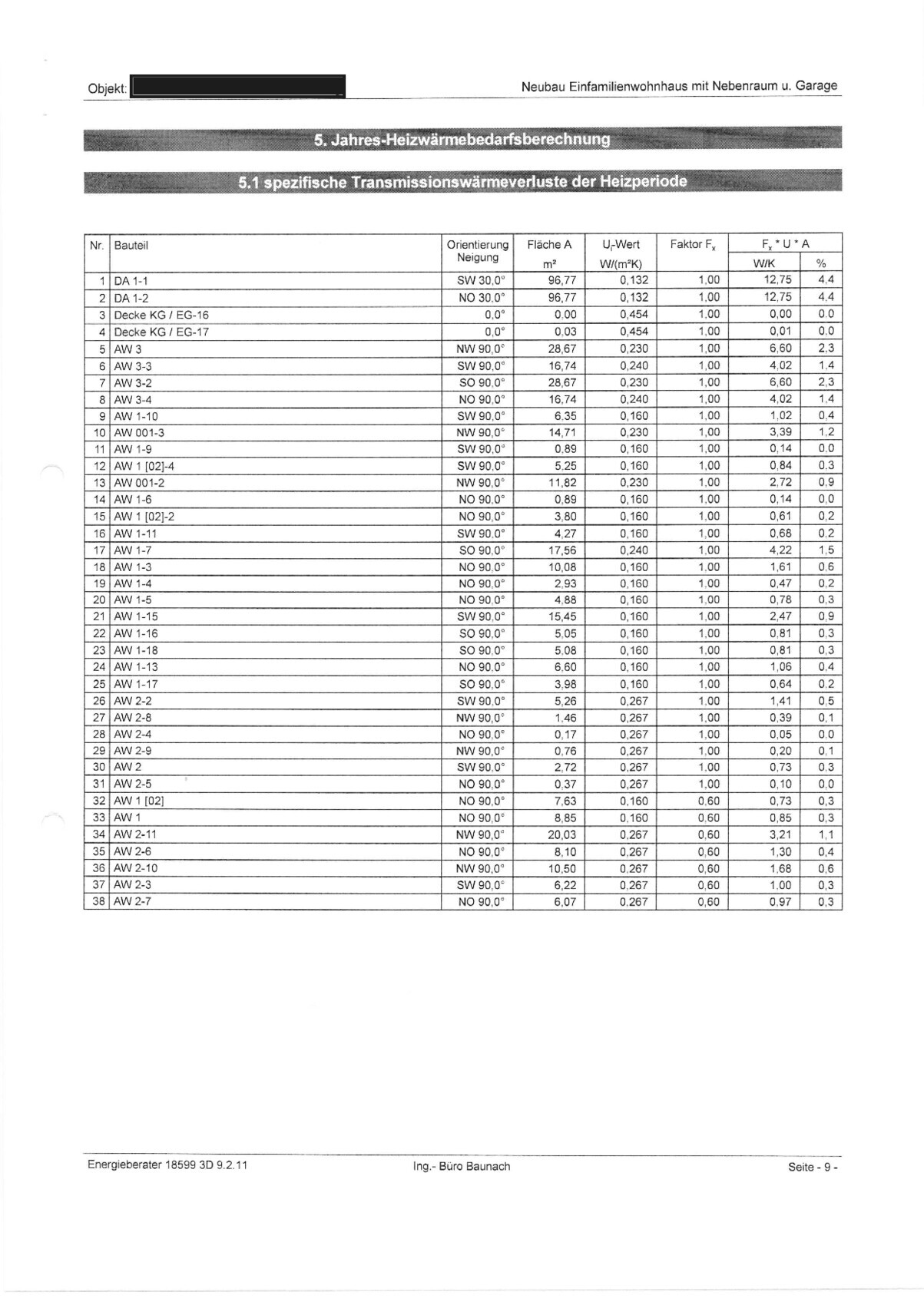

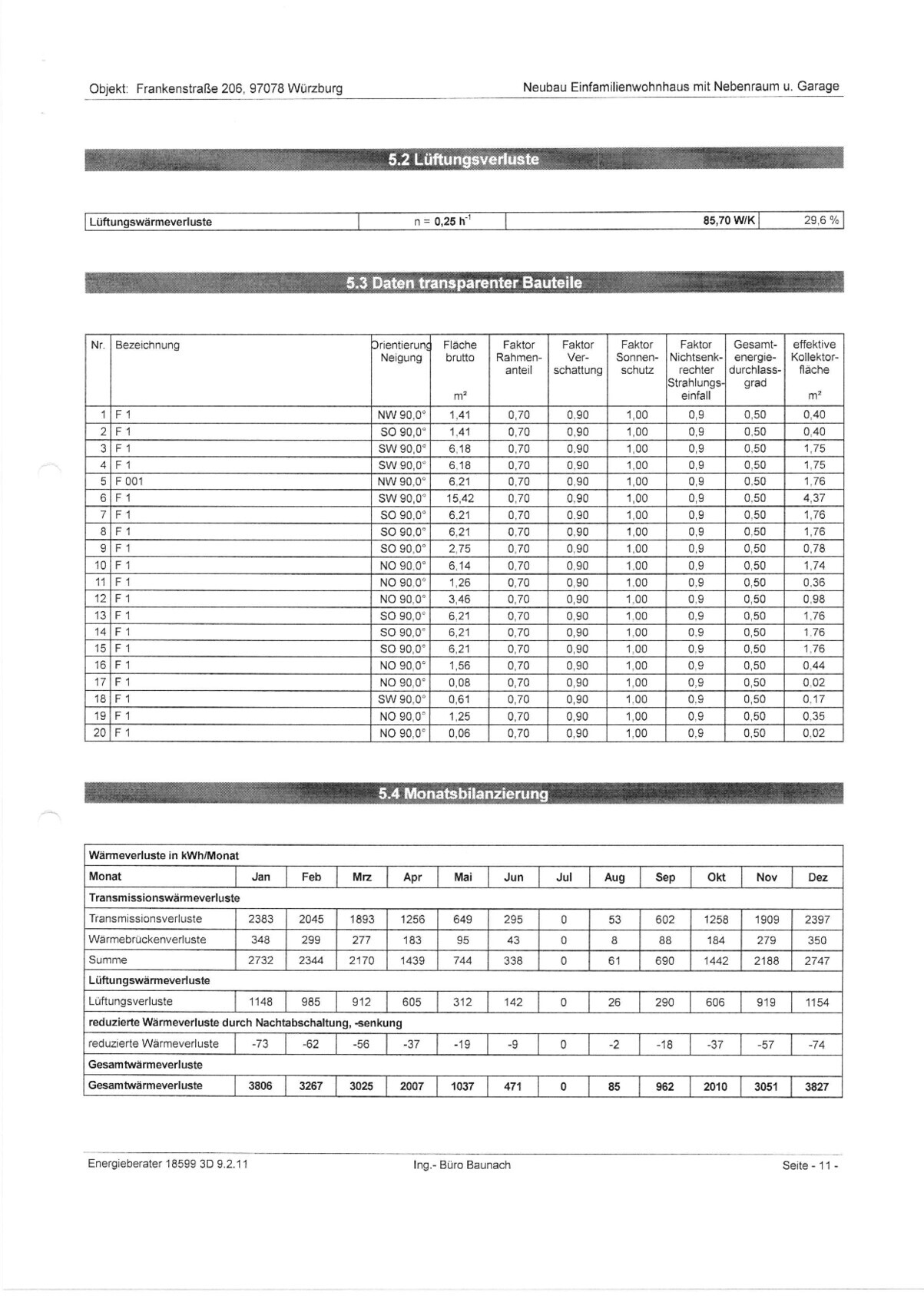

Thank you very much for the suggestion. Attached is an excerpt from the preliminary report on insulation values; I hope you can make sense of it, because as a layperson, I don’t really understand it well.
I will forward these suggestions to my architect.
Page of the heating demand calculation with component table and U-values.
Page with table on specific transmission heat losses (U-value) and a chart.
Technical document: tables on ventilation losses, component data, and monthly balance.

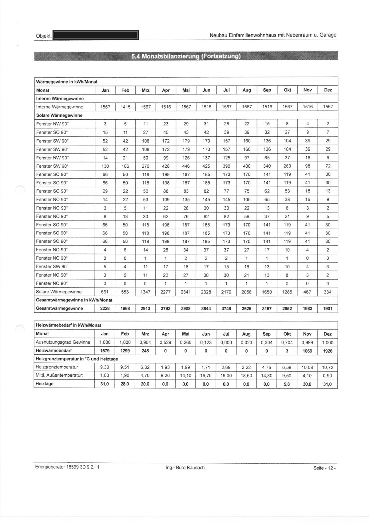

Monthly balance: tables with heat gains, heating demand, and monthly values.
Monthly balance of a new single-family house: monthly heating energy and heat losses (kWh).

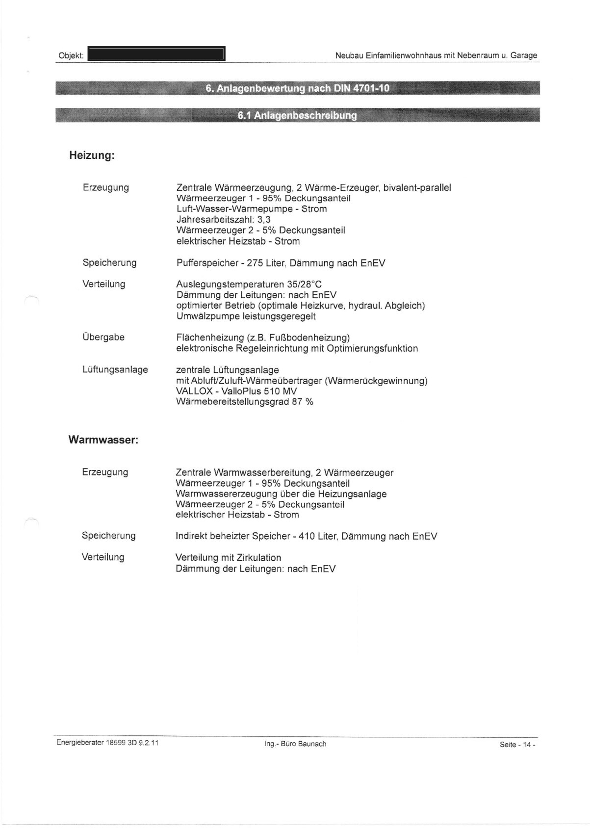

Technical document according to DIN 4701-10: system description of heating and hot water in the new building.
