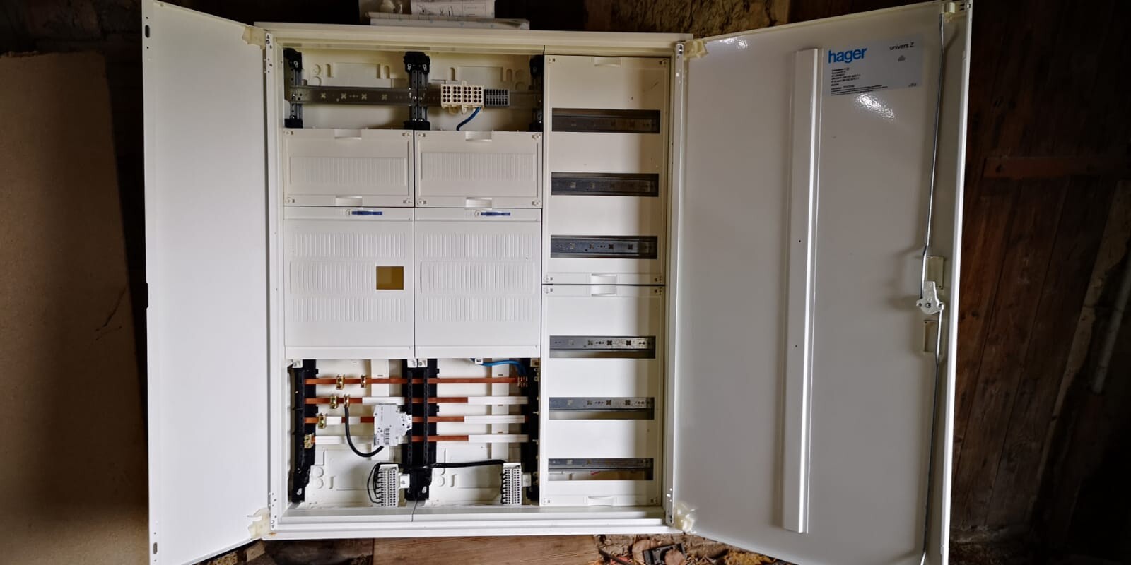

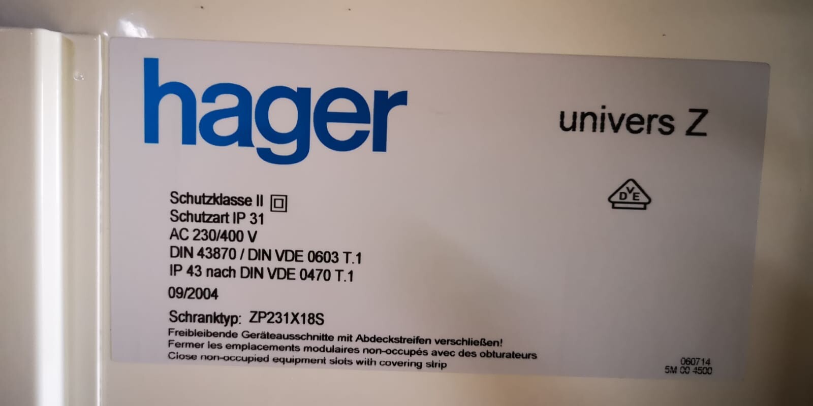

I have had this new meter cabinet for a very long time. However, I am concerned that it might no longer be allowed for installation. Can someone provide a clear answer on this?
Hager label with model ZP231X18S, protection class II, IP43, 230/400 V, DIN VDE 0603/T.1.
Open distribution cabinet with fuse modules, busbars, and cables (brand Hager).
Knöpfchen25 Feb 2020 07:35
As far as correct, many things can be modified.
The busbar system can be upgraded to 5-pole.
The distribution spring can be converted to accommodate an APZ.
EHz is not required everywhere.
However, the connection field above the meter is only 150 mm (6 inches); according to the TAB, 300 mm (12 inches) is required. Therefore, the cabinet must have a minimum height of 1100 mm (43 inches) overall, and this cannot be changed.
Mycraft25 Feb 2020 12:36
Well, you can still use the cabinet as a sub-distribution board without a meter panel.
