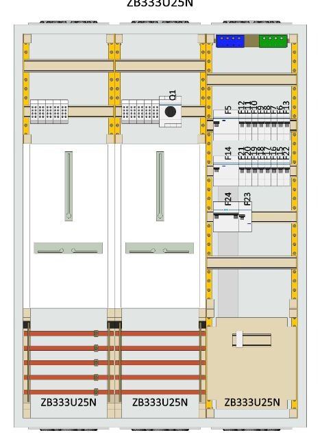

Wilhelm202213 Feb 2022 20:31R
RotorMotor13 Feb 2022 21:20Hmm, it looks quite standard at first glance, but why are there two meter slots? And what other capacities are included?

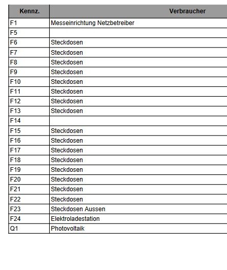

Wilhelm202213 Feb 2022 22:02Hello,
could it be related to the photovoltaic system? It basically measures how much energy is consumed and how much is fed back into the grid.
These services are included:
Including installation and cable extension from the old meter.
Meter work included.
Connecting and wiring of circuits,
Testing according to VDE standards including documentation,
Sealing the system,
Inspection including
Testing of the building-side electrical installation,
Issuing the inspection report.
