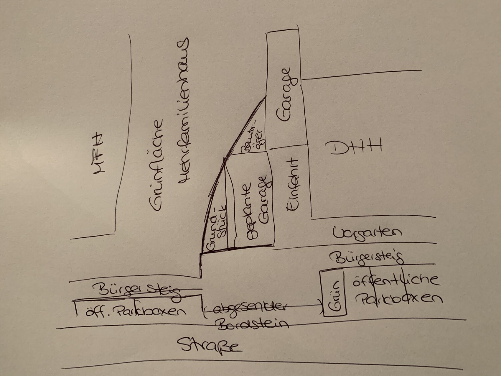

Yes, there is a development plan. However, it does not include a garage on the property. I am not aware of any parking space regulations.
It is supposed to be a standard prefabricated garage, just like ours. 6 meters long and 3 meters wide and high (approximately 20 feet long and 10 feet wide and high).
The garage would also border directly on the neighboring property.
My sketch was not detailed enough, apologies. I have now attached a more detailed sketch.
Thank you all for the information so far!
Regarding the purchase... we have actually been trying to buy the small plot for several years, but the developer is absolutely unwilling to sell it.
Ena1609
