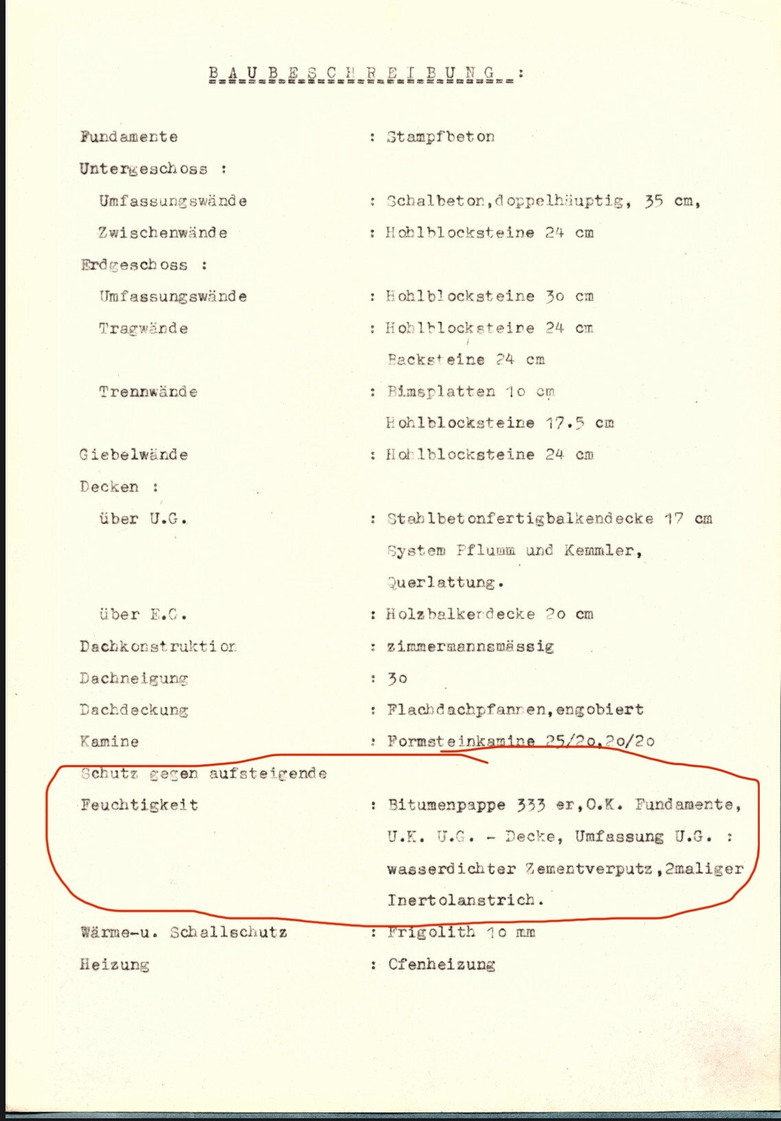

This is what I found regarding waterproofing. What do you think?
Technical building description with moisture protection: bitumen felt and waterproof cement plaster.
Buchsbaum066
11 Nov 2024 20:27
Theoretically, it looks good, of course. Your basement walls were surely properly waterproofed on the outside as well.
However, you had to redo it because it simply doesn't last 60 years.
The same will apply to the inside. If it is going to be a living basement, I would also expose the foundations about 20 cm (8 inches).
Otherwise, there could be an unpleasant surprise in the end.
Of course, everything may still be fine. We just don’t know.
You could also measure the moisture in the wall above the waterproofing layer. That will provide a clear indication of the actual condition.
